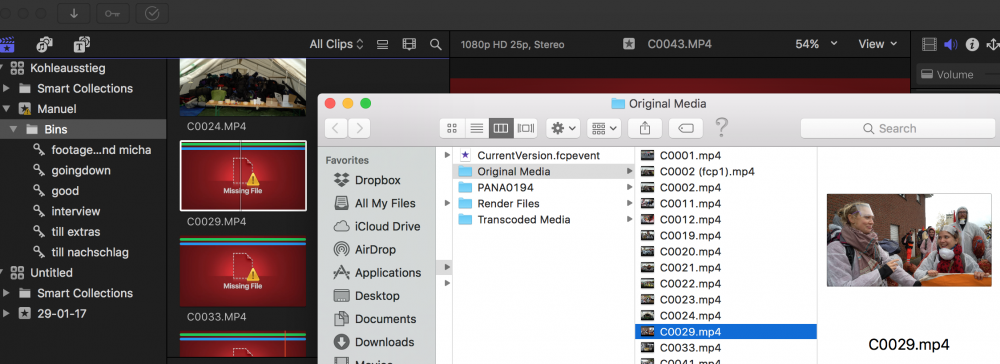

So I had to edit a project in Premiere Pro CC, which I then exported as FCP XML, converted with SendToX, and imported in FCPX without any problem. I was aware that I would have to relink all media files from the project, so I plugged in the drive containing them, selected the folder through relink files dialogue, and it matched all missing files. However, despite finding all matches, it won't relink the files (with the exception of two or three clips, weirdly). I then consolidated all media files to the new library location on another hard drive, and FCPX started copying them all over. When I click "reveal in finder", it actually locates the media files, which are clearly there and correct (on the flash drive prior to consolidation and on the hard drive after consolidation). I'm at a bit at a loss, anyone have an idea what else I could try? Thanks!

Deleted the event, imported again through SendToX with flash drive inserted, files were found during import but still missing, went to relink files dialogue and they were supposed to be in all kinds of weird locations, but it did manage to import all missing files from the flash drive this time (though I didn't do anything differently from before). So my problem seems solved, but this doesn't seem overly reliable...
