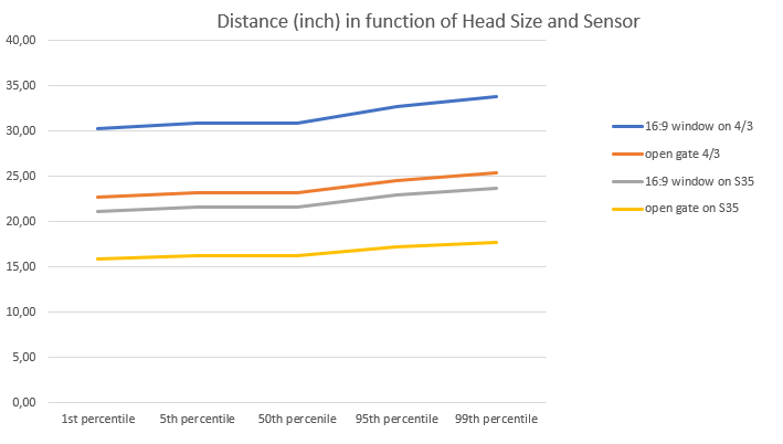

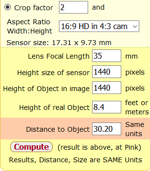

seku Posted December 11, 2017 Share Posted December 11, 2017 I had some calculation fun, with @Don Kotlos's excellent male head height figures... Taking into account @Neumann Films picture of the crazy color graded guy from chin to upper forehead ... while knowing that it was filmed 30" away This is what some easy calculations came up with (don't worry bout feet or meter, i just used inches in the calculation): Link to the Calculator Which ... if our guy has an average head ... then this was filmed on a Micro 4/3 sensor, cropped to 16:9 Even if our guy has a BIG BIIIIG head (99th percentile), and even slightly cropped, he barely makes it into open gate 4/3 territory : So i would really rule out any sensor larger than that.... S35 seems completely improbable. Just in case, the calculation for S35 in 16:9 cropped to 4:3(best case scenario) with largest head : Even with Mr. Bighead, we are getting further away from the 30" @Neumann Films mentioned. I'll stick with the 4/3 rumor PannySVHS 1 Link to comment Share on other sites More sharing options...

Don Kotlos Posted December 11, 2017 Share Posted December 11, 2017 48 minutes ago, seku said: Which ... if this is all true... then this was filmed on a Micro 4/3 sensor, cropped to 16:9 Even if our guy has a BIG BIIIIG head (99th percentile), and even slightly cropped, he barely makes it into open gate 4/3 territory : The discrepancy most probably comes from the fact that the calculator gives you the distance from the edge of the lens whereas the distances on the lens itself are measured from the sensor. And that was a long lens In my calculations in the previous page from the horizontal field of view , again I see the same thing -> m4/3 sensor. seku and Cas1 2 Link to comment Share on other sites More sharing options...

seku Posted December 11, 2017 Share Posted December 11, 2017 @Don Kotlos : i didn't take into account the lens factor. But just for fun, a short recap of distance vs head size (seems i am really bored tonight) : if nothing else, this should remind us that open gate 4/3 anamorphic gets us damn close to 16:9 S35 in vertical field of view... Link to comment Share on other sites More sharing options...

slonick81 Posted December 11, 2017 Share Posted December 11, 2017 I did some math, too. 30"~75cm, man's head ~25cm. vertical angle of view (as it's not affected by anamorphics) =2*arctan((25/2)/75)=2*arctan(0.1(6))~=2*9.5=19 degrees According to several online fov calculators it is about full height of 4/3 sensor for 35mm lens, a bit shorter maybe. All APS-C/S35 flavours are 25+ degrees. Edit: ah, easier, there is relation between lengths: head/distance=sensor_height/focal_length -> sensor_height=head*focal_length/distance=25*3.5/75~=1,2cm=12mm Link to comment Share on other sites More sharing options...
