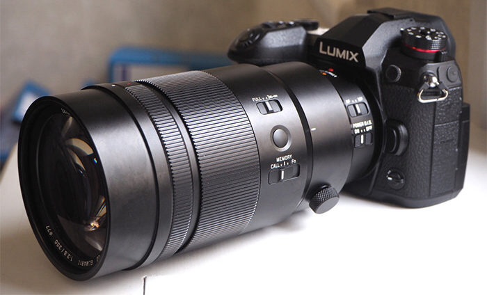

Juxx989 Posted December 15, 2017 Share Posted December 15, 2017 https://www.43rumors.com/new-image-samples-shot-leica-200mm-f-2-8-lens-without-1-4-tc/#disqus_thread what camera is that? Link to comment Share on other sites More sharing options...
Don Kotlos Posted December 15, 2017 Share Posted December 15, 2017 16 minutes ago, Juxx989 said: what camera is that? G9 Link to comment Share on other sites More sharing options...
