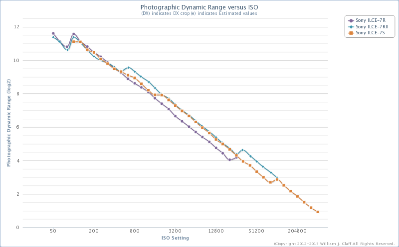

Don Kotlos Posted December 17, 2017 Share Posted December 17, 2017 There are ways to change the ADC in order to improve the performance at higher ISOs. I highly recommend reading this pdf: http://www.photonstophotos.net/Aptina/DR-Pix_WhitePaper.pdf There is also a very informative thesis by Xiangli Li if you want to go in even more depth: http://cmosedu.com/jbaker/students/theses/MOSFET Modulated Dual Conversion Gain CMOS Image Sensors.pdf For example, A7rII uses this patented dual conversion gain http://www.freepatentsonline.com/y2017/0148832.html to get a tiny bit better dynamic range at higher ISOs: Link to comment Share on other sites More sharing options...
webrunner5 Posted December 17, 2017 Share Posted December 17, 2017 19 minutes ago, Don Kotlos said: There are ways to change the ADC in order to improve the performance at higher ISOs. I highly recommend reading this pdf: http://www.photonstophotos.net/Aptina/DR-Pix_WhitePaper.pdf There is also a very informative thesis by Xiangli Li if you want to go in even more depth: http://cmosedu.com/jbaker/students/theses/MOSFET Modulated Dual Conversion Gain CMOS Image Sensors.pdf For example, A7rII uses this patented dual conversion gain http://www.freepatentsonline.com/y2017/0148832.html to get a tiny bit better dynamic range at higher ISOs: "The Varicam 35 has a unique feature that sets it apart from most cameras. The ability to have two native ISO settings. How can a camera have two base ISO ratings you ask? Basically there are two analog circuits right after each pixel before the gain amp, one each dedicated to 800 and 5000 ISO. This allows for two “native”, very clean settings. In one mode it has a native ISO of 800 and when you switch to another setting the camera clicks over to its other native ISO of 5000. This keeps the signal to noise ratio the same and allows for you to shoot remarkable clean images in low light conditions. The noise present at 5000 ISO is nearly identical to that at 800. It’s coming directly from the sensor, so it’s not simply a case of boosting the gain and erasing the noise. One of the reasons Panasonic has done this is to allow for high frame rate capture in lower ambient light." "It’s coming directly from the sensor, so it’s not simply a case of boosting the gain and erasing the noise." That statement separates it from what Sony is doing by using their ADC for a dual conversion gain . I can only gather that the sensor in a Varicam 35, and the mini has dual pixels from what I have read sort of like Canon does, but uses them for the Dual ISO instead of DPAF like Canon does. So in reality Panasonic has two senors instead of the normal one. So each one is just for a different Native ISO. Link to comment Share on other sites More sharing options...
Don Kotlos Posted December 17, 2017 Share Posted December 17, 2017 8 minutes ago, webrunner5 said: I can only gather that the sensor in a Varicam 35, and the mini has dual pixels from what I have read sort of like Canon does, but uses them for the Dual ISO instead of DPAF like Canon does. No they just change the analog circuit at different ISOs just like Sony and the aptina sensors instead of just applying a gain. Link to comment Share on other sites More sharing options...
webrunner5 Posted December 17, 2017 Share Posted December 17, 2017 11 minutes ago, Don Kotlos said: No they just change the analog circuit at different ISOs just like Sony and the aptina sensors instead of just applying a gain. "The VariCam LT has two native ISO settings: 800 and 5000. This means the VariCam LT achieves very high sensitivity while maintaining a low noise level at 5000 ISO. The noise level at 5000 ISO is nearly identical to that seen at 800 ISO. In order to achieve this function two dedicated analog circuits are implemented on every pixel of the imager of the VariCam LT for each native ISO before gain processing. This allows the camera to achieve much higher sensitivity without increased noise. Normally noise is introduced in the gain process of rating ISO in digital cameras. This functionality is revolutionary for low light scene shooting. Especially this ISO 5000 enables the camera to capture with very low available light maintaining a realistic mood." Quote from Panasonic. That is in no way what Sony Does. Well maybe it does LoL. Basically the BSI usage as Sony calls it, is in essence dual pixels also. http://image-sensors-world.blogspot.com/2017/06/sony-dual-conversion-gain-pixel-layout.html This persons comment at the bottom sort of explains the path they use to pull it off. "Not exactly, in Aptina's, the RST is directly connected to the FD while here, the RST is connected to the junction behind DCG. It means you have to open DCG to fully reset your FD." Clear as mud LoL. Link to comment Share on other sites More sharing options...
Don Kotlos Posted December 17, 2017 Share Posted December 17, 2017 12 minutes ago, webrunner5 said: That is in no way what Sony Does. They literally say that they use different analog circuits on every pixel. Not the same circuit or sensor but same method as Sony, same method as Aptina. Definitely not what you are claiming: 28 minutes ago, webrunner5 said: I can only gather that the sensor in a Varicam 35, and the mini has dual pixels from what I have read sort of like Canon does, but uses them for the Dual ISO instead of DPAF like Canon does. So in reality Panasonic has two senors instead of the normal one. So each one is just for a different Native ISO. 2 1 So I am not sure why you disagree. If you want to learn a bit more about this you can read the documents that I attached my original reply. Link to comment Share on other sites More sharing options...
webrunner5 Posted December 17, 2017 Share Posted December 17, 2017 It is not the same sensor for the Sony or the Panasonic. That write up is OLD tech. Both company's would have been sued long time ago. They have modified it, and Panasonic has Never claimed more DR like Sony has. Sony has No sensor that has true dual native ISO's. Link to comment Share on other sites More sharing options...
