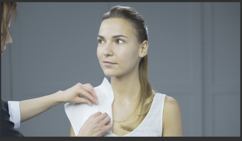

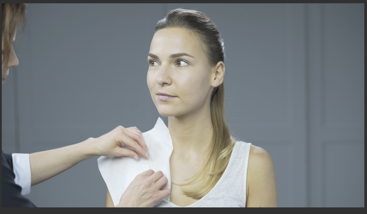

I have run into some trouble and I need advice from you people Sony A7s owners or not. My problem is that I find the images that come out of my camera far too Green/Yellow which is so far from the skin tones I want. The screenshots are from a project one with a CINE 4 - S Gamut LUT and the other straight from the rushes.
The Picture Profile that I had used is
PP6 -
GAMMA = CINE 4, +10 Black Level
Color MOde = S-Gamut3.Cine , +5 Saturian
Color Depth all left to 0 but yellow set to -3 and green set to -3
I was hoping to remove that ugly tone that way but i didnt turn out that way
I'd like to know what is the preferred picture profiles that you guys use for what kind of situation.
thank you

Increase red color depth to +5, and leave yellow color depth at 0.
Move the temperature to something warmer with a slight tint shift to magenta.
Don't use any premade non-rec709 LUTs unless you match exactly all their settings. Personally I wouldn't use them at all if you want a straight out of the camera look.
If you still feel that colors are not to your liking, try pro color or cinema color modes.
The colour depth seems to change only the lightness of the colour (luma value) and not it's hue.
A better way to fight green or magenta casts, in my opinion, is a correct white balance and some tweaking on the white balance shift.
In the profile setting, the colour phase seems to help as well. positive numbers ( 1 to 7 ) go towards magenta and negative towards green.
Another suggestion is to change your colour mode to some of the other options. S.gamut 3 has a tendency of green casts if not altered to a correct colour space.
First off, always always always use an 18% grey card to get your white balance perfect. I've found this is by far the biggest thing you can do to help your colour. I started doing that, even for my travel shorts, earlier last year and the difference is night and day.
Secondly, give Geoff's GFILM a go. It is by far and away the best SLOG2 profile I've seen for Sony cameras. If you want a straight out of the camera look with no grading, EOSHD is the way to go.
(p.s custom white balance erroring out with an all green screen? You'll have to switch your PP setting to OFF, do the custom white balance, and then switch back to SLOG2. It sucks, but takes an extra 10 seconds if you have your PP button set to a custom button)
