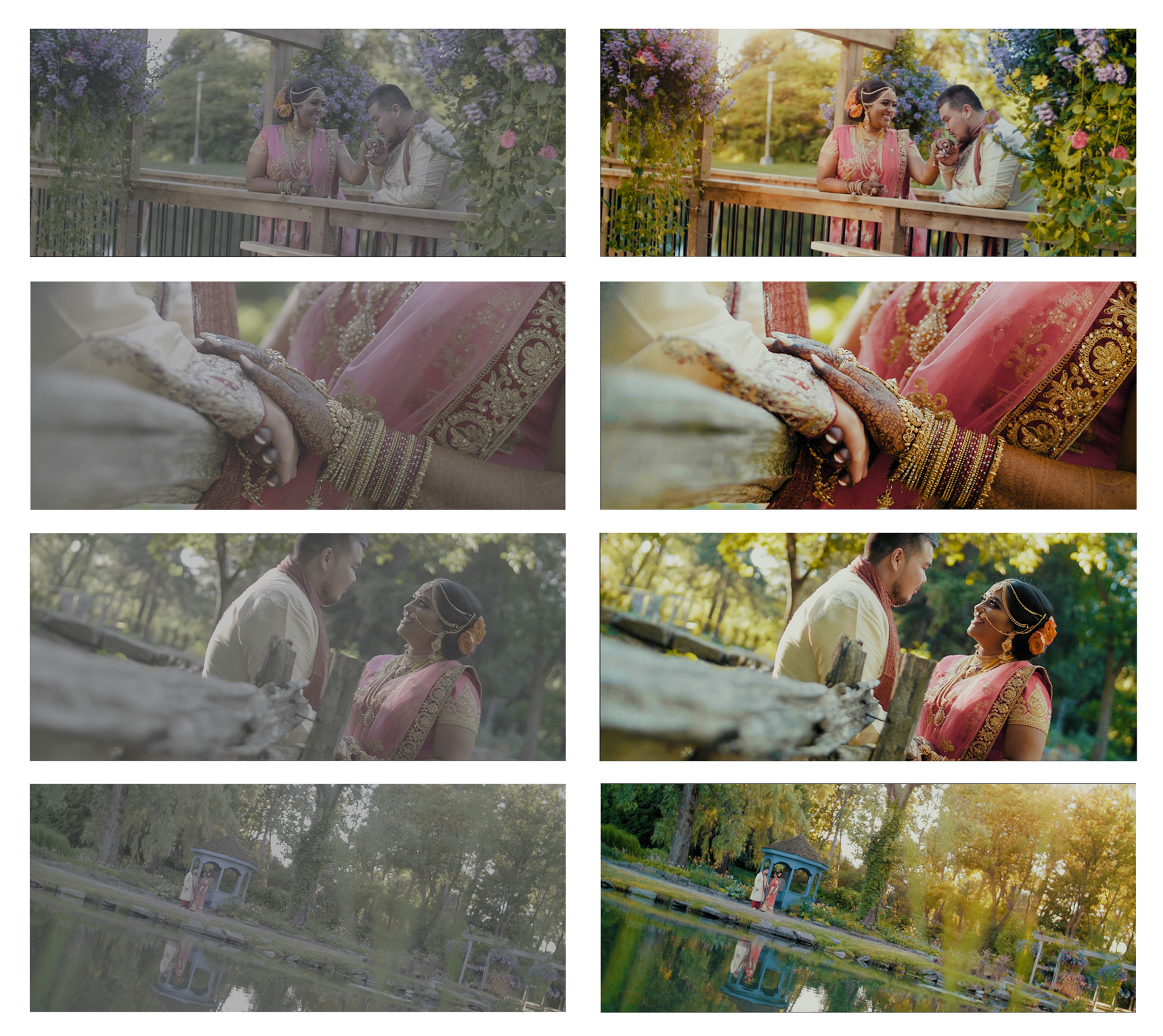

Sage Posted August 1, 2018 Author Share Posted August 1, 2018 22 hours ago, tihon84 said: Thank you! Wow, Davids and your VLOG footage look so good without grading... I think something wrong with my exposure... I wish to know how he set exposure and wb for this shot. I asked him. For me, nothing fancy. I shot the entirety of the outdoor shots in Always Already with the sunny preset, no post correction or color grade. For exposure, I generally aimed for a little brighter than I have in the past, just by eye, but not ettr (i.e. not placing just at clipping). Its ideal not to place significant image areas in the rolloff (65-75), or to significantly underexpose. The vlt preview gives a good idea of the resulting image (eye viewfinder gives accurate contrast) *His response: I always custom white balance using my x-rite colorchecker. I exposed it so it was not clipping (except the sun). The new luma placements of EC is quite right to judge exposure by eyeballing the V-Log Assist 1D LUT. Othwewise, i would have ETTR it and used my luminosty mode layer to drop down exposure while keeping the noise level to a minimum. *I think he might be referring to another sun shot he sent me, but it covers the bases Link to comment Share on other sites More sharing options...
tihon84 Posted August 1, 2018 Share Posted August 1, 2018 2 hours ago, Sage said: I asked him. For me, nothing fancy. I shot the entirety of the outdoor shots in Always Already with the sunny preset, no post correction or color grade. For exposure, I generally aimed for a little brighter than I have in the past, just by eye, but not ettr (i.e. not placing just at clipping). Its ideal not to place significant image areas in the rolloff (65-75), or to significantly underexpose. The vlt preview gives a good idea of the resulting image (eye viewfinder gives accurate contrast) *His response: I always custom white balance using my x-rite colorchecker. I exposed it so it was not clipping (except the sun). The new luma placements of EC is quite right to judge exposure by eyeballing the V-Log Assist 1D LUT. Othwewise, i would have ETTR it and used my luminosty mode layer to drop down exposure while keeping the noise level to a minimum. *I think he might be referring to another sun shot he sent me, but it covers the bases Thank you so much! Sage 1 Link to comment Share on other sites More sharing options...

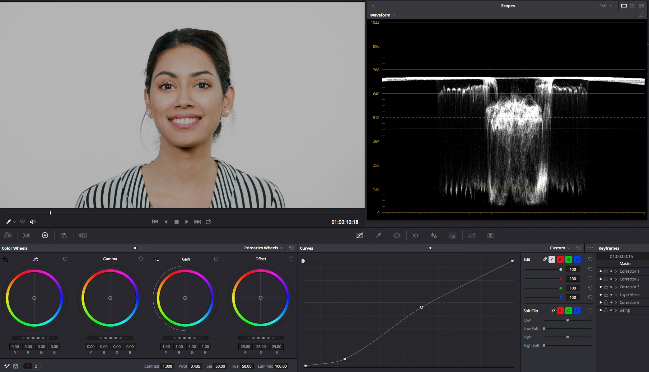

Sage Posted August 6, 2018 Author Share Posted August 6, 2018 For VLog exposure, you'll want zebras at 80% (clipping), and I have the other at 50%. Above 65% is the rolloff, meant for over-bright highlights I'll be taking a look at the .vlt situation at home, perhaps there is a setting or something else at work here Link to comment Share on other sites More sharing options...
Maverick530 Posted August 6, 2018 Share Posted August 6, 2018 3 minutes ago, Sage said: For VLog exposure, you'll want zebras at 80% (clipping), and I have the other at 50%. Above 65% Ah, I was thinking V-log did the corrections once taken out of Cine-D or Standard mode, I'll double check mine then. But 50% is skin tones still eh? Link to comment Share on other sites More sharing options...
Sage Posted August 6, 2018 Author Share Posted August 6, 2018 57 minutes ago, Maverick530 said: Ah, I was thinking V-log did the corrections once taken out of Cine-D or Standard mode, I'll double check mine then. But 50% is skin tones still eh? That's where I set Zebra 2, but there is a degree of flexibility to it. As long as skintone is between 40-65, you'll get a rich exposure in that zone Regarding Luma placement (tying in to exposure), I wrote in an email earlier today: "Yes, the nature of the conversion is professionally oriented, to treat all usable DR equally (hence the lower contrast). An artificial black level limit is not placed on the footage to give an impression of immediate added 'pop', and is rather left to the colorist. Luma placement is the simplest operation, whereas the intricate color interactions are taken care of. I may add an 'Auto' variation in the future in addition to Main/Soft/Pop, so that not even Luma placement is required (!) (at the cost of flexibility)." EC/V35 Flipbook (Gradient banding from .gif): Link to comment Share on other sites More sharing options...
