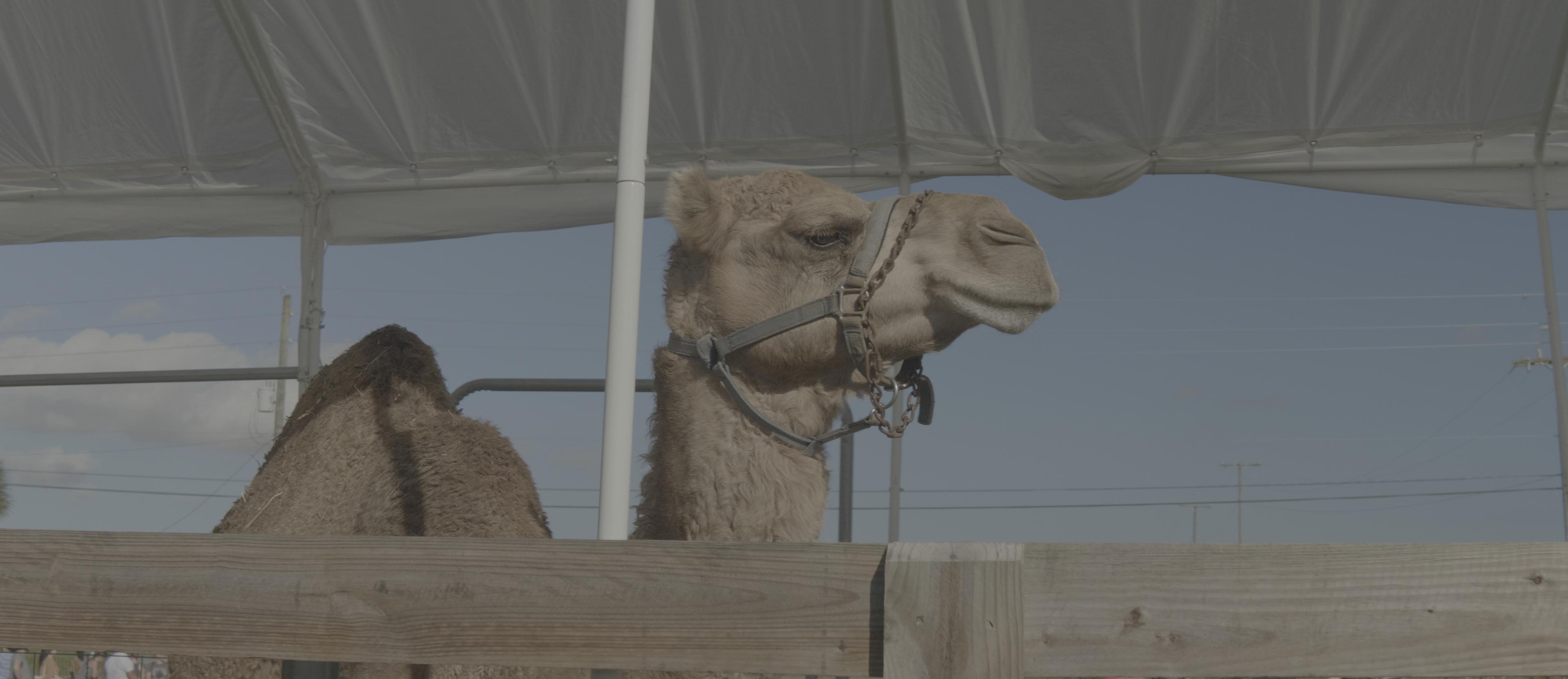

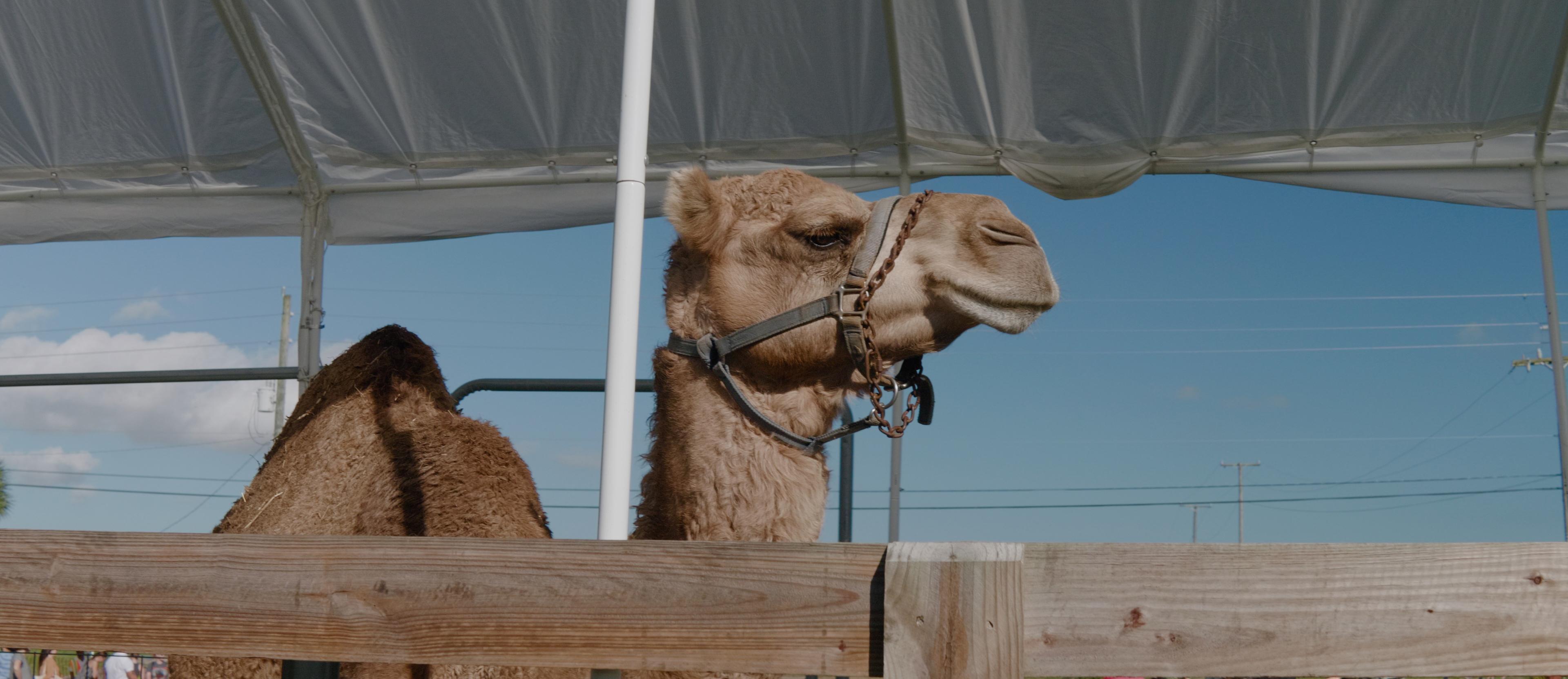

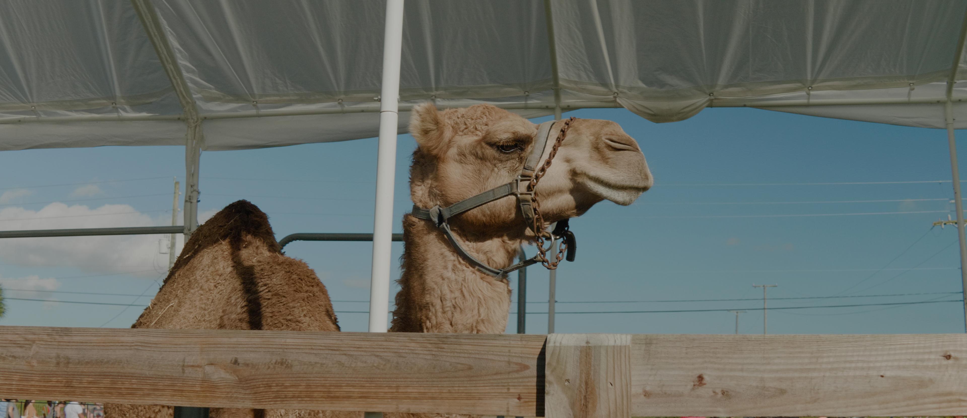

Sage Posted October 23, 2018 Author Share Posted October 23, 2018 On 10/17/2018 at 11:45 AM, Wild Ranger said: @Sage Sure! here are Vlog stills. Here they are with the new V3 Main, and levels set per the Pdf, with WB correction as best I could: Georgios, JeremyDulac, Exo7 and 2 others 5 Link to comment Share on other sites More sharing options...

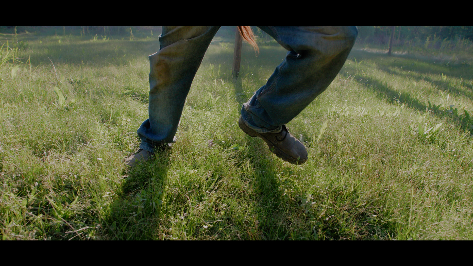

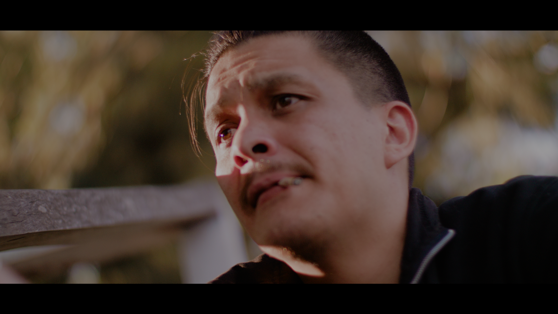

Wild Ranger Posted October 23, 2018 Share Posted October 23, 2018 I shot a music video this weekend, here are some stills using the new V3. This are from HD slow motion, so there is a little loss in quality. I applied noise reduction to smooth the compression and make the grade more seamless. All was capture with CineD. The first are with the "Main" lut and then corrected, and the second ones are my grade with LogC. JeremyDulac, Adept and ykt.net 3 Link to comment Share on other sites More sharing options...

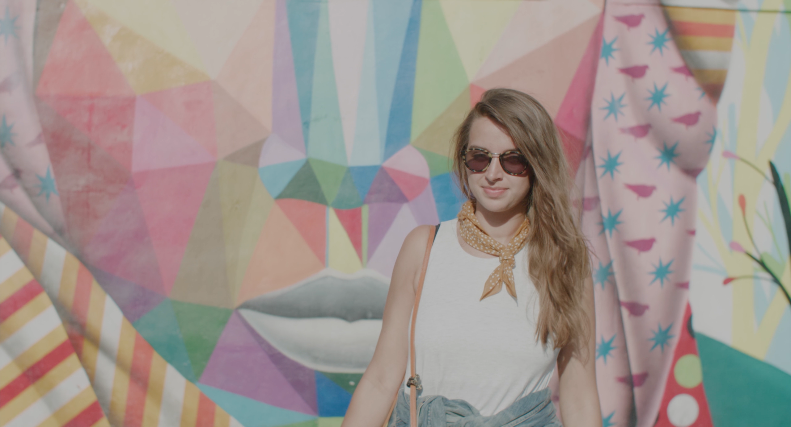

katlis Posted October 24, 2018 Share Posted October 24, 2018 Another awesome update, thanks @Sage! Here's some 10-bit 60p stills showing off 1) V-Log w/ Prores PRE 2) Main 3) Linear 4) Properly white balanced Linear. Although I like the warmth of the original "sunny" WB No luma adjustments on these! TurboRat, Exo7 and Wild Ranger 3 Link to comment Share on other sites More sharing options...

Sage Posted October 24, 2018 Author Share Posted October 24, 2018 11 minutes ago, ykt.net said: @JeremyDulac And how can I get it ? Did you give the 65x go ahead (in the email)? I'm presently inundated with V3 emails and stuck at work, but I will get up to speed later tonight* 16 minutes ago, katlis said: Another awesome update, thanks @Sage! Here's some 10-bit 60p stills showing off 1) V-Log w/ Prores PRE 2) Main 3) Linear 4) Properly white balanced Linear. Although I like the warmth of the original "sunny" WB No luma adjustments on these! Looks stunning. I quite like the warm WB as well - I wonder if it might be matched with a correction following the neutral conversion? JeremyDulac 1 Link to comment Share on other sites More sharing options...
katlis Posted October 24, 2018 Share Posted October 24, 2018 7 minutes ago, Sage said: Looks stunning. I quite like the warm WB as well - I wonder if it might be matched with a correction following the neutral conversion? Thanks! I ended up playing a bit more with the grade when I uploaded the video (below) using v2.2 as base last weekend. Although the above screenshots are from Resolve today, the final video was edited in Premiere and as I mentioned in the comments: "I always start with GHAlex as a base, followed by FilmConvert dialed down a bit. Then it's just experimenting in Lumetri for an overall grade, and adjusting luma on individual clips to get consistent exposure." I'm limited in resolution with the free version of Resolve, but I may just have to make the switch and get the full version! webrunner5 1 Link to comment Share on other sites More sharing options...
