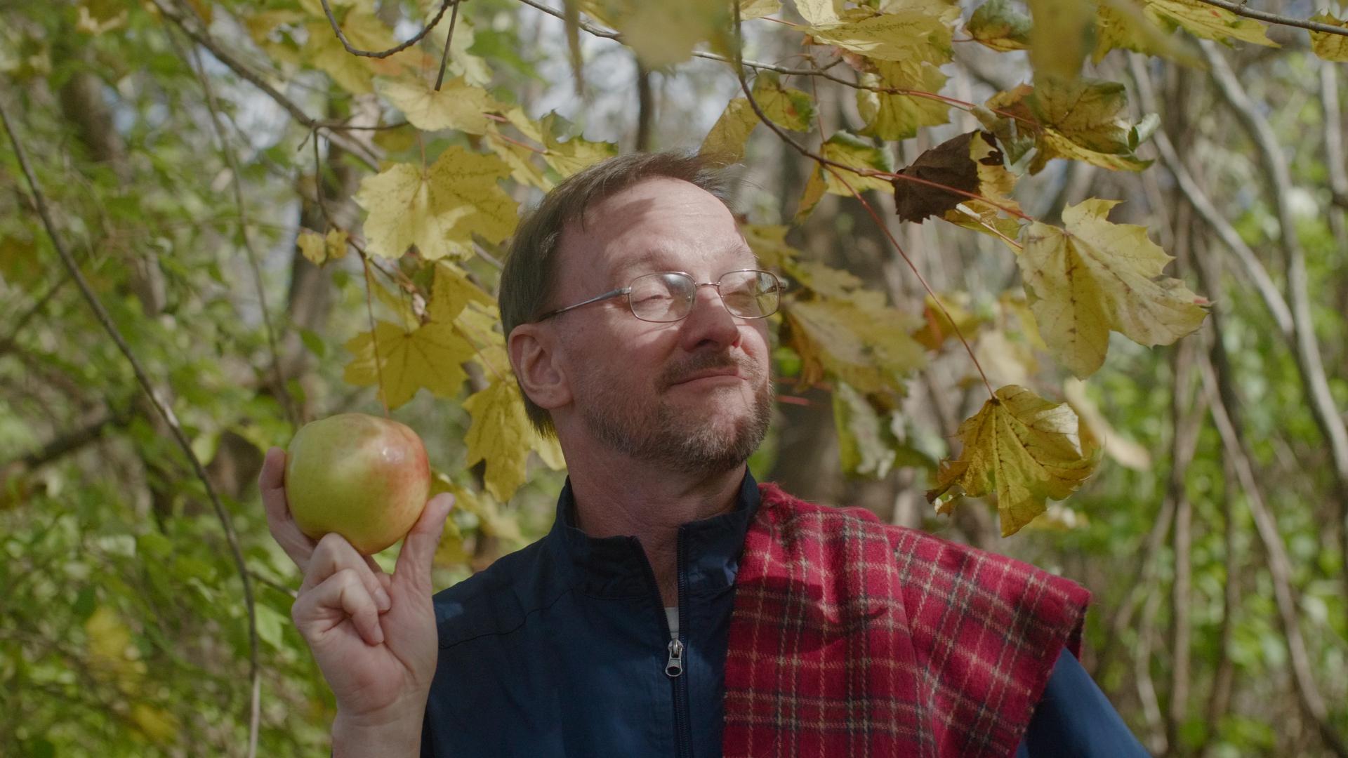

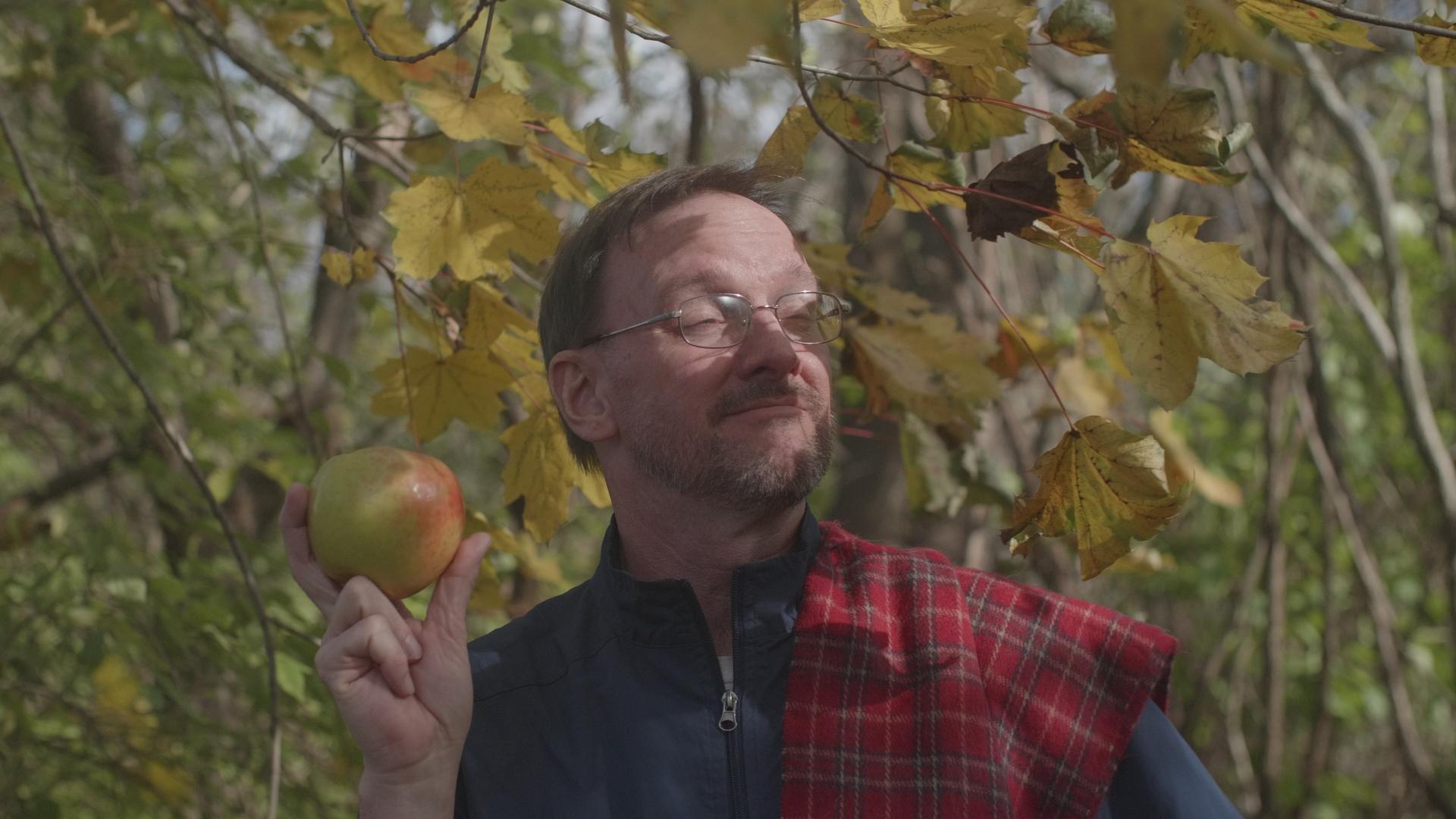

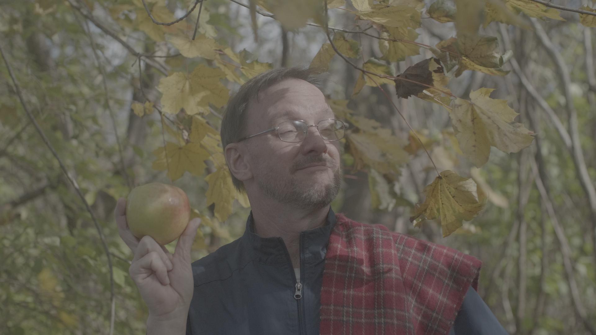

Sage Posted October 25, 2018 Author Share Posted October 25, 2018 This is the new V3 Linear, in context of the others (V35 for a reference): LogC Soft Main Linear V35 TurboRat 1 Link to comment Share on other sites More sharing options...

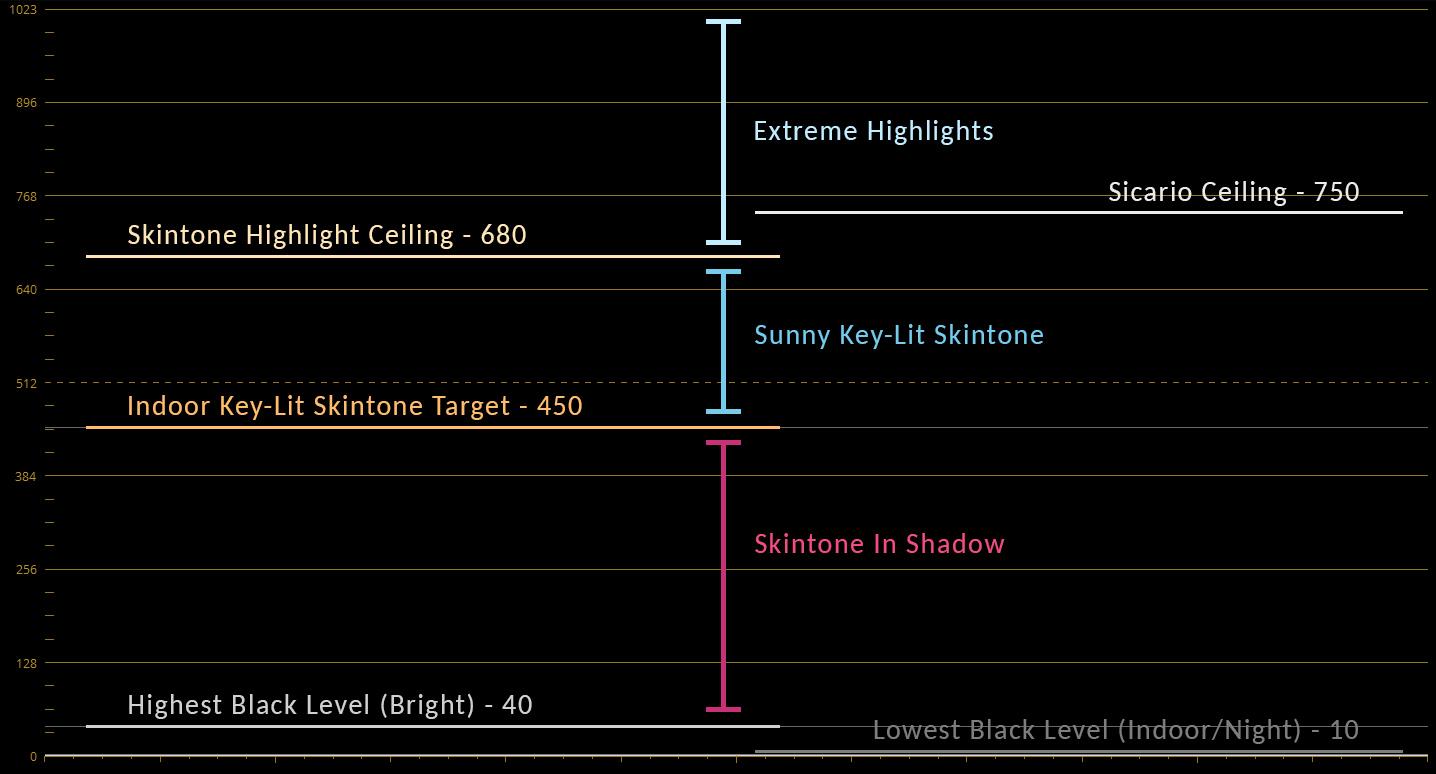

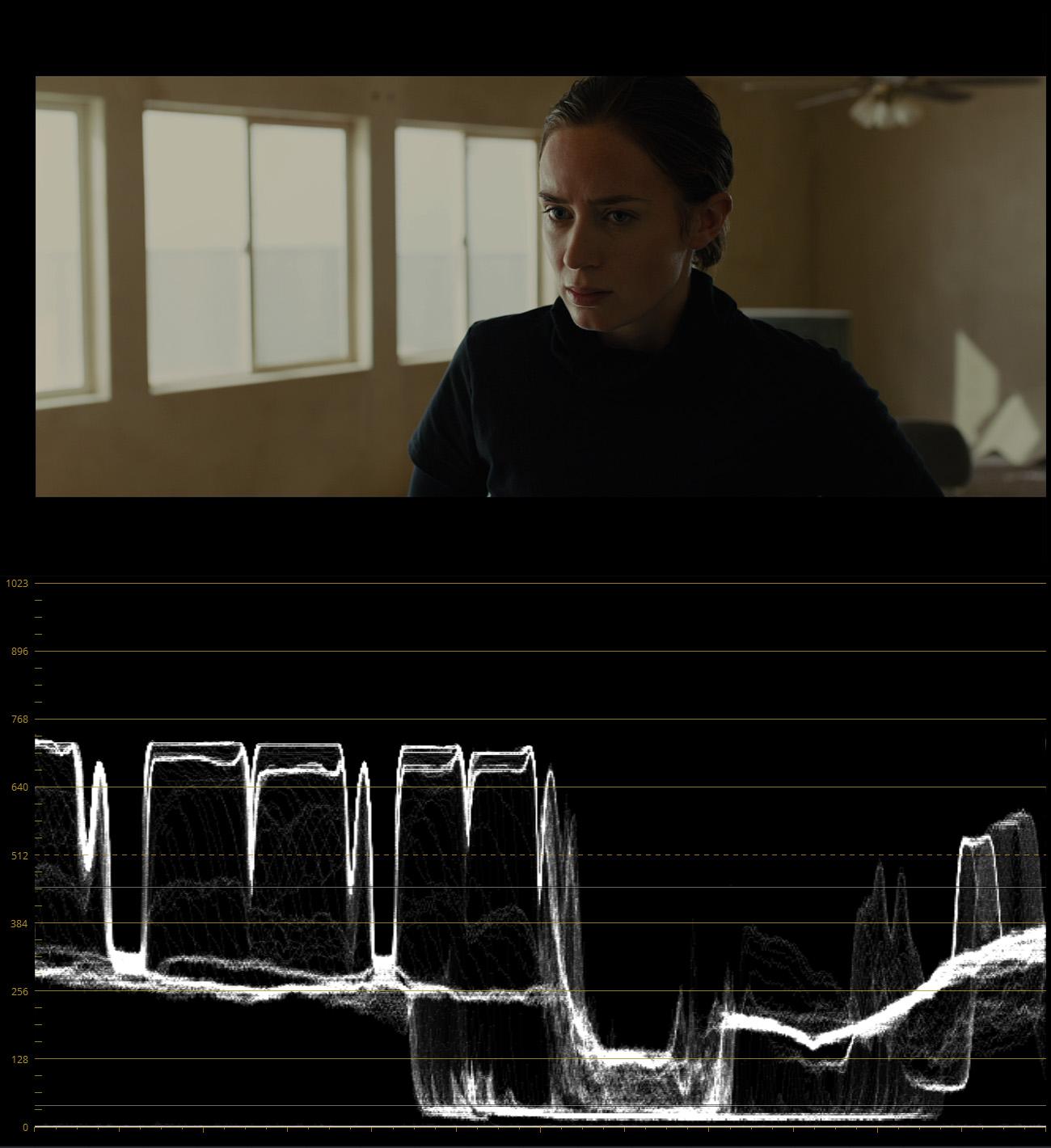

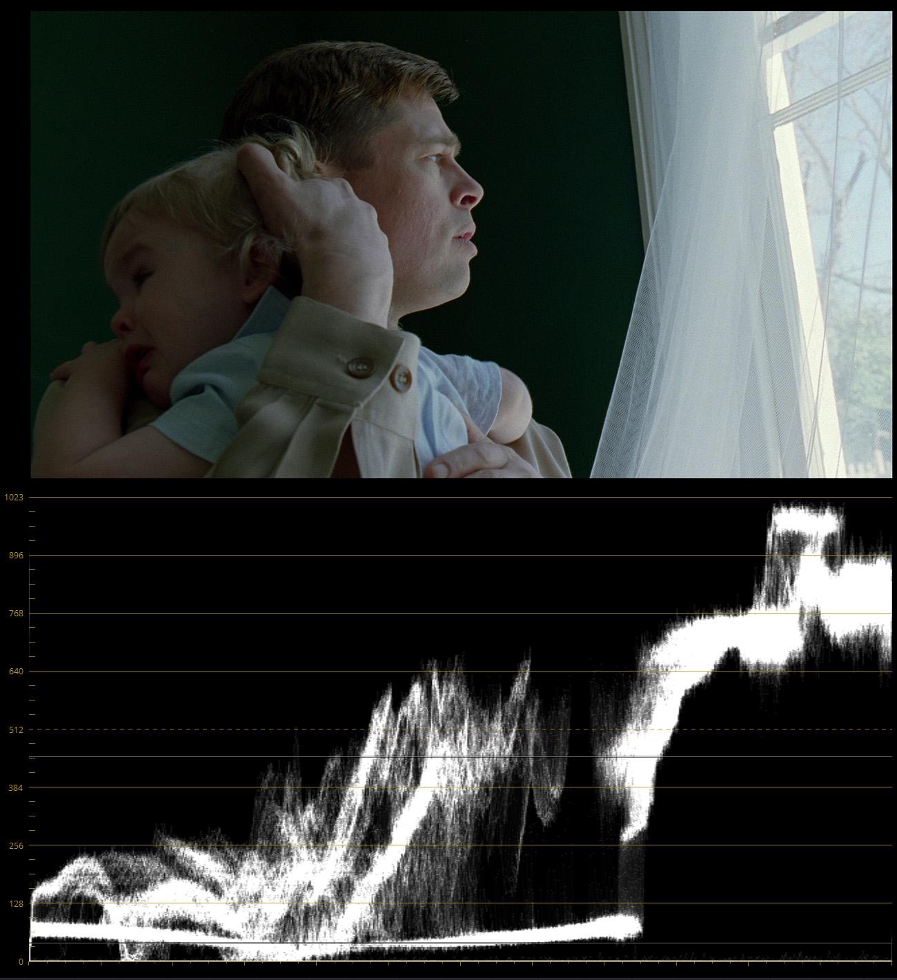

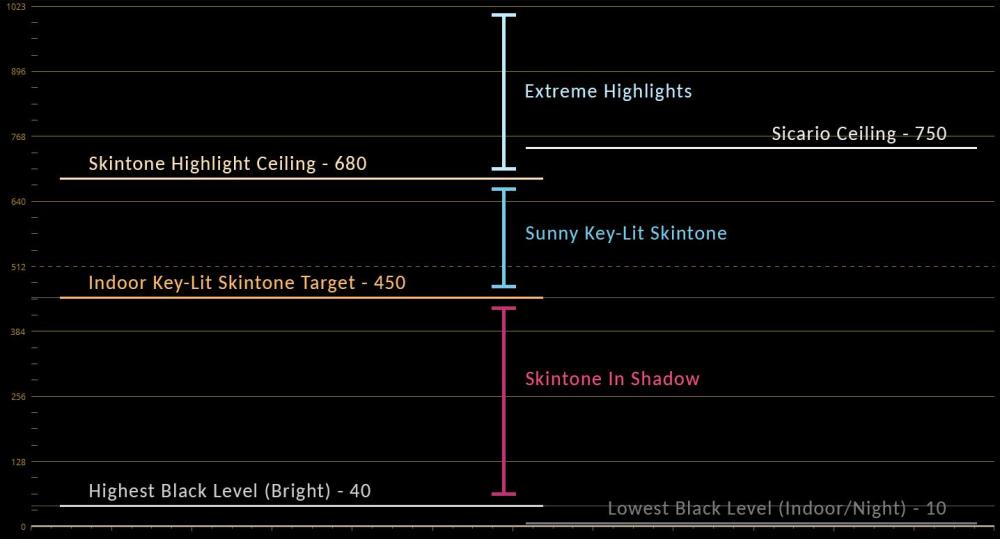

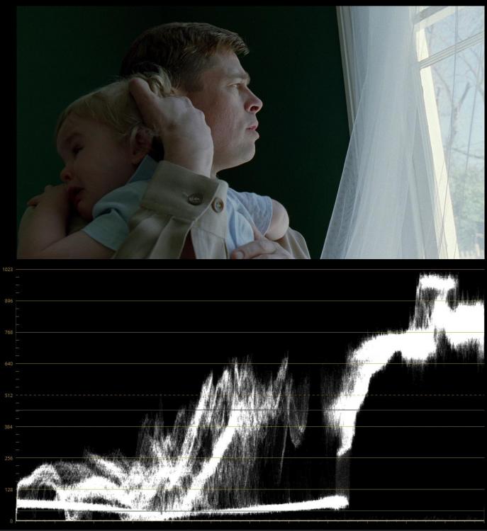

Sage Posted October 25, 2018 Author Share Posted October 25, 2018 35 minutes ago, katlis said: @Sage Re-graded with V3! I decided to try out Linear (GHa3-L ?), and tweaked the luma to compliment. Otherwise, the rest of my same grade from the 1st video is on top of GHa. I like the added contrast in this version! Thank you Katlis, there are some simply incredible shots in there. For dramatic works on projection I love the 'Sicario ceiling' of Main and Soft: Now, 'Tree of Life' really is an incredible testament to 90s IRE sun highlights (though, they had film): Link to comment Share on other sites More sharing options...

katlis Posted October 25, 2018 Share Posted October 25, 2018 14 minutes ago, Sage said: For dramatic works on projection I love the 'Sicario ceiling' of Main and Soft: I agree, while I've been getting acclimated with grading GH5 footage and following your advice I've always kept it under 75. Loving the results. Now I'm trying to get out of my comfort zone and experiment with new looks, so adding this Linear option to V3 is a nice push. Hoping to shoot my first real dramatic short next month. From the grade I'm imagining in my head, I'll probably stick with <75, but either way I'll be using GHa! Link to comment Share on other sites More sharing options...
Wild Ranger Posted October 25, 2018 Share Posted October 25, 2018 21 minutes ago, Sage said: Now, 'Tree of Life' really is an incredible testament to 90s IRE sun highlights (though, they had film): Yeah, i like the lower highlights but film, back in the day, when processed had a very bright punch and higher ceiling. Love that punch with film, which with this LogC conversion is more achievable. Different looks from different eras. Link to comment Share on other sites More sharing options...

TurboRat Posted October 25, 2018 Share Posted October 25, 2018 10 minutes ago, Sage said: Likewise - and when it comes time to shoot, it'll be the GH5 (and P4K @Téodor Spencer) for me. Your feature will be amazing, I have no doubt. Ah, I can't wait to see it! Yea Linear adds that bit of flexibility, which I think was a needed option. I'll be shooting trees in the sun today, just for fun lol (first chance to breathe) Indeed, that is that the higher ceiling really 'clicks' with film, I think due to the nature of the color sci, and the halation. Whereas the Sicario ceiling plays to the GH5's strengths, so to speak (btw, try linear ) What are you referring to about keeping under 75 and about the Sicario ceiling? But I agree with the better contrast in the V3 lut looks much better :). I always add contrast when I use the previous version of the GHa lut. Glad to see it's already added Link to comment Share on other sites More sharing options...
Sage Posted October 25, 2018 Author Share Posted October 25, 2018 1 minute ago, TurboRat said: What are you referring to about keeping under 75 and about the Sicario ceiling? But I agree with the better contrast in the V3 lut looks much better :). I always add contrast when I use the previous version of the GHa lut. Glad to see it's already added The new 'in Post: Cinematic Luminance' section on page 2 of the new PDF is critical, in addition to the new supplemental waveforms Essentially, the top third of the waveform is where extreme highlights place when conforming to cinema standard luminance. The GH5 is missing the three stops on top, and EC Main/Soft really encourage correct placement of luma for the cinema when exposing for them (moderately), and have beautiful handling of harsh skin detail TurboRat, deezid and anonim 3 Link to comment Share on other sites More sharing options...
