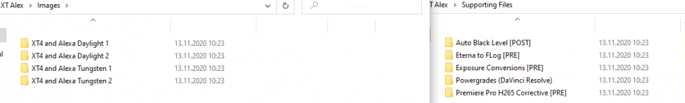

Victor Posted November 13, 2020 Share Posted November 13, 2020 @Sage I bought it for fuji, but these folders are empty, is that ok? There is only this: Link to comment Share on other sites More sharing options...
Sage Posted November 13, 2020 Author Share Posted November 13, 2020 Looks like a failure at the encryption stage (this rarely happens, a lot of heavy lifting on the back end). Download it once more and all the files should be present. Let me know how it goes! Link to comment Share on other sites More sharing options...
