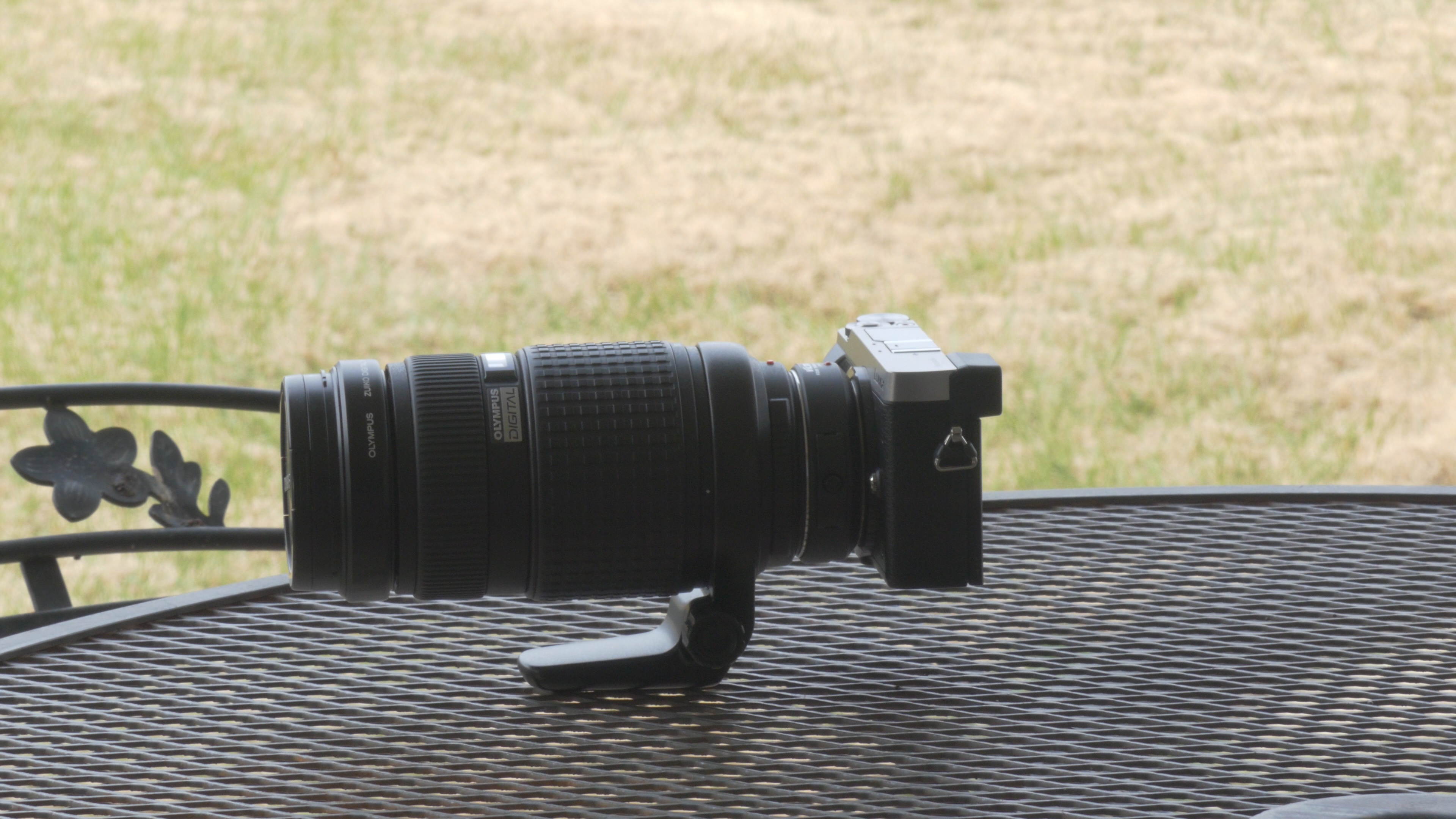

Thomas Hill Posted December 30, 2017 Share Posted December 30, 2017 I just compared the Viltrox 4/3 to M4/3 smart adapter against the $120 more expensive Olympus MMF-3 adapter and they have identical AF performance with the Olympus 50-200mm f2.8-3.5 attached to a GX85. And when I say identical, I mean identically slow. It would be fine for still photography where the subject is being still but unusable for video AF. Image quality was also identical. This was with the non-SWD version of the lens, SWD lenses might be better...I don't have any to test. Physically, the Viltrox feels more solid than the MMF-3 but has just a hair more play between the lens and the adapter. Both are good and tight against the camera body. With the Viltrox being just as good as the Olympus adapter, I would definitely give their focal reducer a try. Link to comment Share on other sites More sharing options...
