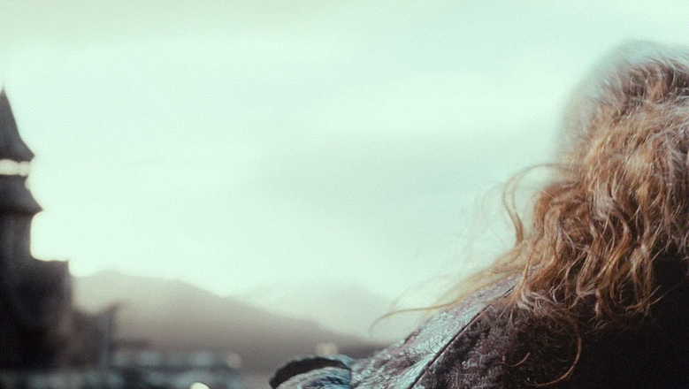

Emanuel Posted December 19, 2017 Share Posted December 19, 2017 I bet bit rate will end in a solid key to avoid it as much as when "only" 8bit 422: sample (not mine) extracted from (minute 28:30):https://vimeo.com/114978513 maxotics 1 Link to comment Share on other sites More sharing options...
