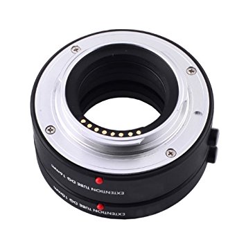

I've thought about this too, except in a slightly different approach. Entertain me for a second. I'm a fellow INTP. ?
You know those macro extension tubes sold cheaply on line? Well, they actually maintain electronic control with native NX glass and could be a perfect candidate to retrofit a diffusion filter inside whilst gaining macro ability and keeping AF/Aperture communication intact.
Thoughts?
I would be very leary of putting any other material besides glass close to the image sensor. I think that's asking for trips to the camera repair shop for frequent sensor cleaning.
ah indeed I have this very extension tube burred somewhere around here but its fairly flimsy would not trust dangling either S-Lenses off it with out a with out rails and a brace
my 30mm, 16mm, 45mm pancakes will do fine.
this could be feasible use one section for Low contrast filter... and the other we just have to devise some sort of pseudo Internal adjustable ND Filter :thumbsup:
The Dream of the NX S-100 (my version of a C-100 type camera) is drawing Near
