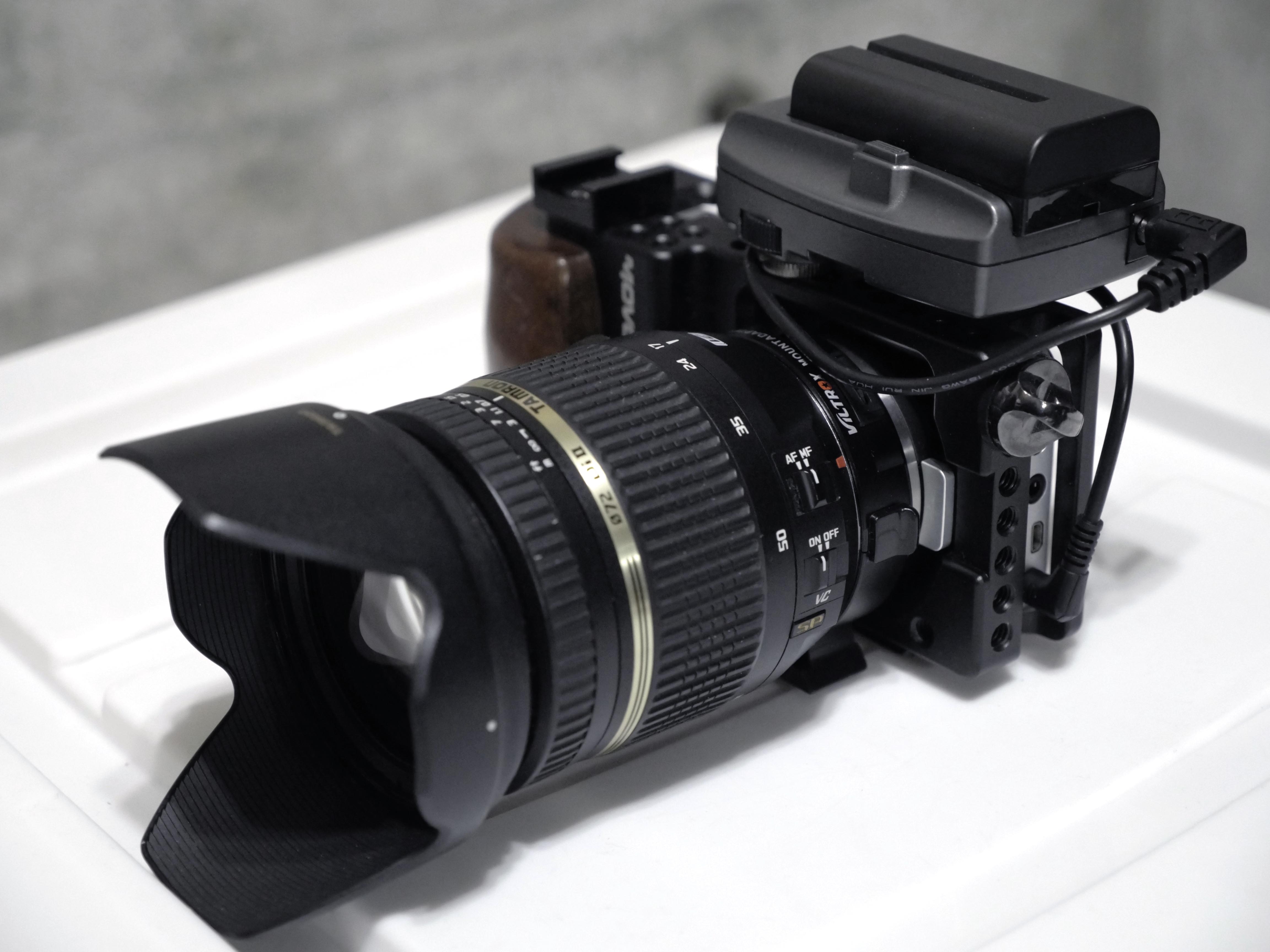

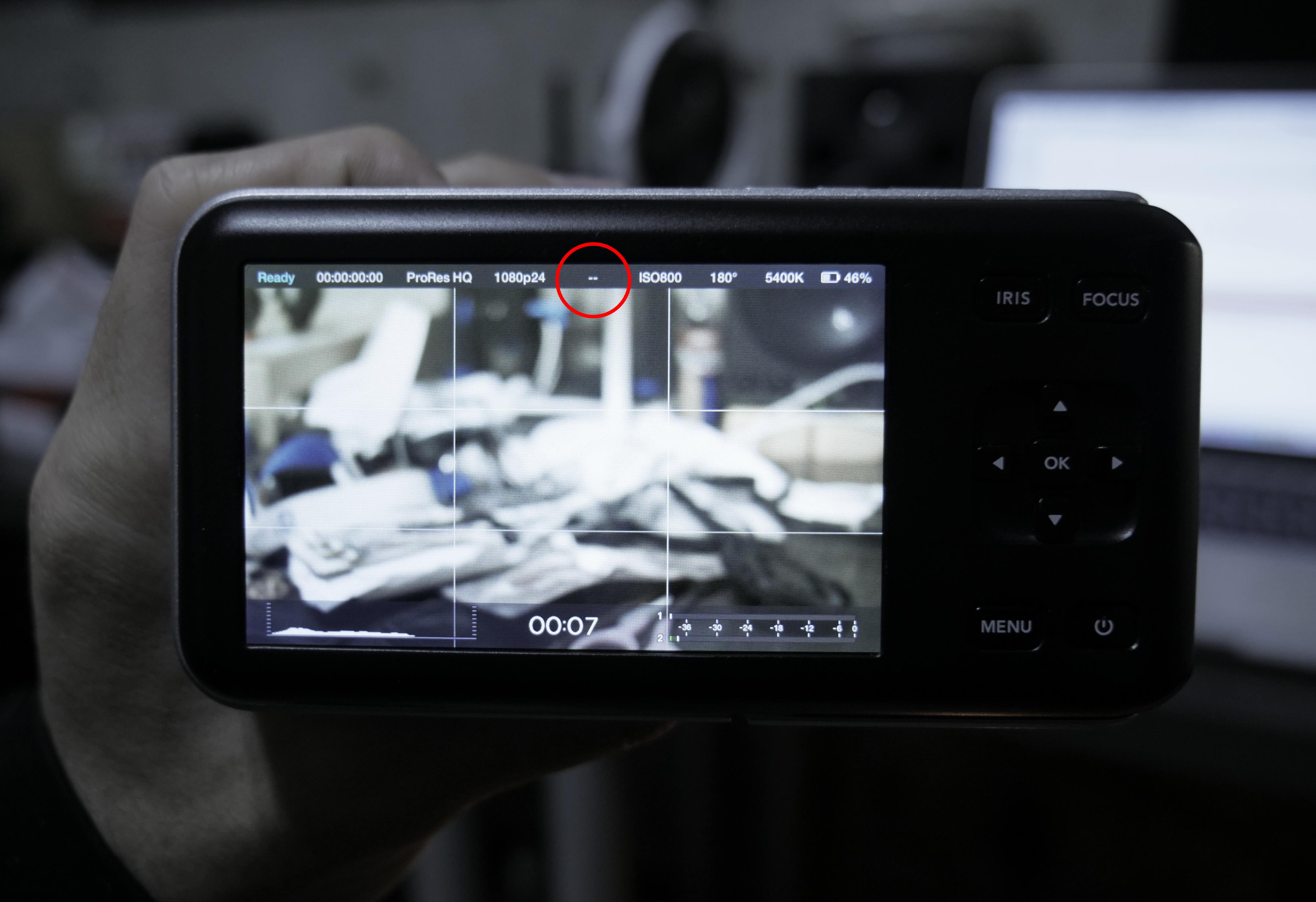

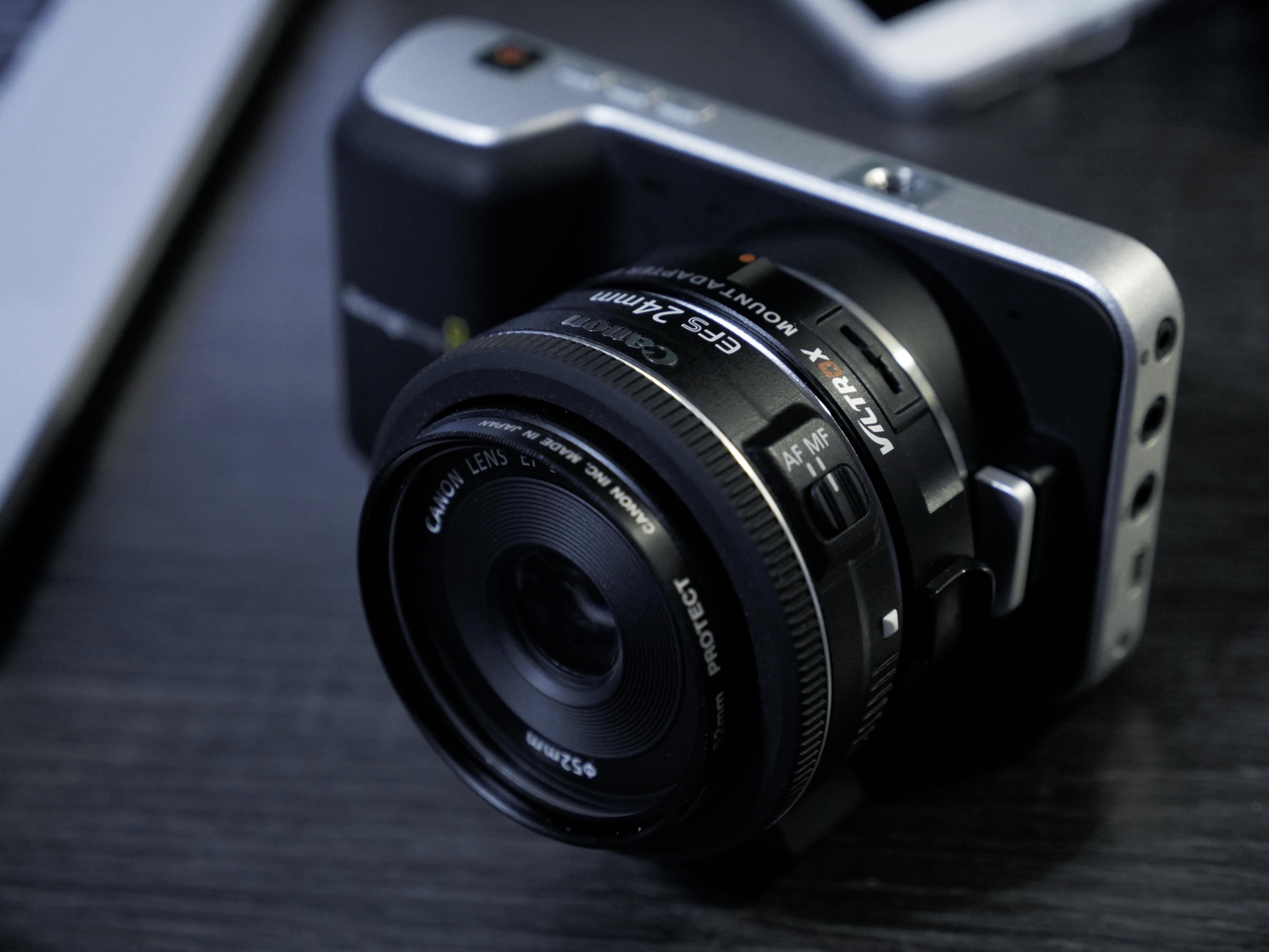

u1film Posted February 11, 2018 Share Posted February 11, 2018 unfortunately it does not seem to work with bmpcc at this point. it does not show f-stop (cant control). Seems like It cannot recognize lens at all. Lens i tested ・Canon EF-S 24mm f/2.8 STM Lens ・Tamron SP 17-50mm f/2.8 XR Di-II VC ・Tamron SP 70-200mm f/2.8 DI VC 3lens above work well with my gh4 (except stabilization) Juxx989 1 Quote Link to comment Share on other sites More sharing options...

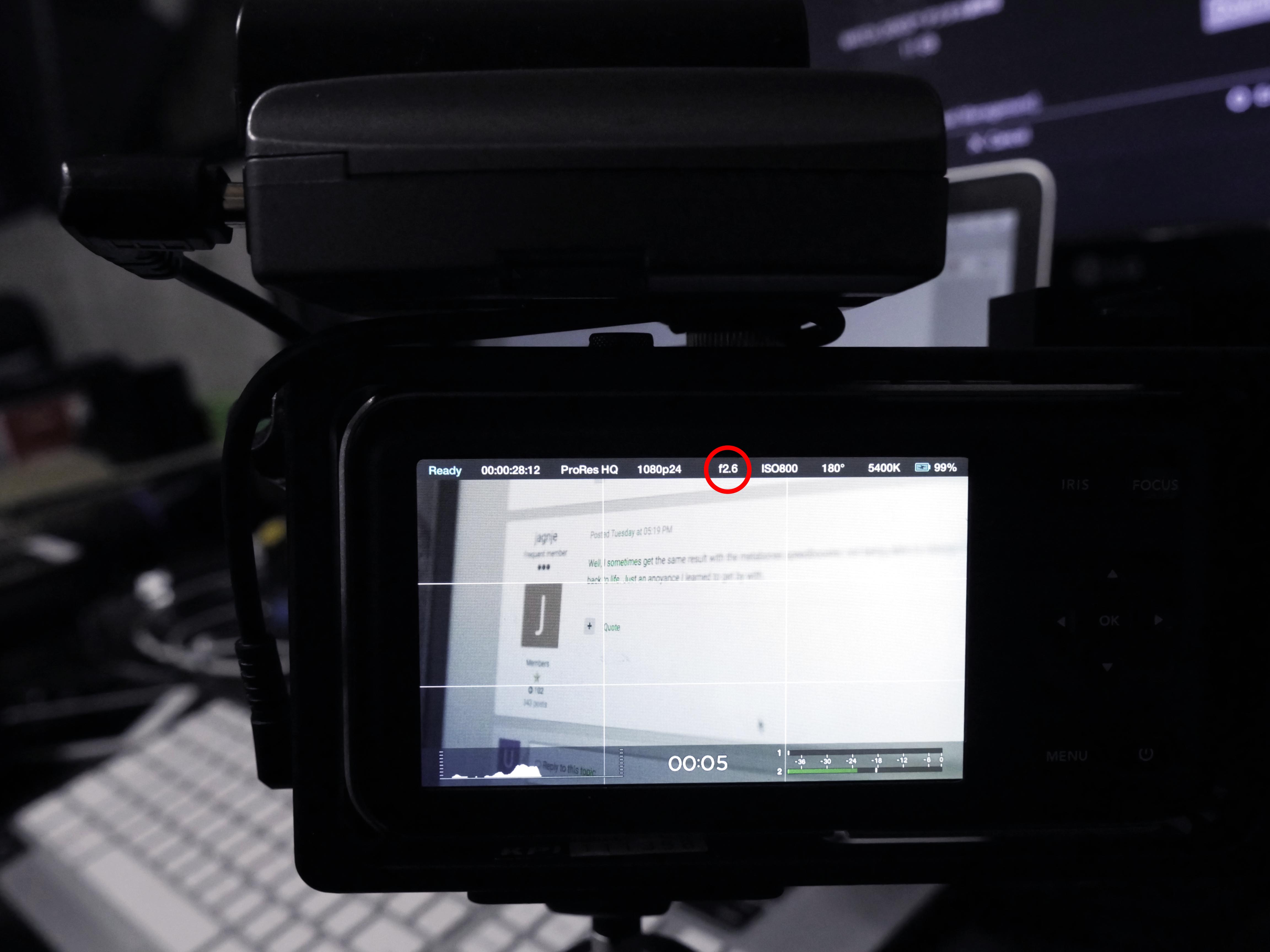

jagnje Posted February 13, 2018 Share Posted February 13, 2018 Well, I sometimes get the same result with the metabones speedbooster, not being able to change the iris. Releasing the mount while the camera is operating ussually brings it back to life. Just an anoyance I learned to get by with. Quote Link to comment Share on other sites More sharing options...
u1film Posted February 15, 2018 Share Posted February 15, 2018 @jagnje OMG that perfectly works with all the lens i mentioned ↑ IRIS function and even the IS thing on TAMRON lens works (which does not work with my gh4) the happiest thing happen in 2018 so far.. u made my day. thank u! meudig and Juxx989 2 Quote Link to comment Share on other sites More sharing options...
