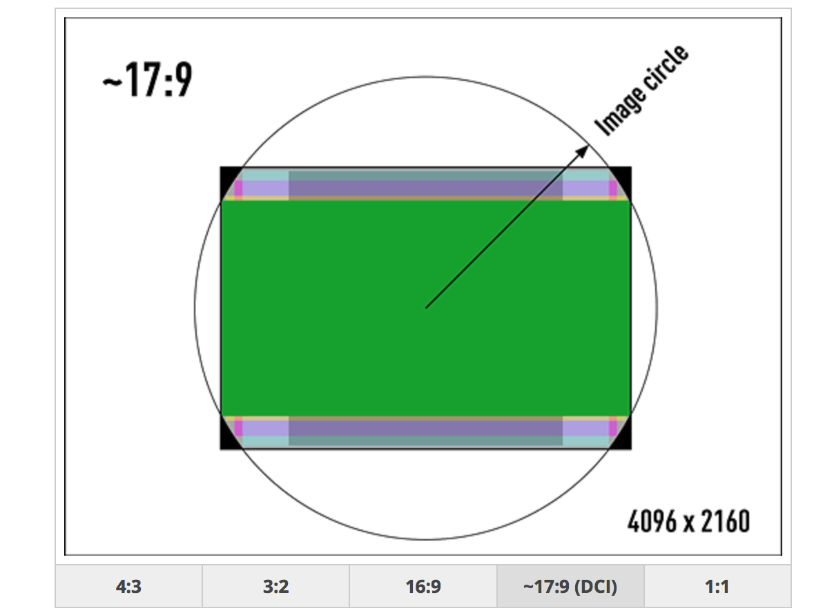

Trek of Joy Posted January 17, 2018 Share Posted January 17, 2018 On 1/16/2018 at 5:30 AM, Robin Billingham said: The regular gh5 is a 2x crop of full frame. If both formats achieve 16×9 by cropping the top and bottom on the sensor(making the sensor smaller) then a 2x crop ratio would be maintained. However on an oversized sensor the 16×9 mode is achieved by using extra pixels available within the imaga circle, no cropping, so the ratio between the formats is changed to a less than 2x crop (in the case of the gh5s). If the full frame sensor was also an oversized multi aspect one then the 2x crop would remain between the 2. In reality this makes the gh5s crop around the 1:86-1:89 mark. Small changes for 16×9 or 17:9 etc Or 2x crop for stills in its native format I must be missing something because even 17:9 is still within the m43 image circle. Its a wider FOV compared to the GH5 which essentially crops the top/bottom off the m43 image for 16:9 video - hence the 2.18-ish crop compared to FF. But in DCI its still in the m43 image circle as seen below - which has a diameter of 21.63mm, or half FF which is 43.27. All aspect ratios are a 2x crop on the GH5s. So how is it 1.89 or whatever? Link to comment Share on other sites More sharing options...
