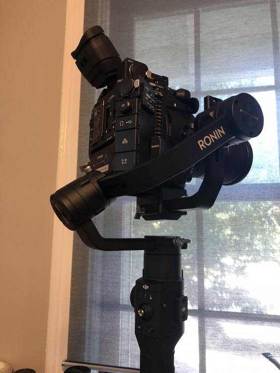

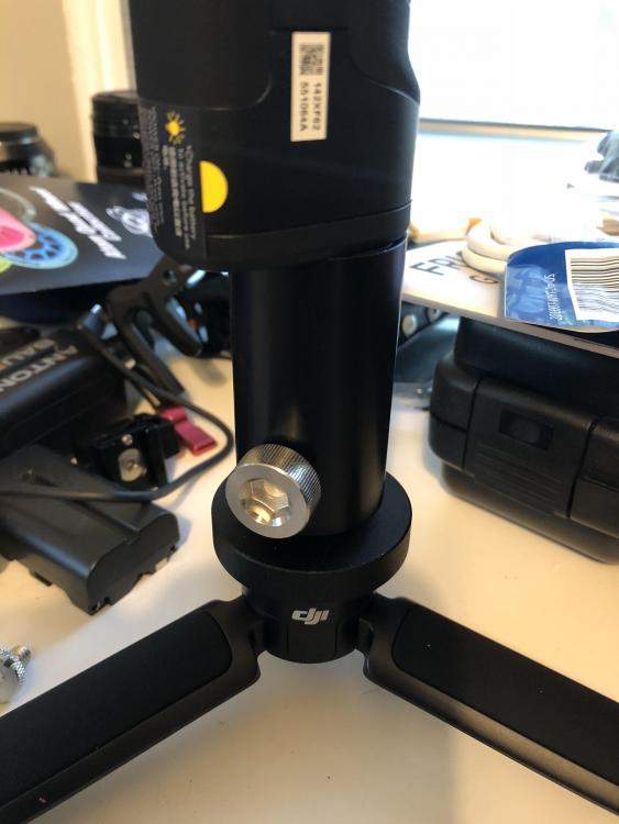

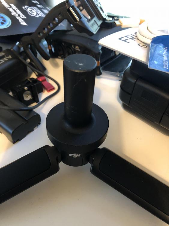

DBounce Posted July 10, 2018 Share Posted July 10, 2018 So I just got the DJI Ronin S and decided to try it with a couple of cameras. The cameras I have tested so far are the Panasonic GH5S and the Canon C200. The former is well suited to handheld work given it is fully supported with the tether cable which is included with the Ronin S. The C200 is a much heavier affair so I would not recommend using this camera handheld with the Ronin S. However, as luck would have it... that is several phone calls and emails to Glide Gear would have it ? they now have an adapter so that the Ronin S can be mounted to the Glide Gear arm to help support heavier setups. To that end I have tried the C200 on the Ronin S with the Glide Gear Arm and can report it is awesome. I could not imagine using the C200 on the gimbal without some sort of support. I have not done any testing beyond balancing with the C200, and mounting the Ronin S/C200 onto the arm and shooting some spray and prey footage ( I have not attached the monitor as I have not received the monitor adapter yet). Anywho, here are some quick picies of the setup. Comments or question welcomed. Trek of Joy and JordanWright 2 Link to comment Share on other sites More sharing options...
DBounce Posted July 10, 2018 Share Posted July 10, 2018 Almost forgot to mention, the lens on the C200 is the Canon 24-70mm f2.8 II L series. The red ring came off by itself... though it may have had help from an over exuberant maid... AnyWhodles... Link to comment Share on other sites More sharing options...
