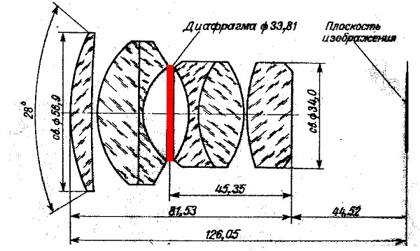

Hans Punk Posted January 24, 2018 Share Posted January 24, 2018 Adding oval discs to anywhere other than at a lens at aperture location will introduce considerable light loss and added vignette. Solution is to locate oval aperture directly - or at the closest point to aperture level (as mentioned by whoisjsd). Easiest and cheapest is to modify a Helios 44 lens this way, and to use that as your taking lens. See diagram below to see highlighted area for proper oval aperture placement in Helios 44 (or any similar Double-Gauss lens design): With an oval aperture correctly installed and orientated, the effect is increased oval bokeh on a 1.33x anamorphot, and a sharpening effect due to the taking lens effectively being stopped down on the horizontal axis (yet maintaining near full height aperture). Here is a crappy sample of my 1.33x Century with Helios 44 with oval aperture installed...ignore the softness of the image, the proximity of the subjects was too close for sharp focus...but you can clearly see the improvement in bokeh definition: Tito Ferradans and Cosimo 2 Quote Link to comment Share on other sites More sharing options...
rjderama Posted January 24, 2018 Author Share Posted January 24, 2018 14 hours ago, Hans Punk said: Adding oval discs to anywhere other than at a lens at aperture location will introduce considerable light loss and added vignette. Solution is to locate oval aperture directly - or at the closest point to aperture level (as mentioned by whoisjsd). Easiest and cheapest is to modify a Helios 44 lens this way, and to use that as your taking lens. See diagram below to see highlighted area for proper oval aperture placement in Helios 44 (or any similar Double-Gauss lens design): With an oval aperture correctly installed and orientated, the effect is increased oval bokeh on a 1.33x anamorphot, and a sharpening effect due to the taking lens effectively being stopped down on the horizontal axis (yet maintaining near full height aperture). Here is a crappy sample of my 1.33x Century with Helios 44 with oval aperture installed...ignore the softness of the image, the proximity of the subjects was too close for sharp focus...but you can clearly see the improvement in bokeh definition: That’s the fear that I had. A Helios 44 Woth an oval bokeh disc seems to work wonders. And since the laws of physics can’t be bent, having the disc at the aperture blades is my goal then. However, since I want to continue using my Sony lenses due to AF< Ill try a disc at the rear element just for fun, while grabbing a Helios and modding it. And I’ll also see if A used Sony FE 28mm shows up used and sacrifice it to the Gods in an attempt to mod that. Hahaha Quote Link to comment Share on other sites More sharing options...
