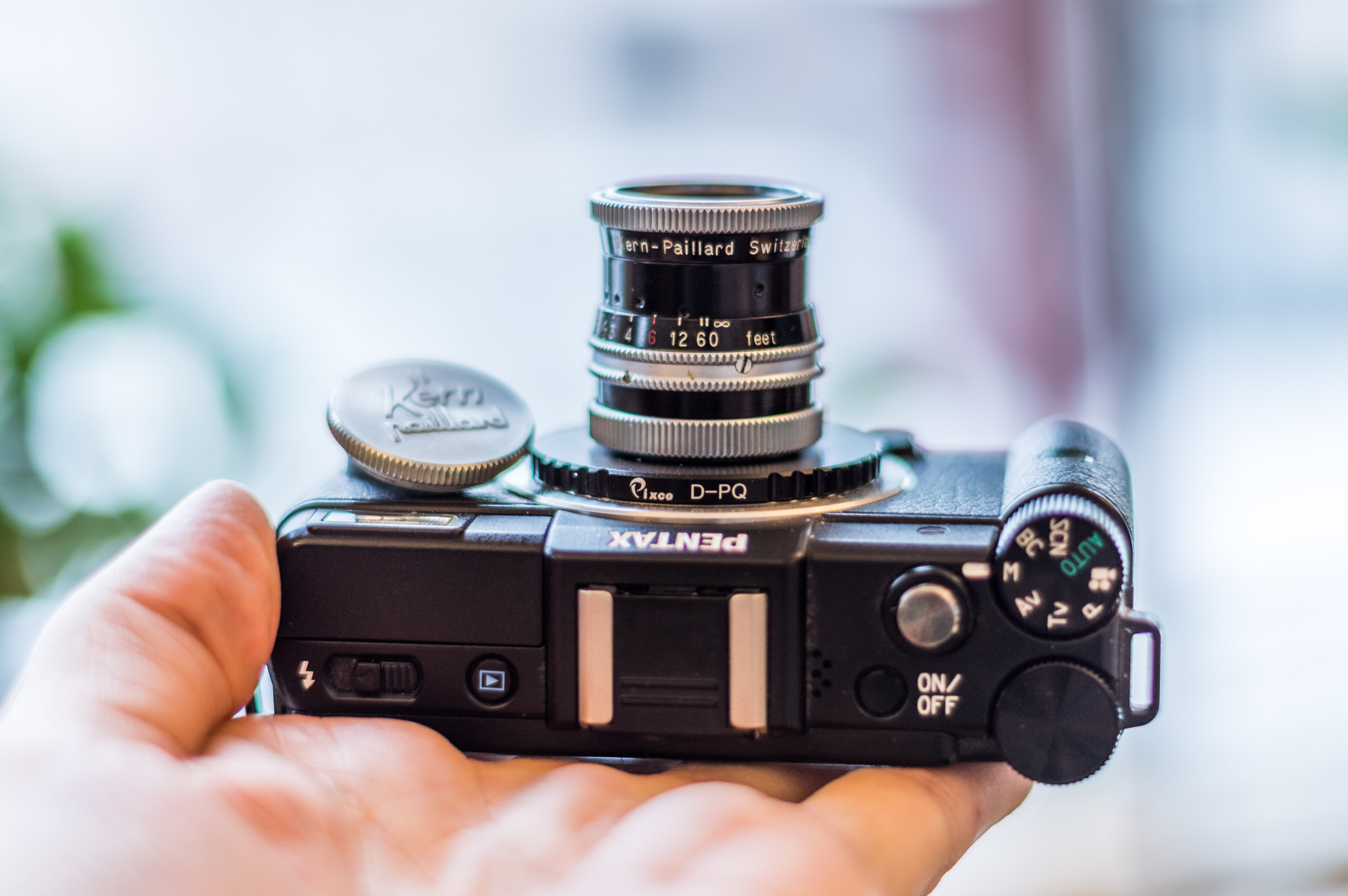

Super Members Mattias Burling Posted February 8, 2018 Super Members Share Posted February 8, 2018 1 hour ago, cantsin said: @Matthias, which d-mount adapter? Can you give us a link? I don't remember the brand. I can get back to you when it arrives. Link to comment Share on other sites More sharing options...
Super Members Mattias Burling Posted February 16, 2018 Super Members Share Posted February 16, 2018 It finally showed up. The adapter was a pixco. PannySVHS 1 Link to comment Share on other sites More sharing options...
PannySVHS Posted February 16, 2018 Share Posted February 16, 2018 what a pretty outfit, Mattias! Is the sensor about as good as from Olys compact cameras like XZ2? I like what I can get out of an XZ10 and its raw files. Video is nice? They should come out with a 2400x1200 sensor for HD raw video and give us the ultimate digital pocket 8mm cam, recording in perfect cdng. Mattias Burling 1 Link to comment Share on other sites More sharing options...
Super Members Mattias Burling Posted February 16, 2018 Super Members Share Posted February 16, 2018 I haven't compared to the Olympus but the camera gives me great looking images. I could talk for hours about this camera, its a lot of fun. If anyone ever thought about getting one, now is the time. Because in a week or two my review will bump those ebay prices to the moon. PannySVHS 1 Link to comment Share on other sites More sharing options...
cantsin Posted February 16, 2018 Share Posted February 16, 2018 2 hours ago, Mattias Burling said: It finally showed up. The adapter was a pixco. Aah, thought you meant an adapter for the EOS-M. Yes, there are plenty of d mount adapters for the Pentax Q. My review of d mount lenses was shot with one. The Pentax has a usable flat color profile, but only 30p and a weak codec (and lots of artificial sharpening you can't dial out). Made this video 5 years ago with a first-generation Pentax Q and adapted Kern Switar 13mm/f0.9 d-mount lens: Link to comment Share on other sites More sharing options...
Super Members Mattias Burling Posted February 16, 2018 Super Members Share Posted February 16, 2018 Its only the fitst generation that's 30p only. The others have 24 and 25 as well. Link to comment Share on other sites More sharing options...
