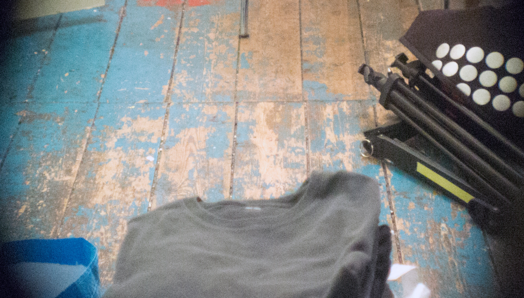

cantsin Posted March 2, 2018 Share Posted March 2, 2018 4 hours ago, Alpicat said: Thanks so much for testing this - good to know and may consider this lens in future if I have money! I don't imagine it would cover a 16:9 crop frame on the EOS M (which is approx 1800x1024) since that's a fair amount more than super 8 size, but if you're able to check at some point that would be useful. Fortunately, I hadn't erased my test picture yet. So to answer your question, the Angenieux 8-64/f1.9 covers 1800x1024 only with dark corners (see below). - A reason for the larger image circle coverage of that lens could be that it may have been designed for Pathe's 9.5mm film format (that was a popular amateur film format in France). But I'm speculating here. Link to comment Share on other sites More sharing options...
Alpicat Posted March 2, 2018 Share Posted March 2, 2018 That's not bad! Wouldn't take much of a crop to get rid of the vignetting, though obviously going for a 4:3 ratio is the best option here. Link to comment Share on other sites More sharing options...
