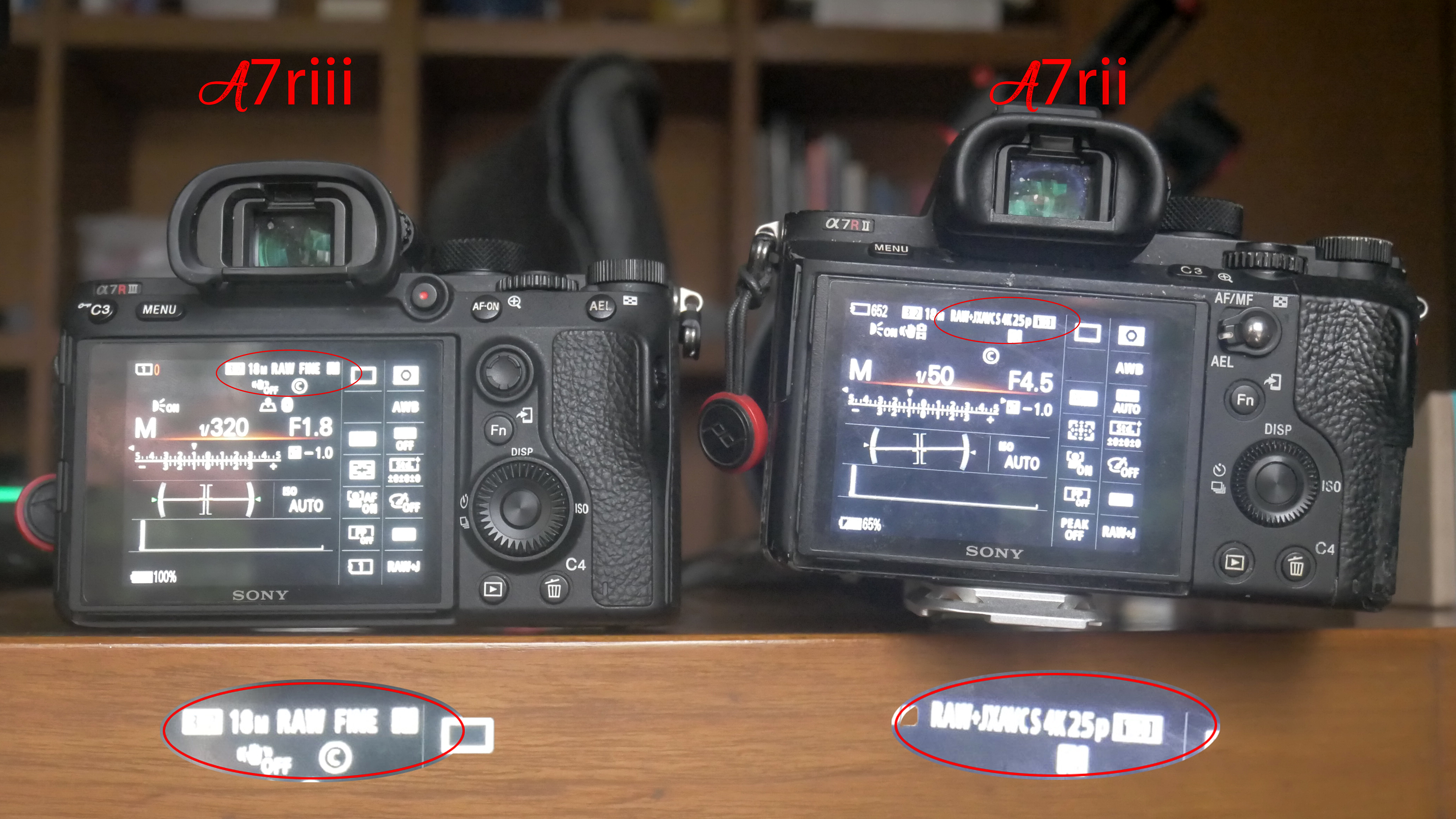

Robert Collins Posted January 29, 2018 Share Posted January 29, 2018 I think you are right. Current movie settings dont show even in 'display all info' on the A7r3. With my A7r2 the movie settings show in that tab. Link to comment Share on other sites More sharing options...

Robert Collins Posted February 3, 2018 Share Posted February 3, 2018 11 hours ago, Andrew Reid said: Page 6/9 of shoot menu 2 in main menu You will find option called "DISP button" Check "Show all info" box and select Enter to confirm the change. Now you can cycle with DISP and in one mode it will show everything inc. video mode codec, etc. Actually the display all info page on the A7riii doesnt show the video settings when in PASM unlike the A7rii which does. See pic. Link to comment Share on other sites More sharing options...
Administrators Andrew Reid Posted February 3, 2018 Administrators Share Posted February 3, 2018 Ah so you mean in stills mode, with live-view disabled. Do you have an HDMI screen connected or are you primarily using the EVF and the back screen only as an info reference panel? Link to comment Share on other sites More sharing options...
Robert Collins Posted February 3, 2018 Share Posted February 3, 2018 2 minutes ago, Andrew Reid said: Ah so you mean in stills mode, with live-view disabled. Do you have an HDMI screen connected or are you primarily using the EVF and the back screen only as an info reference panel? Just EVF and LCD. Link to comment Share on other sites More sharing options...
Administrators Andrew Reid Posted February 3, 2018 Administrators Share Posted February 3, 2018 Just tried on mine and there is no way to get it to show the codec and frame rate on that screen. A work around is to set 4K/1080p and other key video settings like frame rate to the custom My Menu, which shows what they are set to when you hit the menu button. Or just shoot in video mode and save stills mode to Custom mode dial slot 3, giving you ability to quickly toggle between the two side by side on the mode dial? Link to comment Share on other sites More sharing options...
