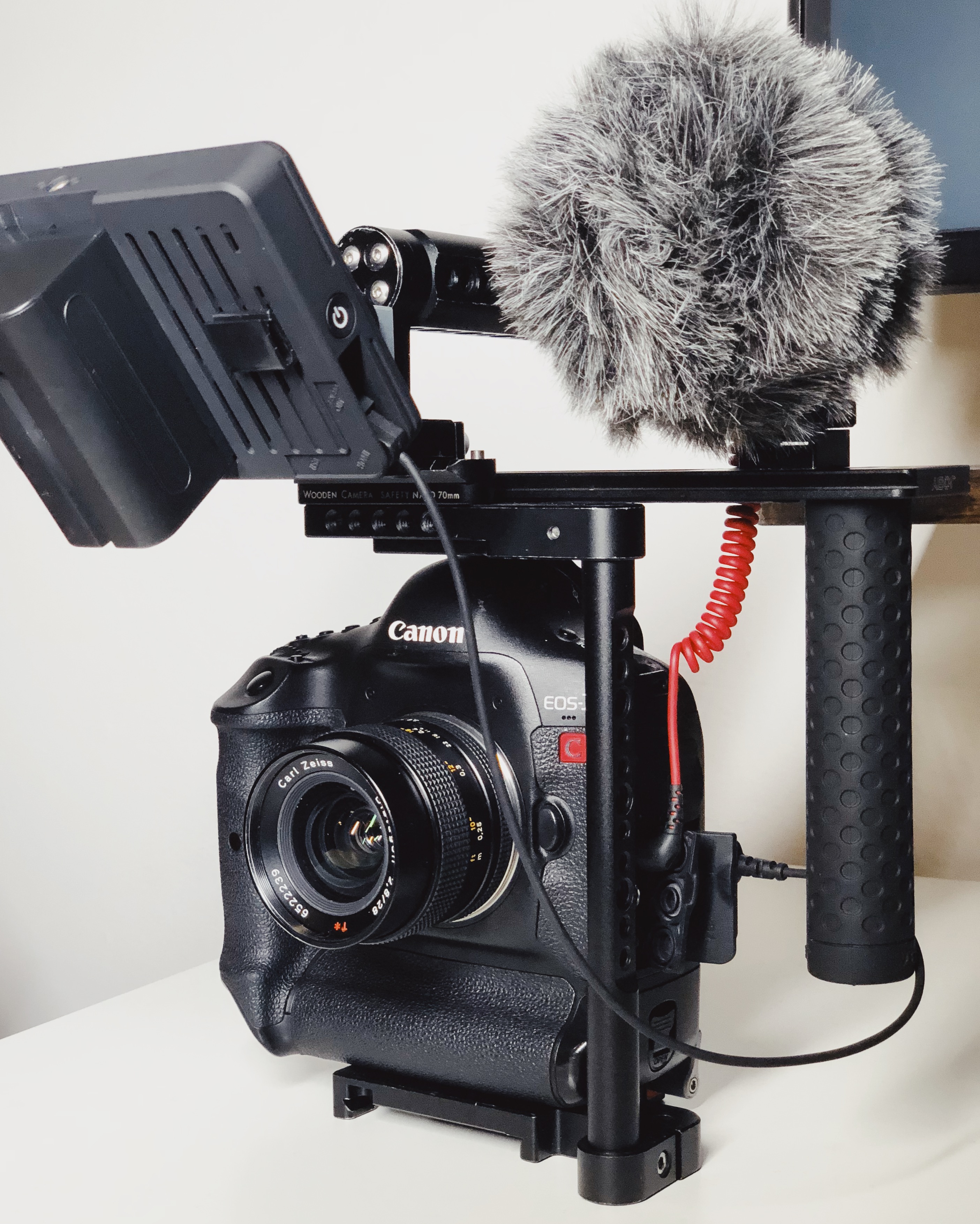

Dave Maze Posted February 5, 2018 Share Posted February 5, 2018 I use the 1DC on a daily basis and switch between the 4K and super35 modes according to what I’m doing. The super35 mode is like having a C100 with better low light (except you can’t mount most EF-s lenses on it!) the 4K mode is to die for. It’s been so hard for me to justify “upgrading” to anything else because when I shoot with a modern camera... it still pales in comparison. Even the 1DX II doesn’t do it justice because of log. Andrew makes a great C Log for it... but it’s still just not the same and even he would admit that I’m sure. I recently built out a rig that is the most balanced and amazing handheld rig I’ve ever built with it. Wooden camera DSLR cage, with handles and the smallhd focus. I convert all my footage I shoot in 4K to ProRes LT. It’s a pain but whatever. I don’t care. Edit Ready 2.0 is a great program for it, and I’d imagine on an iMac pro it would convert in no time. Even on my base model 13” MacBook Pro it doesn’t really take that long. 1.3x is the only thing that drives me crazy to be honest. If it were true full frame a 24-105 would be all I’d carry around, but because it’s a weird crop and no lenses are designed for it... you kinda have to own a 16-35 AND a 24-70. I only use my Contax Zeiss glass on it and they pair perfectly. That nice vintage character paired with that milky smooth 4K canon log. It’s the best image quality I’ve ever had and I’m so happy about it still in 2018. I never want to part with it unless I become rich and buy a RED EPIC VV or Arri Alexa Mini. I don’t think the camera is impractical for handheld work or whatever. Just treat it like you would with a RED or Arri and it’s the same type of workflow. Hitfabryk 1 Link to comment Share on other sites More sharing options...
