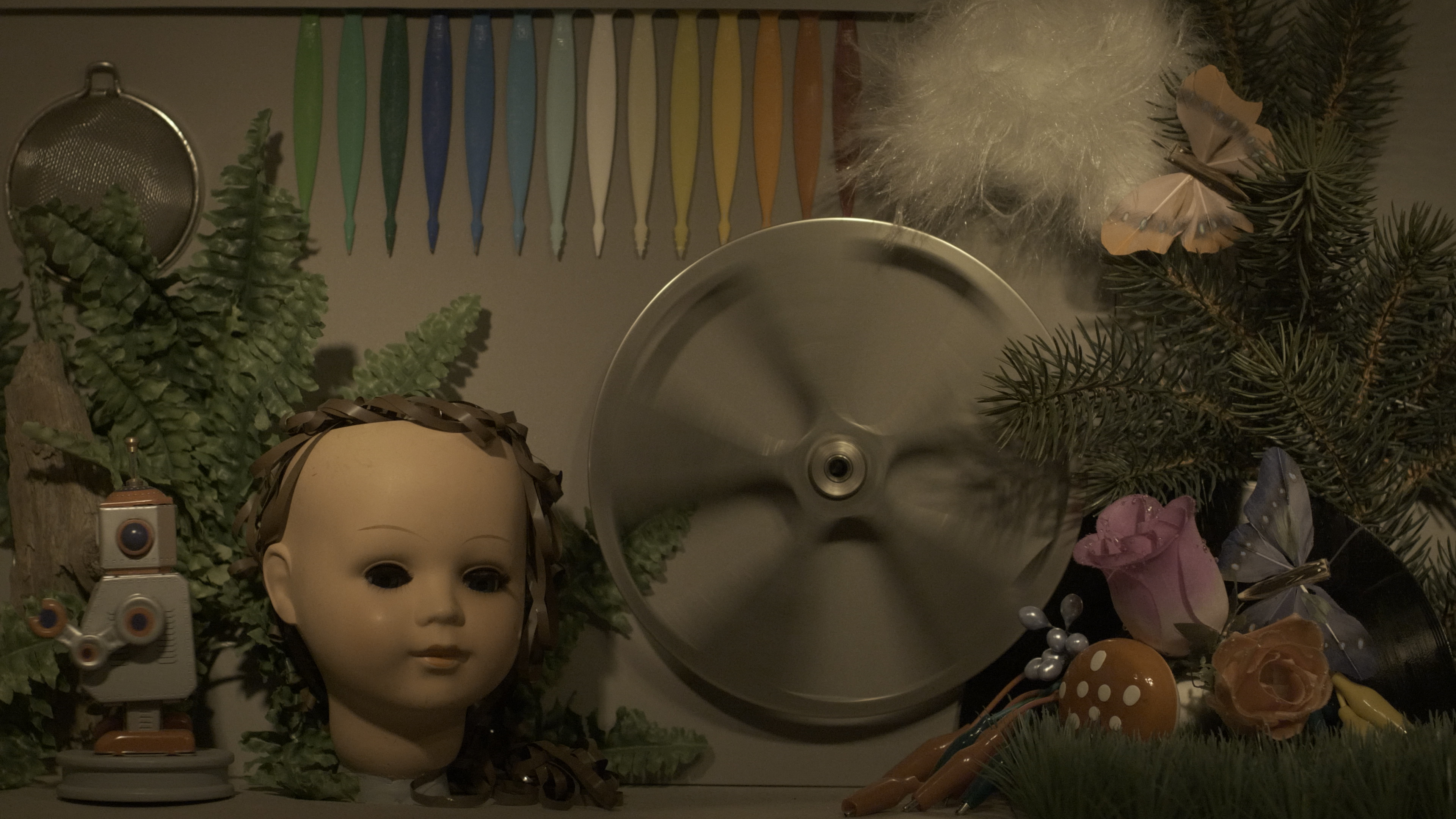

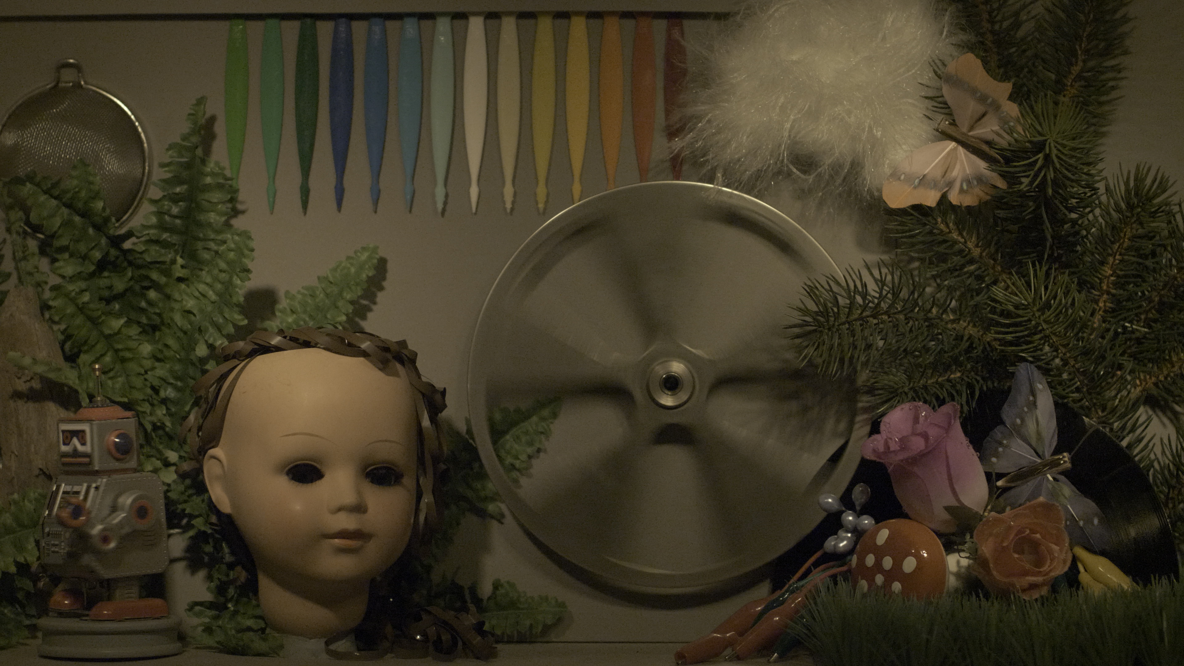

PannySVHS Posted February 6, 2018 Share Posted February 6, 2018 @DBounce I wouldnt write VLOG off. Check this comparison in real low light: GH5s and GH5 compared in VLOG at iso6400, 12LUX!, shutter 1/25, Fstop 2.8: GH5: GH5s Link to comment Share on other sites More sharing options...
DBounce Posted February 6, 2018 Author Share Posted February 6, 2018 10 minutes ago, PannySVHS said: @DBounce I wouldnt write VLOG off. Check this comparison in real low light: GH5s and GH5 compared in VLOG at iso6400, 12LUX!, shutter 1/25, Fstop 2.8: GH5: GH5s I honestly cannot tell any discernible difference comparing these two. But in scenes with a lot of contrast I have to think HGL on the GH5S is going to have the edge. Link to comment Share on other sites More sharing options...
PannySVHS Posted February 6, 2018 Share Posted February 6, 2018 32 minutes ago, DBounce said: I honestly cannot tell any discernible difference comparing these two. But in scenes with a lot of contrast I have to think HGL on the GH5S is going to have the edge. right click and new tab to enlarge both and compare them. it´s a very obvious difference between the two:) Link to comment Share on other sites More sharing options...
DBounce Posted February 6, 2018 Author Share Posted February 6, 2018 6 minutes ago, PannySVHS said: right click and new tab to enlarge both and compare them. it´s a very obvious difference between the two:) I’m on my smartphone, so not sure I’m gonna see it on this tiny screen. What are you seeing? Link to comment Share on other sites More sharing options...
PannySVHS Posted February 6, 2018 Share Posted February 6, 2018 1 hour ago, DBounce said: I’m on my smartphone, so not sure I’m gonna see it on this tiny screen. What are you seeing? That´s how our films should be seen too:) There is a big difference in this super lowlight setup when you enlarge them to original size. Better check it out again on your computer:) Link to comment Share on other sites More sharing options...
DBounce Posted February 6, 2018 Author Share Posted February 6, 2018 5 minutes ago, PannySVHS said: That´s how our films should be seen too:) There is a big difference in this super lowlight setup when you enlarge them to original size. Better check it out again on your computer:) Ok, just viewed it on a 4k monitor... wow, that's night and day. But I think we are not comparing this to HGL. In a high contrast scene, on the same camera (GH5S), I think HGL will prove superior. Granted, I did not realize how much color noise there was in the GH5's image at 6400 ISO, I just knew it always looked like garbage to me, so I never used it. Heck, I had my ISO lock to a maximum of 1600 on the GH5. Link to comment Share on other sites More sharing options...

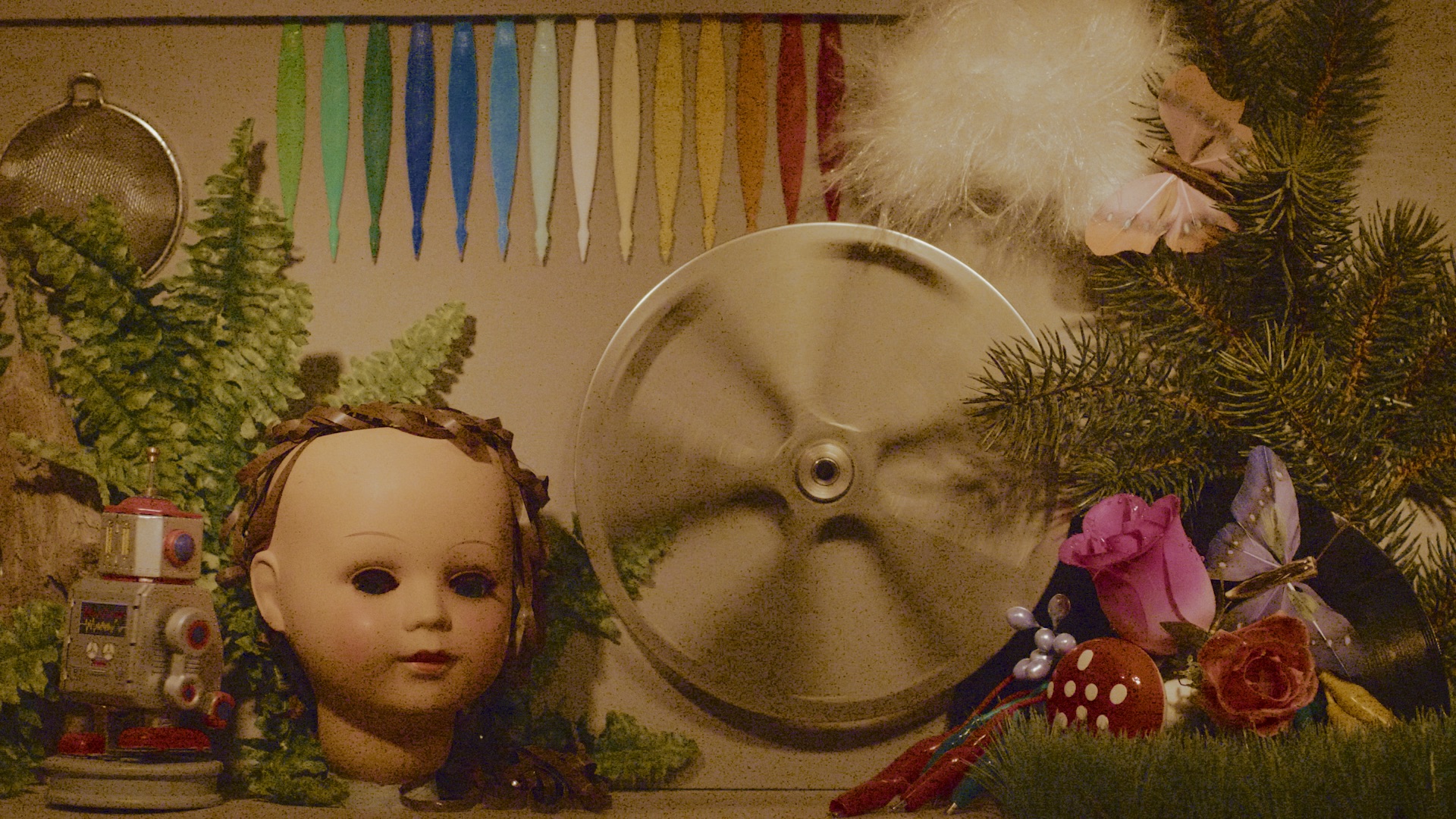

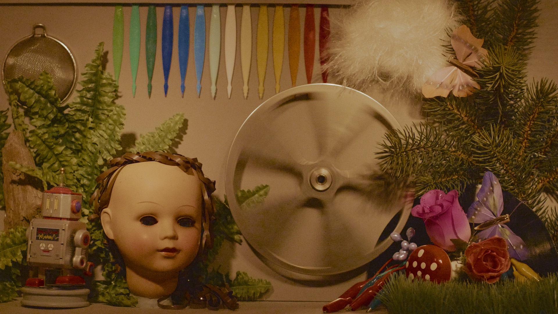

PannySVHS Posted February 6, 2018 Share Posted February 6, 2018 GH5s is a legit iso 6400 camera, without artefacts and Super Nintendo blocks and blotches of a Sony A6300/6500 in LOG mode. Giving a really usuable image at that sensitivity. Here is the HLG comparison between the GH5 and its S sister. Again 12Lux, iso6400, 25th shutter, F2.8 GH5 GH5s Link to comment Share on other sites More sharing options...
DBounce Posted February 6, 2018 Author Share Posted February 6, 2018 Well honestly, HLG makes a big difference on the GH5 also. But comparing the GH5S VLog-L to HGL, I am still going to give the win to HGL. What do you think? 15 minutes ago, PannySVHS said: GH5s is a legit iso 6400 camera, without artefacts and Super Nintendo blocks and blotches of a Sony A6300/6500 in LOG mode. Giving a really usuable image at that sensitivity. Here is the HLG comparison between the GH5 and its S sister. Again 12Lux, iso6400, 25th shutter, F2.8 GH5 GH5s Link to comment Share on other sites More sharing options...
