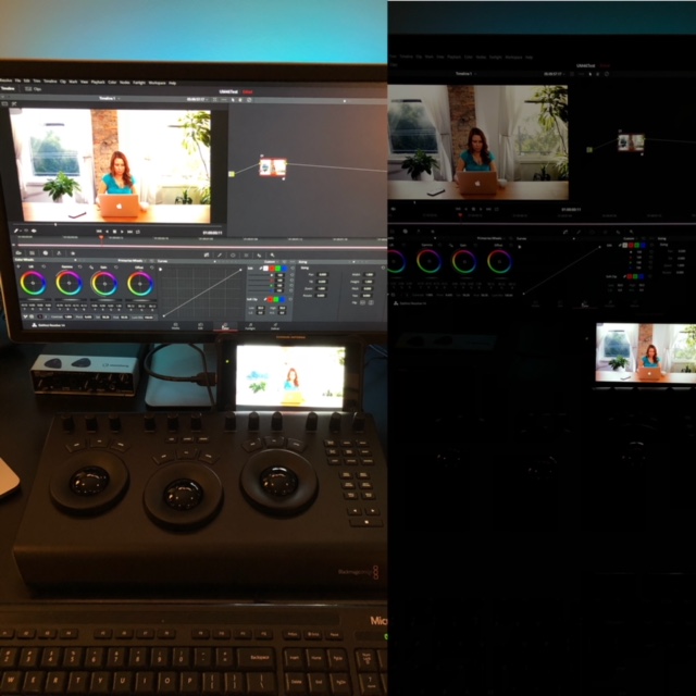

AaronChicago Posted February 14, 2018 Share Posted February 14, 2018 I got the Decklink and hooked up the Inferno. Holy shit there's a night and day difference in NITs and shadow/highlight detail. I'm a little bit worried about using the HDR monitor as a reference until I start delivering in HDR. Georgios, jonpais and Adept 3 Quote Link to comment Share on other sites More sharing options...
jonpais Posted February 14, 2018 Share Posted February 14, 2018 33 minutes ago, AaronChicago said: I got the Decklink and hooked up the Inferno. Holy shit there's a night and day difference in NITs and shadow/highlight detail. I'm a little bit worried about using the HDR monitor as a reference until I start delivering in HDR. I just heard back from Atomos this afternoon. The HDMI port on the UltraStudio Mini Monitor won’t work with the Ninja Inferno, but apparently it will with the SDI connectors on the Shogun. The relatively inexpensive AJA T-TAP should also work, but only with Premiere and Final Cut - not Resolve. The high end 4K i/o devices should work as well, but cost thousands of dollars, and we don’t need the 4K or HDMI metadata to grade with the Inferno. Are you using the Shogun or the Ninja? And which DeckLink are you using? Quote Link to comment Share on other sites More sharing options...
AaronChicago Posted February 14, 2018 Share Posted February 14, 2018 @jonpais I'm using the Shogun Inferno. Decklink Mini 4k. Right now I have HDMI running from the Decklink to the monitor. jonpais 1 Quote Link to comment Share on other sites More sharing options...

jonpais Posted February 15, 2018 Share Posted February 15, 2018 @AaronChicago What monitor are you using? How many nits? Quote Link to comment Share on other sites More sharing options...
AaronChicago Posted February 15, 2018 Share Posted February 15, 2018 Dell 27" 4K IPS, I believe it's 350 nits. Quote Link to comment Share on other sites More sharing options...
