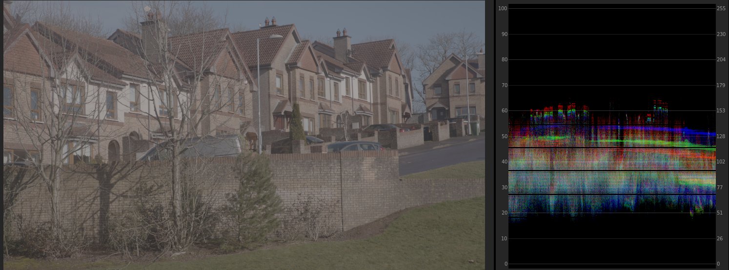

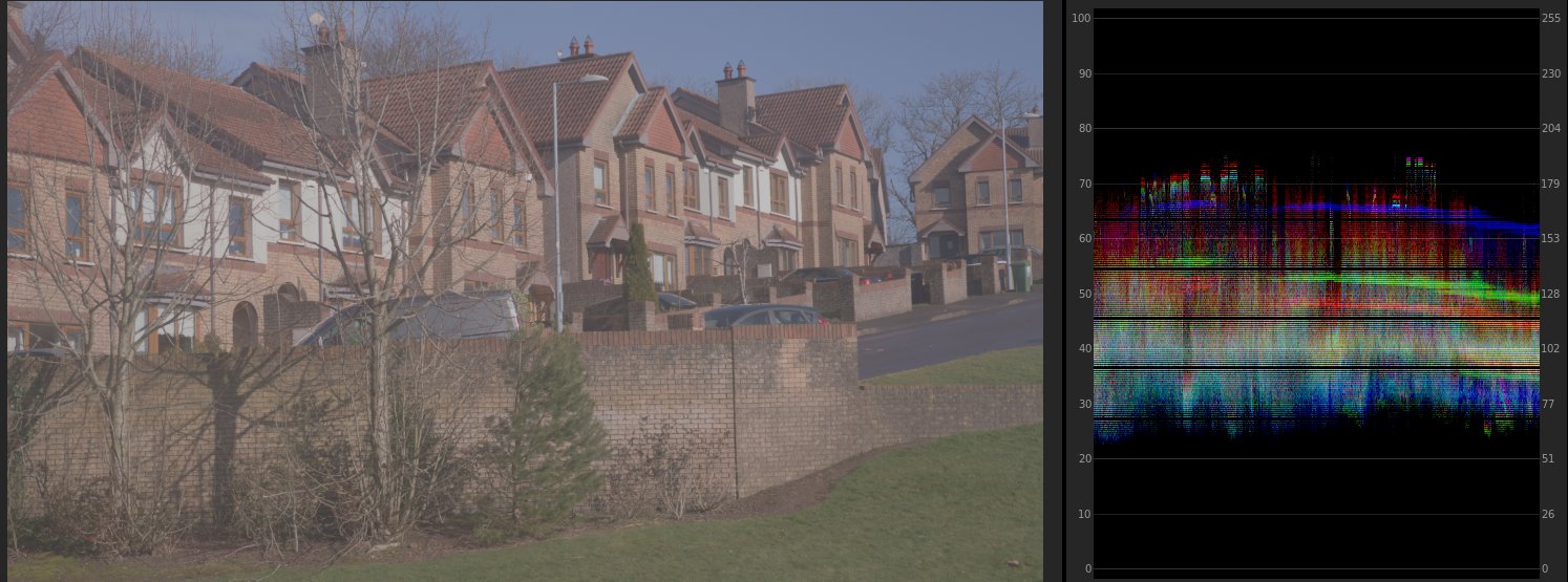

hyalinejim Posted February 11, 2018 Share Posted February 11, 2018 There's a world of options when it comes to ML post. I just want to point out some things here that might be useful when you have time to investigate them. Check out MLVFS to quickly turn your MLVs into DNGs without transcoding. Then you can try workflows that have better image quality. These are Camera RAW to AE (slow but excellent) and Resolve (fast and good). For example, these screengrabs show highlight recovery is worst using MLVs directly in Premiere: Premiere: Camera RAW (ML-Log DCP profile) to After Effects: Resolve (Arri Log-C): Link to comment Share on other sites More sharing options...

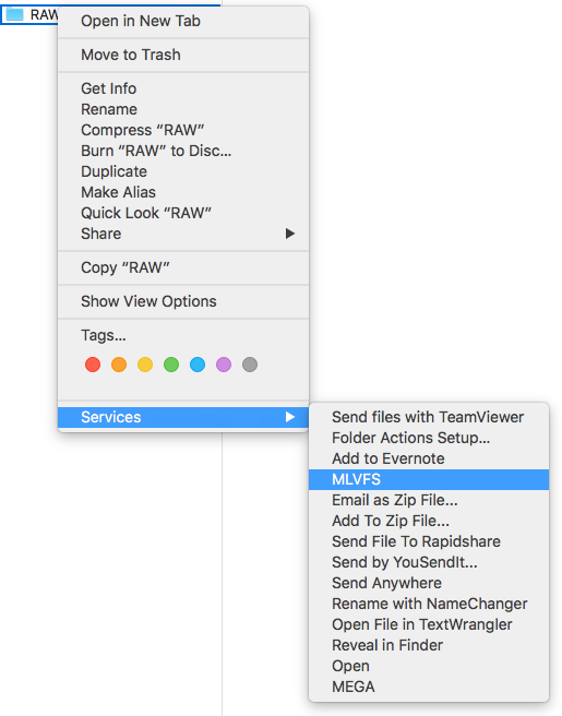

mercer Posted February 11, 2018 Share Posted February 11, 2018 51 minutes ago, hyalinejim said: The advantage of MLVFS is it just mounts a virtual directory of DNGs straight from the MLVs - no converting is necessary. The disadvantage is that it's almost impossible to figure out how to install it on Windows! I know that at one point in time I followed this video, and it works. But this might be out of date. But I can't remember if I changed things since then. MLVFS still works for my now on Windows 10. I just right click on MLVs and select "Quick Mount" and they mount into DNG folders (if you have a lot it can take quite a while). You won't regret learning Resolve. It's very useful to know it. Do you know anything about the Mac version? I downloaded OSXFuse (or whatever it’s called) and followed the directions but I am not seeing any options for MLV when I right click. I see there may be a script to upload somewhere, but again it seems unclear... but I’m sure it’s me. 1 hour ago, Mark Romero 2 said: Can you clarify what you mean by "regroup clips"? In resolve, you have ripple delete where you cut a clip, click on the empty space AFTER the cut, right click ripple delete, and ALL the following clips on that track will move forward an euqal amount. Is that what you mean? sorry I am not familiar with FCXP. In FCPX, when you cut a clip and then delete the unwanted portion, the gap left in the timeline is instantly and automatically filled by the remainder of the clips in your timeline. It seems your right clip selection sounds what I’m looking for... thanks. Link to comment Share on other sites More sharing options...
Stathman Posted February 11, 2018 Share Posted February 11, 2018 8 minutes ago, mercer said: Do you know anything about the Mac version? I downloaded OSXFuse (or whatever it’s called) and followed the directions but I am not seeing any options for MLV when I right click. I see there may be a script to upload somewhere, but again it seems unclear... but I’m sure it’s me. You should see something like this (attached file) MLVFS option under services. Link to comment Share on other sites More sharing options...
