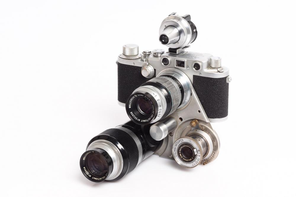

Mmmbeats Posted June 14, 2018 Share Posted June 14, 2018 So this is probably crazy / impossible, but anyway - can anyone think of a way of implementing a system for quick swapping fixed nd's (with the magnetic mounts). I'm thinking of some kind of pouch that sits on the camera cage itself, and allows for a one-handed swap in a matter of seconds?!?!? Link to comment Share on other sites More sharing options...
Phil A Posted June 14, 2018 Share Posted June 14, 2018 Another alternative to using fixed NDs as screw ins (maybe with the overpriced Xume adapters) is to use a filter system like landscape photographers use (e.g. Formatt HiTech, Lee, etc.). You put the adapter ring on the lens and then the filter holder gets just put on and locked with a screw. The holder can, depending on type, hold multiple square resin/glass filters. You can just slide them in and out and you can combine anything, e.g. NDs, Graduated NDs, BlackProMist, etc. It's a bit bigger but again you only buy the filters and filter-holder once and then get fitting adapter rings for your different lenses. Link to comment Share on other sites More sharing options...
Super Members BTM_Pix Posted June 14, 2018 Super Members Share Posted June 14, 2018 2 hours ago, Mmmbeats said: So this is probably crazy / impossible, but anyway - can anyone think of a way of implementing a system for quick swapping fixed nd's (with the magnetic mounts). I'm thinking of some kind of pouch that sits on the camera cage itself, and allows for a one-handed swap in a matter of seconds?!?!? Thorlabs do this, which might work for you. It takes 5 filters up to 60mm width and you'd just have to rig up some narrow rails for it. Its not cheap but it would do the job https://www.thorlabs.com/newgrouppage9.cfm?objectgroup_id=2805 If you are looking for a cheaper DIY solution then if you used a Cokin (or no name equivalent) system then you could use two graduated NDs like this but, unlike this picture, keep one of them upside down. Lets say that filter 1 is 4ND grad and filter 2 is an 8ND grad What that would let you do is slide filter 1 up and filter 2 down (they'd both at their clear graduation positions so no ND) and then by doing the other permutations of position on the each filter (i.e. one in its clear position and the other in its ND position and then both in their ND position) you'd be able to have the following with a couple of slides and not having to remove them. 0 ND, 4ND, 8ND and 12ND Mmmbeats 1 Link to comment Share on other sites More sharing options...
kye Posted June 14, 2018 Share Posted June 14, 2018 1 hour ago, Mmmbeats said: So this is probably crazy / impossible, but anyway - can anyone think of a way of implementing a system for quick swapping fixed nd's (with the magnetic mounts). I'm thinking of some kind of pouch that sits on the camera cage itself, and allows for a one-handed swap in a matter of seconds?!?!? I'd imagine that the Xume would attach to a magnet pretty well, so if you were to attach a couple of magnets somewhere then you could pull the filter off the lens and stick it on the magnets and install the second one pretty quickly. Of you could just have a kind of holster on a belt or strap somewhere handy. They're very simple to operate, if a little pricey as @Phil A correctly mentioned. Mmmbeats 1 Link to comment Share on other sites More sharing options...
Super Members BTM_Pix Posted June 14, 2018 Super Members Share Posted June 14, 2018 Yeah, I probably should have read the 'magnetic mount' part before offering up solutions to a problem you weren't actually having But if you don't want to have a magnet near your camera to hold them (and I can think of a couple of reasons why I might not want to) then you nowat least have two additional clunky solutions available Mmmbeats 1 Link to comment Share on other sites More sharing options...
fuzzynormal Posted June 15, 2018 Share Posted June 15, 2018 On 2/8/2018 at 2:14 PM, DaveAltizer said: I don’t use them is the way people look with them. It’s two polarizers put together so it’s going to remove those reflections. I've become way too run n gun to NOT use VNR, but this is what I don't like about em. Link to comment Share on other sites More sharing options...
Mmmbeats Posted June 15, 2018 Share Posted June 15, 2018 20 hours ago, BTM_Pix said: Yeah, I probably should have read the 'magnetic mount' part before offering up solutions to a problem you weren't actually having But if you don't want to have a magnet near your camera to hold them (and I can think of a couple of reasons why I might not want to) then you nowat least have two additional clunky solutions available Those are great ideas. That thorlabs device is incredible, and just goes to show that lots of people end up trying to engineer solutions to similar problems. I'd feel way too self-conscious with that hanging off the end of my rig though. Plus 60mm max filter size is too restrictive for me. Link to comment Share on other sites More sharing options...

fuzzynormal Posted June 16, 2018 Share Posted June 16, 2018 On 6/14/2018 at 5:18 AM, BTM_Pix said: I always considered making something similar, but smaller, on the backside of a lens adapter. Or, I also thought it would be fun to design an honest to goodness lens turret. Old school cool and functionality. Which sounds like a good idea, but gets impractical with larger sensors Some Chinese thing came out a few years ago (or maybe it was a kickstarter campaign). You'd slide 52mm ND's into a magnetic slot of the lens adapter. Pop in and out whatever you want behind the lens. All interesting "solutions," but I just really got spoiled with VND. I hate the IQ concessions and flares, but a lot of what I do is captured so fast I have no option for any sort of down time. I accept the negative because of the positives it offers. Funnily enough, and as a contradiction, I almost always refuse to shoot with variable lenses. I stick to my primes. Although, full disclosure, I do tend to pick one focal length and shoot the entire project with it. Link to comment Share on other sites More sharing options...

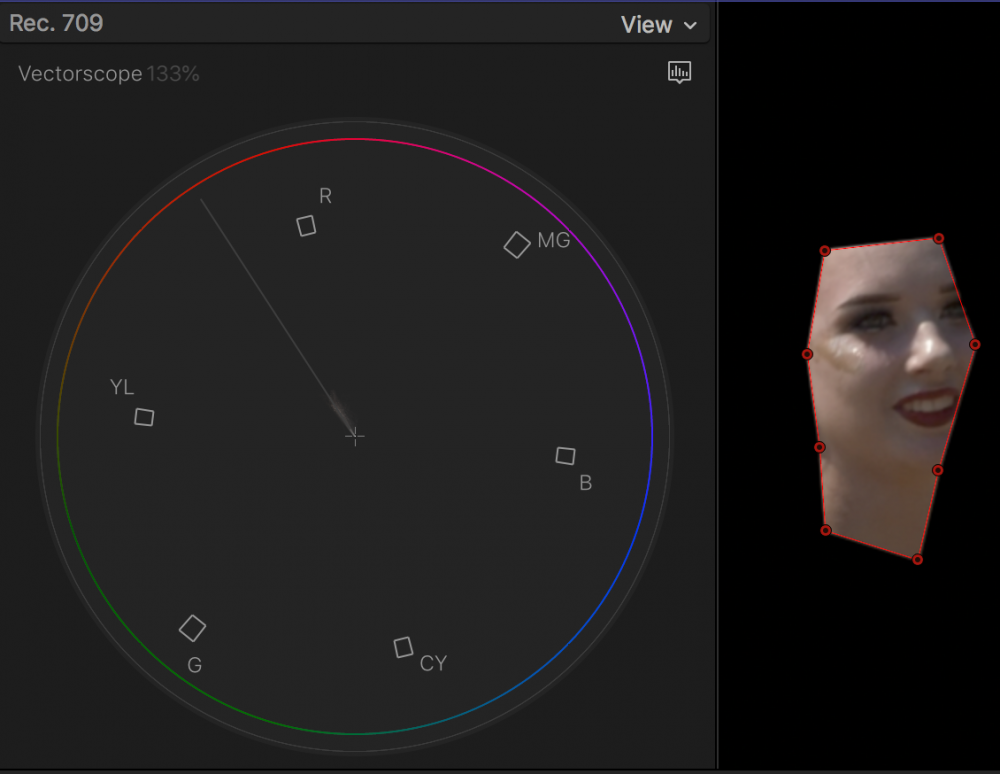

fuzzynormal Posted June 17, 2018 Share Posted June 17, 2018 This is a free video I did for some friends of mine. I used a VND on 90% of the shots. You can easily see the issues it creates. Just the flaring alone is annoying. On the other hand, I shot everything in about 6 hours and had lots of shots to choose from. Which, for these types of low-budget-fast-moving situations, is much better than structured shooting. https://vimeo.com/275498959/9ad0d5cf95 Link to comment Share on other sites More sharing options...
