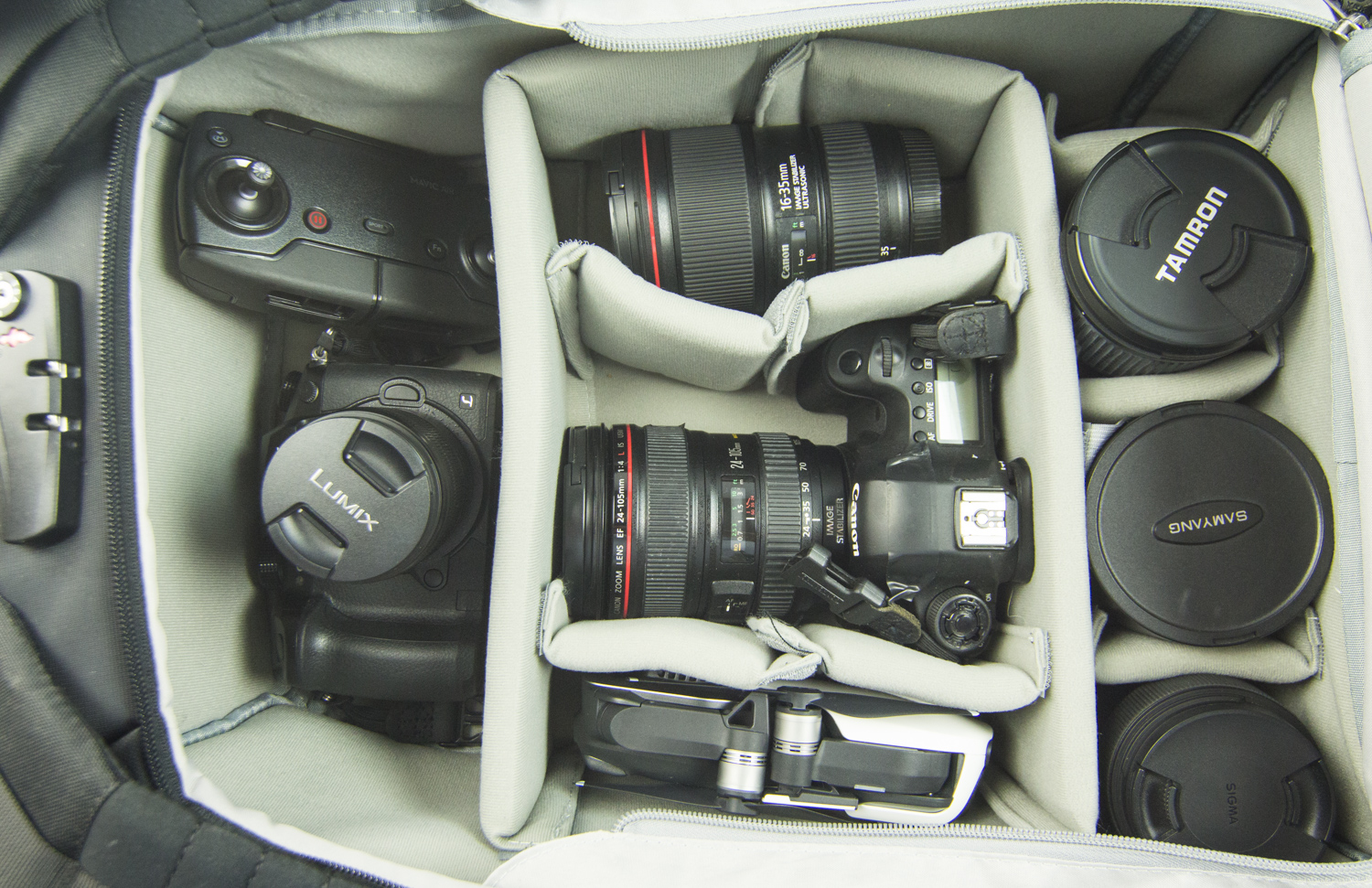

IronFilm Posted February 12, 2018 Share Posted February 12, 2018 On 2/11/2018 at 4:54 AM, OliKMIA said: I need to travel and it will be my "B cam". For practical reasons, I can't take two P4P on this trip. Are you flying two drones at once?? :-o Or is the Mavic there as your back up should anything go wrong with the P4P Link to comment Share on other sites More sharing options...
OliKMIA Posted February 12, 2018 Author Share Posted February 12, 2018 @IronFilm Yes, B as back up. No double drone flight. Link to comment Share on other sites More sharing options...
IronFilm Posted February 13, 2018 Share Posted February 13, 2018 Disappointed, thought you might be an octopus! OliKMIA and Kisaha 2 Link to comment Share on other sites More sharing options...
OliKMIA Posted February 13, 2018 Author Share Posted February 13, 2018 It's that small. The drone is not perfect but with this size, I can live with it. jonpais and EthanAlexander 1 1 Link to comment Share on other sites More sharing options...
Kisaha Posted February 13, 2018 Share Posted February 13, 2018 Where is it? I can't even see it! jonpais, OliKMIA and IronFilm 3 Link to comment Share on other sites More sharing options...
IronFilm Posted February 14, 2018 Share Posted February 14, 2018 I'll admit it took me more than a moment to spot where it was :-/ OliKMIA 1 Link to comment Share on other sites More sharing options...
