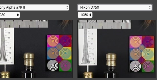

Mark Romero 2 Posted February 26, 2018 Author Share Posted February 26, 2018 Is it too late to add a bonus question? How does the 1080p of the a7R II (either FF or super 35) compare to that of the D750? And for the a7R 2, is there a big difference in quality between 24fps and 30fps? Link to comment Share on other sites More sharing options...

webrunner5 Posted February 26, 2018 Share Posted February 26, 2018 2 hours ago, Mark Romero 2 said: Is it too late to add a bonus question? How does the 1080p of the a7R II (either FF or super 35) compare to that of the D750? From, I don't want to post his name. He sort of got banned not long after this post for selling stuff that sort of ehh. But it has some interesting info in it. Report post Posted January 21, 2016 Lets make a list for FF lovers. I am one. It's a GORGEOUS look for beauty shooting and epic modern narrative work. (Keeping it under 5000$ish bracket) First we have to classify them into two: -Full frame size sensor camera -Mirrorless S35 camera can take Metabones Speedbooster EF converter 1- Full frame cameras -Sony A7s and A7sII -Sony A7rII -Canon 5D MKIII (ML) -Nikon D750 and D810 -Canon 1DC (1.25x crop) 2- S35 mirrorless cameras -Sony A6000 + SB -Sony A5100 + SB -Sony A7rII (explanation later!) + SB 1- First the FF cameras. Sony: The A7s series have a 12 megapixel FF sensor, with 1:1 native 4K crop and easy 1080p downsample A7rII has a 42 megapixel sensor, so has to o a lot of pixel-binning/line-skipping to reach 4K or HD. In S35 mode, it uses a 15mp portion of the sensor and thus easily makes a 4K downsample. What does that mean: A7s has an extremely clean non-binned FF image (HD on the A7s and 4K on the A7sII) A7rII has worse binned slightly aliased FF image (4K&HD), BUT has a very clean s35 cop mode (4K), That's the reason the A7rII is included in the second s35 SB segment, because you treat it as a s35 4K camera + SB and get a very clean EF-mount FF camera. How does an A7rII + SB-EF image compare to A7SII FF + dummy EF mount using sme lens? Pretty close. A7sII having an advantage in super high ISOs, and has S-Log3 mode + can get the FF look with e-mount or any lenses not just the mounts that come with a SB. Conclusion, best Sony in A7 series for FF shooting is A7s/A7sII. But A7rII can shoot a bit compromised FF too if one needs its 42mp stills. Canon: 5D MKIII (raw) has a 21mp sensor that does a very clean HD binning-downsample, reserving resoution similar to A7s HD (pretty sharp HD), The advantage with the 5D is that it's a 14bit uncompressed raw colour data vs heavily compressd 8bit 4:2:0 with hugely better colour appeal and thickness in the image. It's an overally better FF HD than the A7 series can achieve EXCEPT: it's not as clean at high ISOs. Doesn't have an EVF (need a loup), bigger/heavier files and a fixed LCD. But has a better UI, buttons, menus, video aids, ruggedness etc. 1DC: while not a FFF (full full-frame) i's pretty close in aesthetic to FF (just 1.25x crop). Vs the 5D it has higher resolution 4K, smaller files that are still not very compressed, C-log gamma encoding and a leaner/sharper 1.2x HD HDMI output. It's also fully resistant to the world. The 5D still has thicker colours, better kin and gradients at HD raw. Plus smaller and lower cost. Nikon: D810 and D750 both have a solid FF HD image. Slightly lower resolution than a7s/5D HD but very close and with post sharpening pretty similar. Ther's no alisaing/moire, much less rolling shutter than a7s/1DC FF, pretty colours straight off the card that need minimal grading and still yet remarkeably small files and solid high ISO performce. Great ergonomics/buttons/UI/speed. Compared to a7s it loses the EVF (need a loup), ISO performance and 4K capability, ability to adapt to all glass (but gets a more solid/ronomic ody, better/easier colours, large lens lineup with VR/AF native). The D750 is the best no-fuss FF aesthetic camera on the list. No haking/raw data, no Davinci grading wars/overheating/rolling shutter), just easy good enough FF HD. Solid. D810 loses tilty screen and adds 36mp stills and slightly stronger body and a good non-aliased s35 mode. 2- S35 Cameras with SB -The A7rII S35 4K + SB has een discussed earlier. -A6000 is the main contender here: if you want the cheapest best FF video camera, A6000 + EF-SB is that. It has a good 1080p image (good resolution), an EVF, small size, and with FF EF/Nikon/m42 glass it's a FF HD camera. Yes not as high of IQ as the higher-end models especially in ISO perormnce (a7s) or Colour (5D), but it's a lot cheaper and offers that good clean, FF HD image at lowest cost. -A5100 is even cheaper with no EVF recap Q&A -Only need HD FF looking for absolute best image and can handle any downsides? 5DIII -Need 4K FF looking for absolute best image and can handle any downsides? 1DC -Only need HD image and don't want to deal with many downsides (loup/raw data/size) and still get a pretty good similar-ish results to the best (5D raw)? A7s original if you value EVF and amazing high ISO and 4K HDMI, D750 if you value easily graded colours/ergonomics/battery life/stills/rolling shutter/ruggedness -Need 4K image and don't want to deal with many downsides (loup/1dccost/largefiles/size) and still get a pretty good similar-ish results to the best (1DC)? A7sII. (A7rII + SB only if 42mp stills are needed) -Only need HD FF and don't want to pay a lot? A6000 + EF-SB Quote Mark Romero 2 1 Link to comment Share on other sites More sharing options...
Don Kotlos Posted February 26, 2018 Share Posted February 26, 2018 I find the FF HD from A7rII much better than D750 as far as resolution goes. The Sony is almost as good as the oversampled image from A7sII in HD. 24/30 I haven't seen any difference but haven't used the 30p much. Mark Romero 2 1 Link to comment Share on other sites More sharing options...
