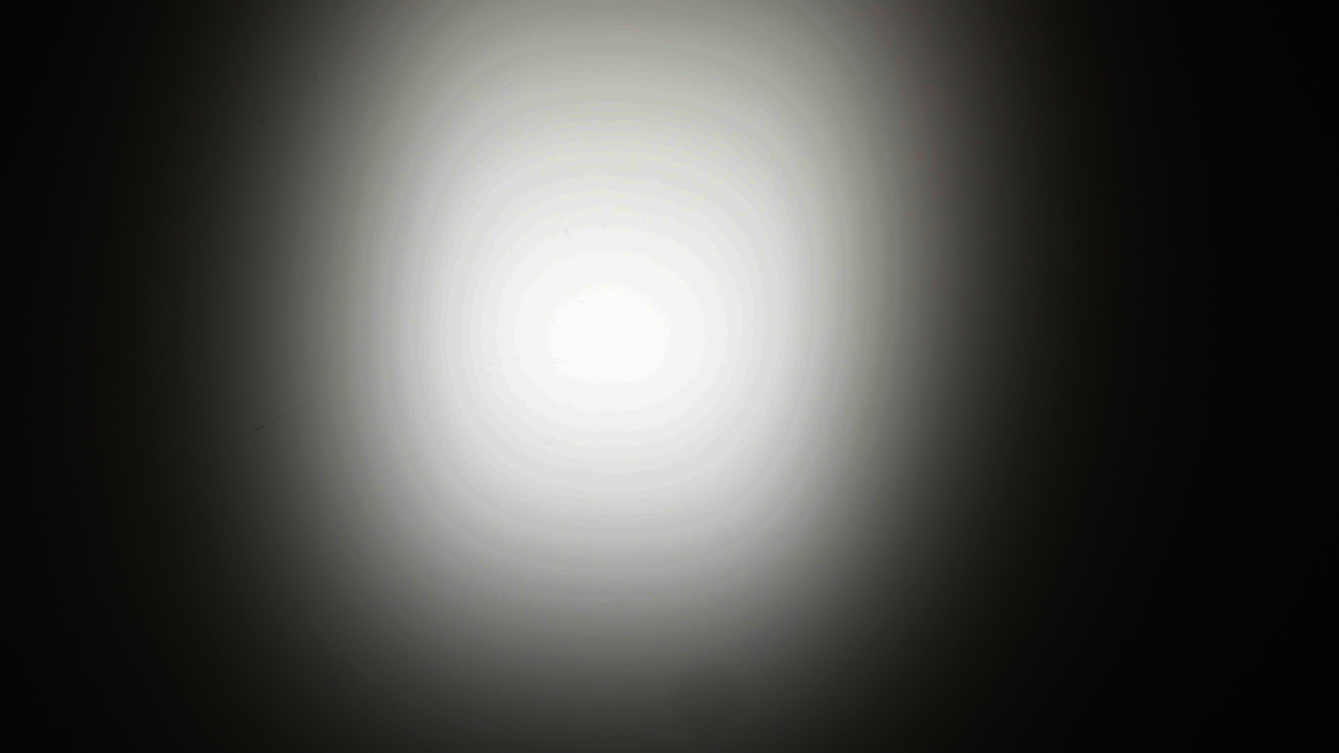

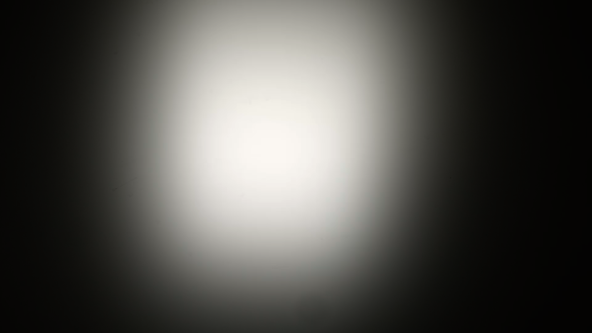

cantsin Posted March 2, 2018 Share Posted March 2, 2018 Okay people, I produced an 8bit and a 10bit reference video file for you to test & settle your dispute. They were produced with a high quality imaging pipeline (2.5K BM Cinema Camera Raw -> Resolve -> Adobe Media Encoder) but encoded in such a way that they represent the difference between 8bit and 10bit video recording in a camera like the GH5 under ideal conditions (i.e. supposing that the video signal processing and internal codecs of the GH5 are as good as the pipeline CinemaDNG -> Resolve -> AME). What I did: Pointed a fresnel spotlight to a white wall so that it created a high-contrast gradient; Shot it with the Blackmagic Cinema Camera 2.5K in CinemaDNG raw, exposed to the right (i.e. with no clipping of the highlights, using the sensor's maximum dynamic range) Imported it into a 1920x1080 project in Davinci Resolve, used Resolve's color space transformation tool to transform the color space to Panasonic VLog. Rendered it out as 16bit uncompressed TIFFs for maximum quality and no loss of color depth. Imported the TIFF sequence into Adobe Media Encoder, and rendered it out as 10bit h264 at 200 Mbit/s. (Note: Unfortunately, I could only use 4:2:0 color sampling because h264's High 10 profile does not support 4:2:2. I also tried ffmpeg/x264, but it doesn't support 10bit 4:2:2 either. Panasonic's own implementation of 10bit 4:2:2 h264 recording in the GH5 is non-standard, causing the well-known NLE compatiblity problems when the camera came out.) 8bit h264 4:2:0 at 200 Mbit/s. Perhaps surprisingly, the 10bit file is much smaller than the 8bit file; I "blame" more efficient compression in the newer h264 high10 profile for this difference. How you can play with the footage: Import it into your NLE Apply a Vlog-to-Rec709 LUT or color space transformation Compare banding of the gradient I did, btw., not do the latter yet because I want to be impartial and let myself surprise by the outcome. gradient_test-8bit_vs_10bit.zip Link to comment Share on other sites More sharing options...
Deadcode Posted March 2, 2018 Share Posted March 2, 2018 21 minutes ago, cantsin said: Okay people, I produced an 8bit and a 10bit reference video file for you to test & settle your dispute. They were produced with a high quality imaging pipeline (2.5K BM Cinema Camera Raw -> Resolve -> Adobe Media Encoder) but encoded in such a way that they represent the difference between 8bit and 10bit video recording in a camera like the GH5 under ideal conditions (i.e. supposing that the video signal processing and internal codecs of the GH5 are as good as the pipeline CinemaDNG -> Resolve -> AME). What I did: Pointed a fresnel spotlight to a white wall so that it created a high-contrast gradient; Shot it with the Blackmagic Cinema Camera 2.5K in CinemaDNG raw, exposed to the right (i.e. with no clipping of the highlights, using the sensor's maximum dynamic range) Imported it into a 1920x1080 project in Davinci Resolve, used Resolve's color space transformation tool to transform the color space to Panasonic VLog. Rendered it out as 16bit uncompressed TIFFs for maximum quality and no loss of color depth. Imported the TIFF sequence into Adobe Media Encoder, and rendered it out as 10bit h264 at 200 Mbit/s. (Note: Unfortunately, I could only use 4:2:0 color sampling because h264's High 10 profile does not support 4:2:2. I also tried ffmpeg/x264, but it doesn't support 10bit 4:2:2 either. Panasonic's own implementation of 10bit 4:2:2 h264 recording in the GH5 is non-standard, causing the well-known NLE compatiblity problems when the camera came out.) 8bit h264 4:2:0 at 200 Mbit/s. Perhaps surprisingly, the 10bit file is much smaller than the 8bit file; I "blame" more efficient compression in the newer h264 high10 profile for this difference. How you can play with the footage: Import it into your NLE Apply a Vlog-to-Rec709 LUT or color space transformation Compare banding of the gradient I did, btw., not do the latter yet because I want to be impartial and let myself surprise by the outcome. gradient_test-8bit_vs_10bit.zip Thank you very much for this test. Could you please upload the original dng sequence to somewhere? Link to comment Share on other sites More sharing options...

Deadcode Posted March 2, 2018 Share Posted March 2, 2018 9 minutes ago, cantsin said: Here's one sample DNG frame - the full 168 MB sequence doesn't make a real difference since it's a static image. Blackmagic Cinema Camera_1_2017-06-21_2318_C0000_000021.dng I did the exact same test with a6300 SLOG2 and it was smooth before/after REC709 correction. On your sample i can see banding on the 8 bit footage, but the bitrate is very low (16Mbps). So i would like to recreate your sequence but with Resolve > ProRes HQ, and 8 bit forced high bitrate reencode from that ProRes to h264. Or maybe i post my footage later Emanuel 1 Link to comment Share on other sites More sharing options...

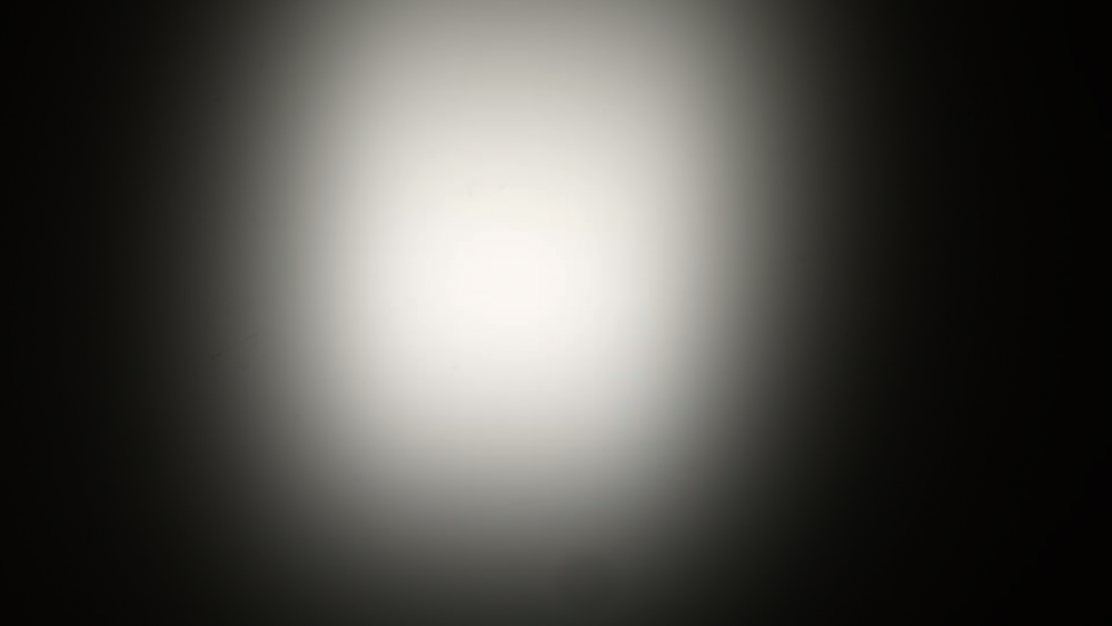

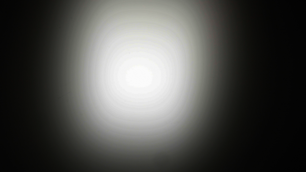

cantsin Posted March 2, 2018 Share Posted March 2, 2018 In the end, I was too curious and just had to test the outcomes myself. Workflow: Imported the two test clips (8bit Vlog and 10bit Vlog 200Mbit h264) into a new 1920x1080 Resolve project; Applied Resolve's "Color Space Transform" tool to convert both clips from VLog to Rec709; no further color correction used. Used the "Grab still" function in Resolve's Color menu to create one still from each of the two clips, exported them as PNGs. The results are attached here. "8bit" and "10bit" only refer to the color depth of the original video file; both stills are 8bit PNGs. 3 minutes ago, Deadcode said: On your sample i can see banding on the 8 bit footage, but the bitrate is very low (16Mbps). So i would like to recreate your sequence but with Resolve > ProRes HQ, and 8 bit forced high bitrate reencode from that ProRes to h264. The bitrate is low because of the static frames/no motion; actually, the bit rate is even much lower for the 10bit file. But I will do another experiment and export high-quality 8bit 4:2:2 DNxHR and transform that. Link to comment Share on other sites More sharing options...
