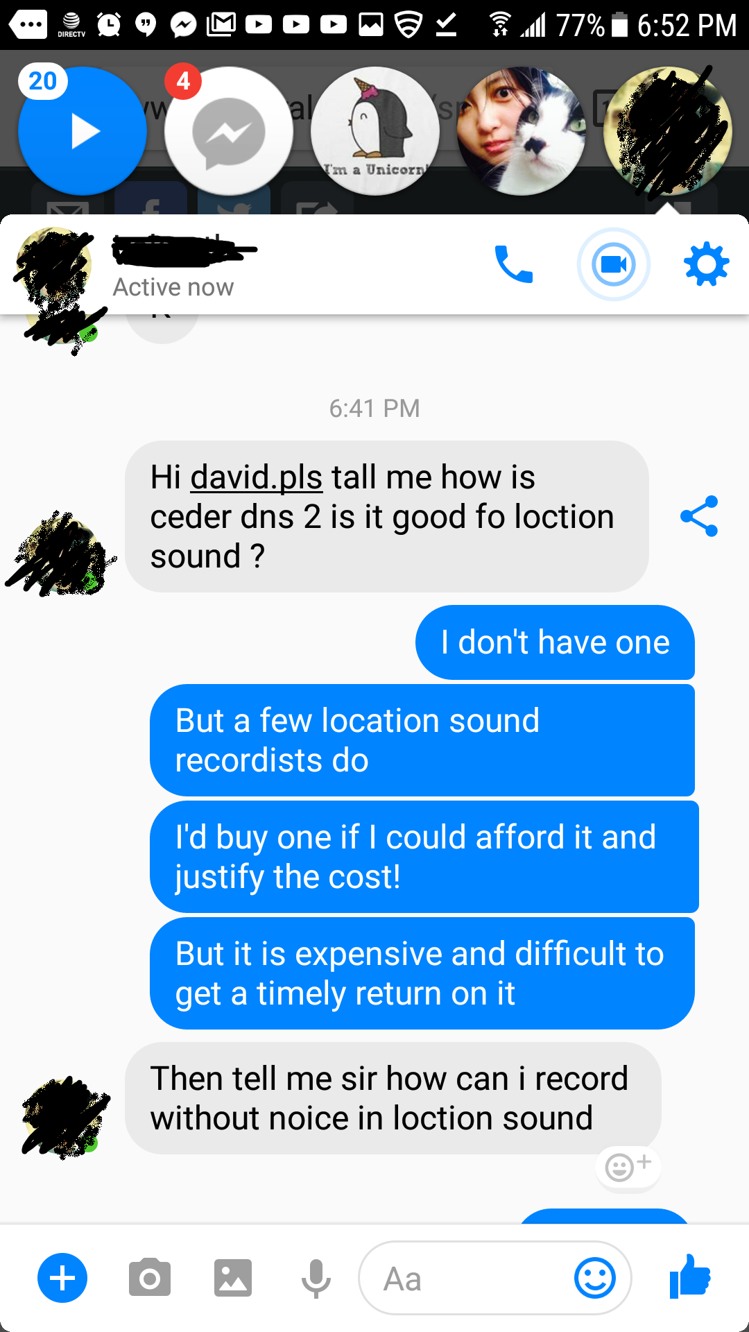

Back onto the topic of Cedar DNS2 again, wellll....  I get sent some odd messages sometimes, I got this just now sent on Facebook:
30173733_10155678221472909_2067607345_o.thumb.png.3f123ac8006f226d289da1e8c0488ed9.png
Sigh.....
