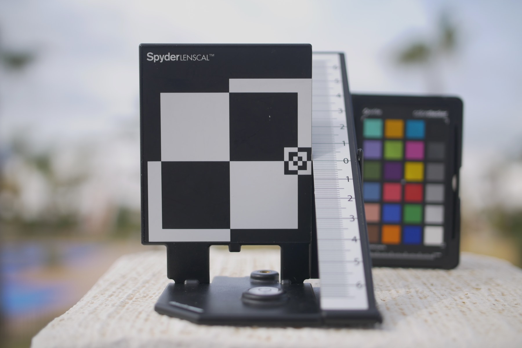

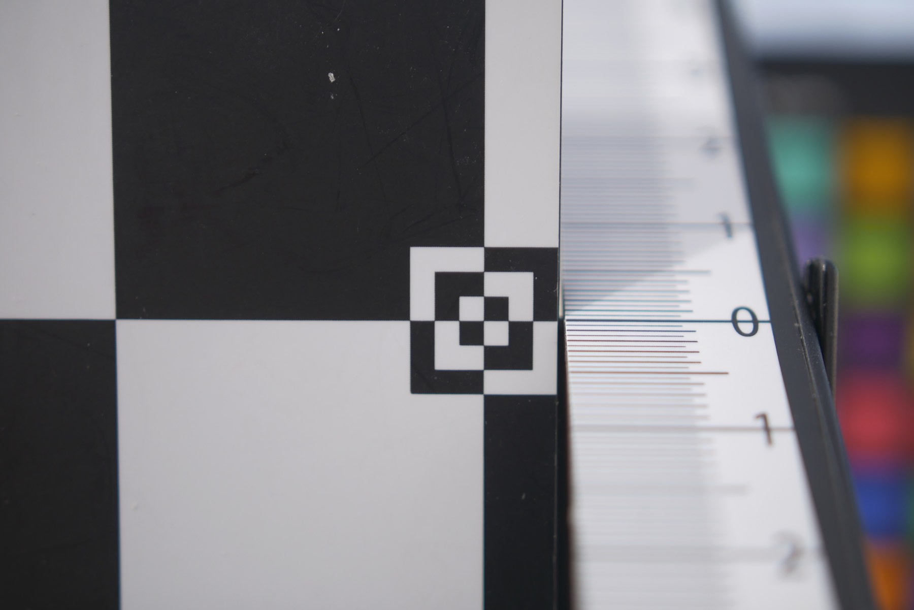

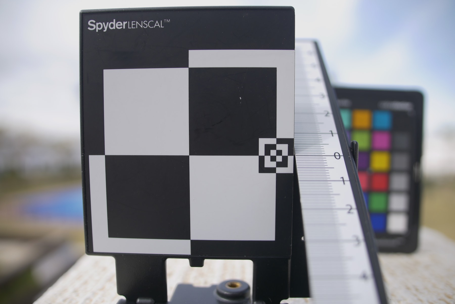

Super Members BTM_Pix Posted March 13, 2018 Super Members Share Posted March 13, 2018 Just to put some meat on the bones (or Metabones in this case) of what you could expect from the Sigma 18-35 in terms of DOF on a Micro4/3 camera when coupled with a speedbooster, I've just gone outside and done this quick test for you with a Panasonic GX80. This is it at its minimum focus distance wide open at 18mm, focused on the 0 of the scale. With the effect of the Speedbooster this is f1.2 at an equivalent FOV of 27mm. This next one is it at its minimum focus distance wide open at 35mm, focused on the 0 of the scale. With the effect of the Speedbooster this is f1.2 at an equivalent FOV of 51mm. And this last one is it at its roughly 2 feet wide open at 18mm, focused on the 0 of the scale. With the effect of the Speedbooster this is f1.2 at an equivalent FOV of 51mm. In all instances, the ColorChecker is 6 inches behind the focus point (i.e. 0 on the Spyder Lenscal) With a roughly 2 inch DOF at this aperture even on a Micro4/3, you might want to stop down a bit for run and gun webrunner5 and Kisaha 2 Link to comment Share on other sites More sharing options...
