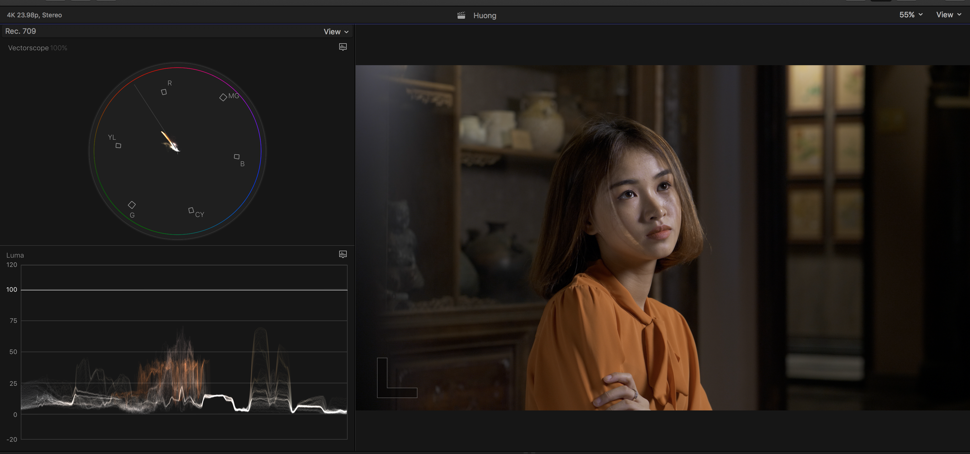

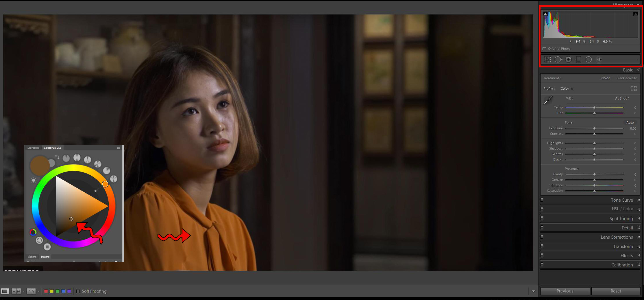

Robert Collins Posted April 4, 2018 Share Posted April 4, 2018 My feeling is that there is an element to which the 'filmic look' gets confused with dynamic range. For instance, we tend to associate 'log' footage with both 'high dynamic range' and the 'filmic look'. Log footage is 'low contrast' and 'low saturation' irrespective of how much dynamic range is actually in the scene. And we associate low contrast and low saturation with a filmic look. If you take a look at Jon's footage, you can see it doesnt contain a lot of stops of dynamic range (see histogram) and even the orange shirt is pretty desaturated (see color wheel). maxmizer, Jimbo, IronFilm and 1 other 3 1 Link to comment Share on other sites More sharing options...

jonpais Posted April 4, 2018 Author Share Posted April 4, 2018 @Robert Collins Correct, I get the same result in Final Cut Pro. The exposure in this shot isn't even taking full advantage of the entire dynamic range of the sensor. Link to comment Share on other sites More sharing options...
