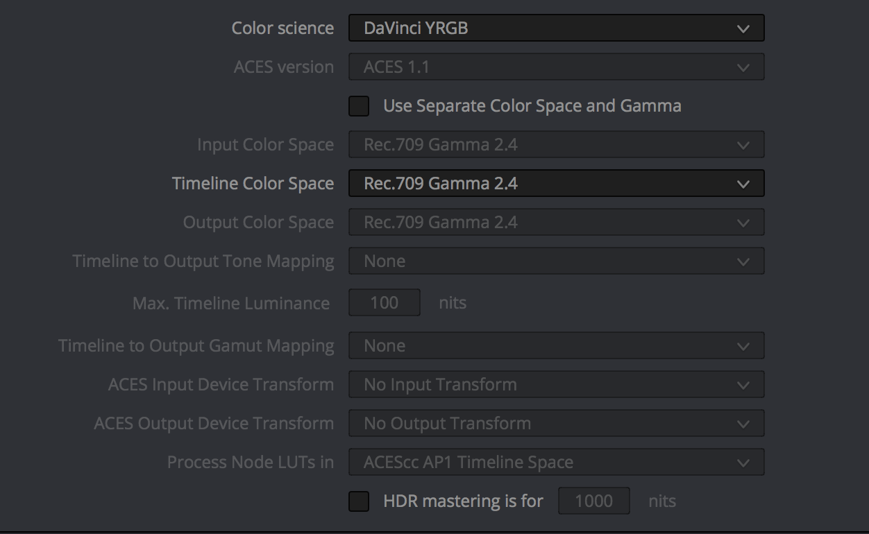

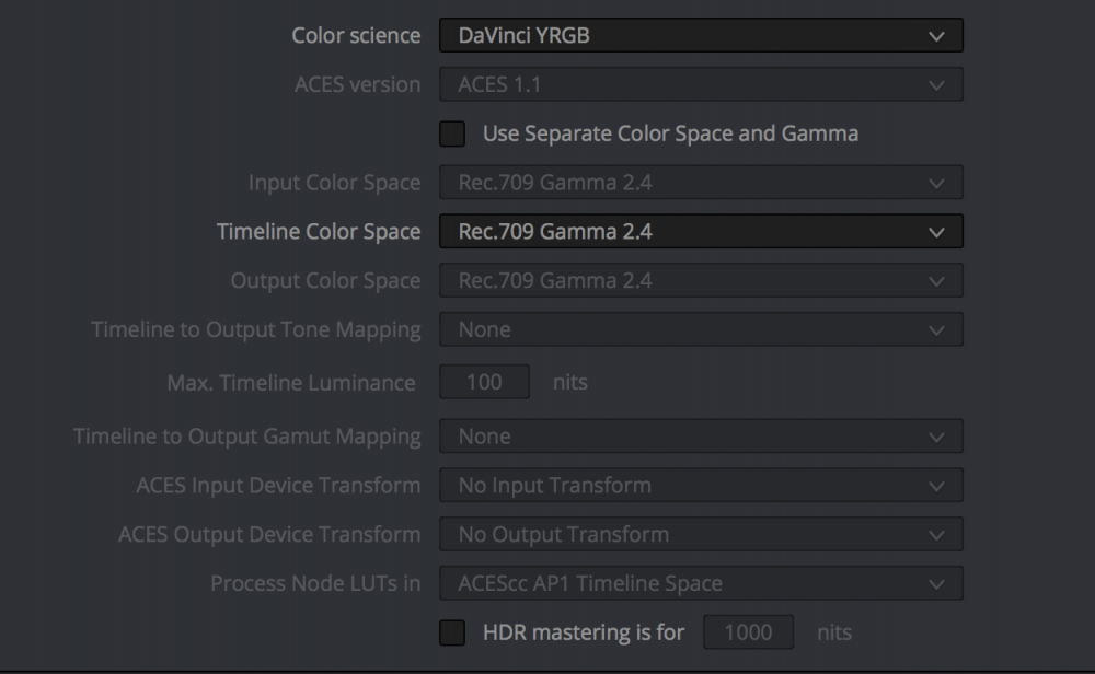

Slothorp Posted October 13, 2018 Share Posted October 13, 2018 58 minutes ago, Emanuel said: Looks some Iscorama glass coupled there. To me, bothers much more that flickering over there which could be corrected with the use of proper shutter speed BTW : ) Aside the dichotomy 50Hz vs 60Hz for 25/50/100 or 24/60/120 fps, respectively. Some guys on facebook prefer to concentrate upon the flickering (which was just a 50hz/60 p issue that I wanted to check) or the anamorphic effect to the image. But they don't wan to see the red clipping. The settings : Link to comment Share on other sites More sharing options...
Anaconda_ Posted October 13, 2018 Share Posted October 13, 2018 3 minutes ago, Slothorp said: prefer to concentrate upon the flickering (which was just a 50hz/60 p issue that I wanted to check) or the anamorphic effect to the image. But they don't wan to see the red clipping. That's because the flickering is much more distracting than the red lights. If you didn't mention it, I wouldn't have noticed. Red light is hot on basically every camera I've used, especially when there's less light around it like in this shot. For me in this night scene, the red isn't a problem at all. Link to comment Share on other sites More sharing options...
Slothorp Posted October 13, 2018 Share Posted October 13, 2018 Well, i find the reds very disturbing. And I can't imagine how it is on a big screen... Link to comment Share on other sites More sharing options...
deezid Posted October 13, 2018 Share Posted October 13, 2018 3 minutes ago, Anaconda_ said: That's because the flickering is much more distracting than the red lights. If you didn't mention it, I wouldn't have noticed. Red light is hot on basically every camera I've used, especially when there's less light around it like in this shot. For me in this night scene, the red isn't a problem at all. The red clipping in this example looks terrible. I wonder if it's in the RAW or ProRes file. Really weird. First time I've seen it on this camera. Looks more like an ACES issue I ran into using Pocket 4K footage before. Link to comment Share on other sites More sharing options...
