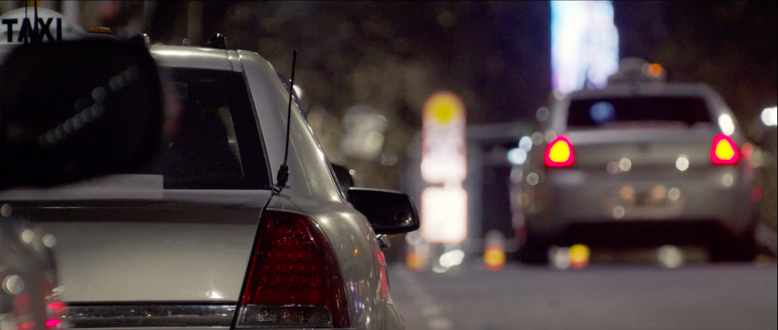

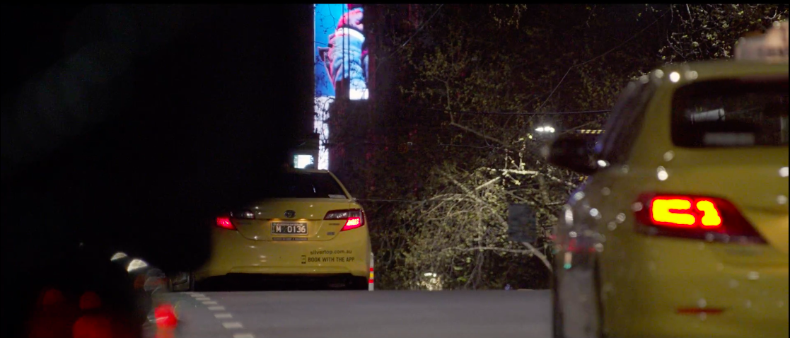

TurboRat Posted October 16, 2018 Share Posted October 16, 2018 3 hours ago, Slothorp said: I dit another test with a simple domestic RGB led (hence the flickering) to show how the BMPCC4K reacts in the red channel, both in raw and prores. With other colors, when overexposed, there is a gentle roll-off, but in the red, it clips with a very harsh way, and a strange color shifting. There is also much more noise in the reds. Yeah I think I saw some night shots with the red lights on the cars clipping but didn't see the noise. On your test the sudden noise was quite distracting. Hope Blackmagic addresses this Looks like the stronger red lights have a tendency to get clipped: https://www.youtube.com/watch?v=54153YyAUVY Link to comment Share on other sites More sharing options...
