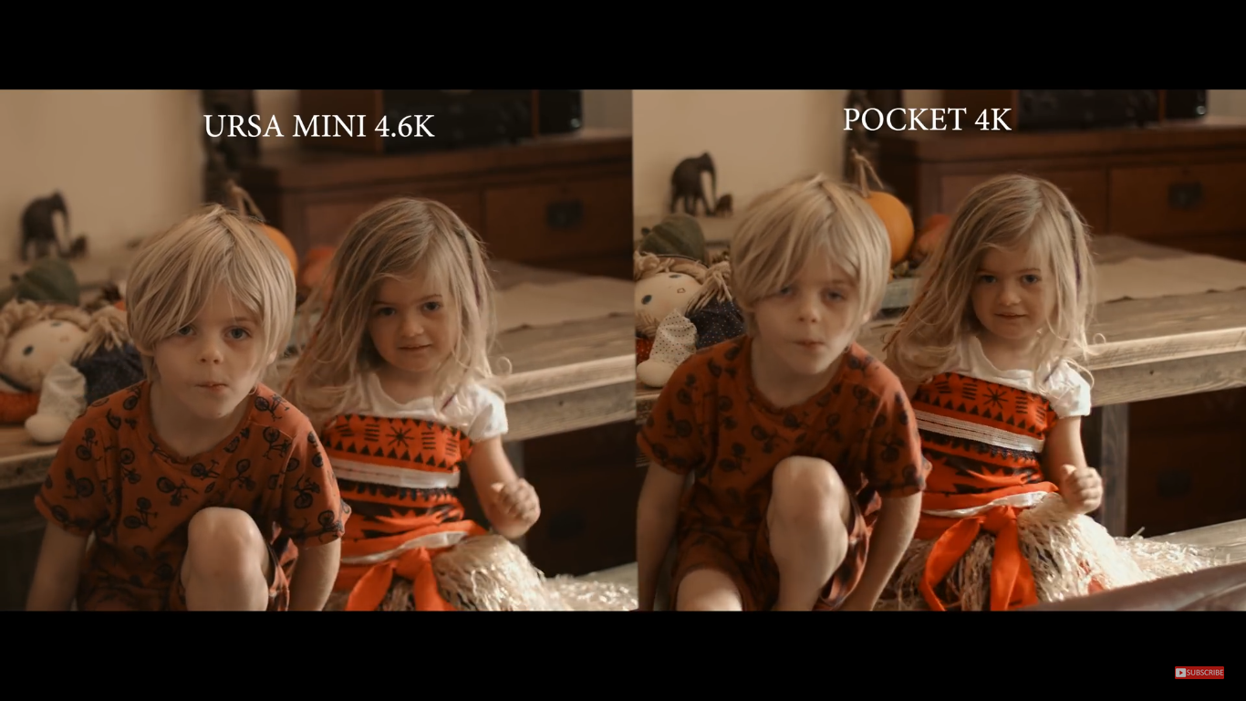

BenEricson Posted October 29, 2018 Share Posted October 29, 2018 1 hour ago, Emanuel said: And an interesting match... : -) Looks amazing until you clip the highlights. Link to comment Share on other sites More sharing options...
Emanuel Posted October 29, 2018 Share Posted October 29, 2018 1 hour ago, BenEricson said: Looks amazing until you clip the highlights. So, don't clip the highlights then... ; ) In a serious note though. ETTR... Expose to the right with this device. You won't get so much noise there from the shadows. Trust me ; -) Other than that, no camera in the world will offer you such Grail : -) shooter and greenscreen 1 1 Link to comment Share on other sites More sharing options...

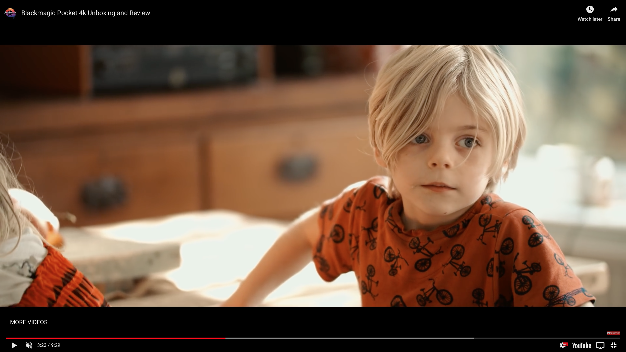

TurboRat Posted October 30, 2018 Share Posted October 30, 2018 2 hours ago, Emanuel said: And an interesting match... : -) I think the kids aged by 50 years on the P4K ? Emanuel and Turboguard 2 Link to comment Share on other sites More sharing options...
thebrothersthre3 Posted October 30, 2018 Share Posted October 30, 2018 33 minutes ago, TurboRat said: I think the kids aged by 50 years on the P4K ? what do you mean? Pretty cool to hear ProRes Dynamic range is improved. I would buy this camera for the prores so its good to hear. Link to comment Share on other sites More sharing options...
Emanuel Posted October 30, 2018 Share Posted October 30, 2018 1 hour ago, thebrothersthre3 said: what do you mean? The Eisensteinian weirdness effect coexists on the simple fact the focus is not over the couple of kids, but behind the boy. Take a look on the puppet on his back. The girl is closer, obviously more focused than the male counterpart. His post is only reflecting all that; poster's reaction. Operator's mistake, not the camera for Christ's sake! : -) Link to comment Share on other sites More sharing options...
MattH Posted October 30, 2018 Share Posted October 30, 2018 1 hour ago, thebrothersthre3 said: what do you mean? I think he just means the boys face looks more goofy in the right image. Link to comment Share on other sites More sharing options...

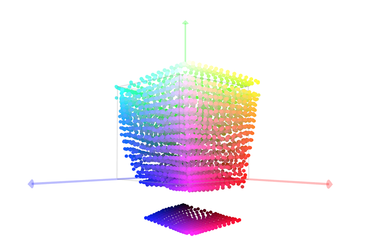

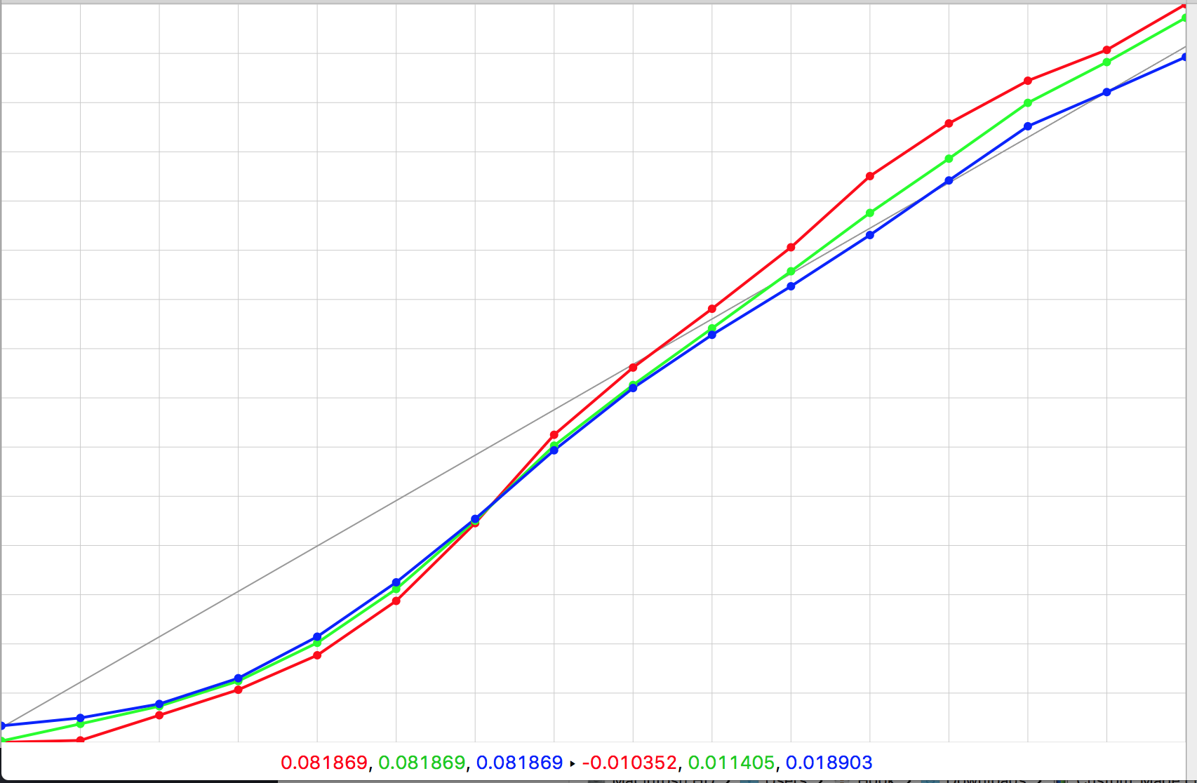

CaptainHook Posted October 30, 2018 Share Posted October 30, 2018 18 hours ago, Anaconda_ said: I've saved my LUT as .cube, like the others I've used, and even saved it in different ways. First just with the burger menu in Lumetri, then using Red Giant's LUT Buddy. As others noted, the camera accepts either 17^3 size cubes, or 33^3 size cubes. Yours is 16^3. I've converted your LUT to 17^3 using Lattice and this should work. Custom_Made_17.cube FYI, i would be careful with your LUT as you can see from the cube visualization there an odd gap at the bottom and the curves are not overly smooth (though I've seen much worse curves). seanzzxx and Anaconda_ 1 1 Link to comment Share on other sites More sharing options...
