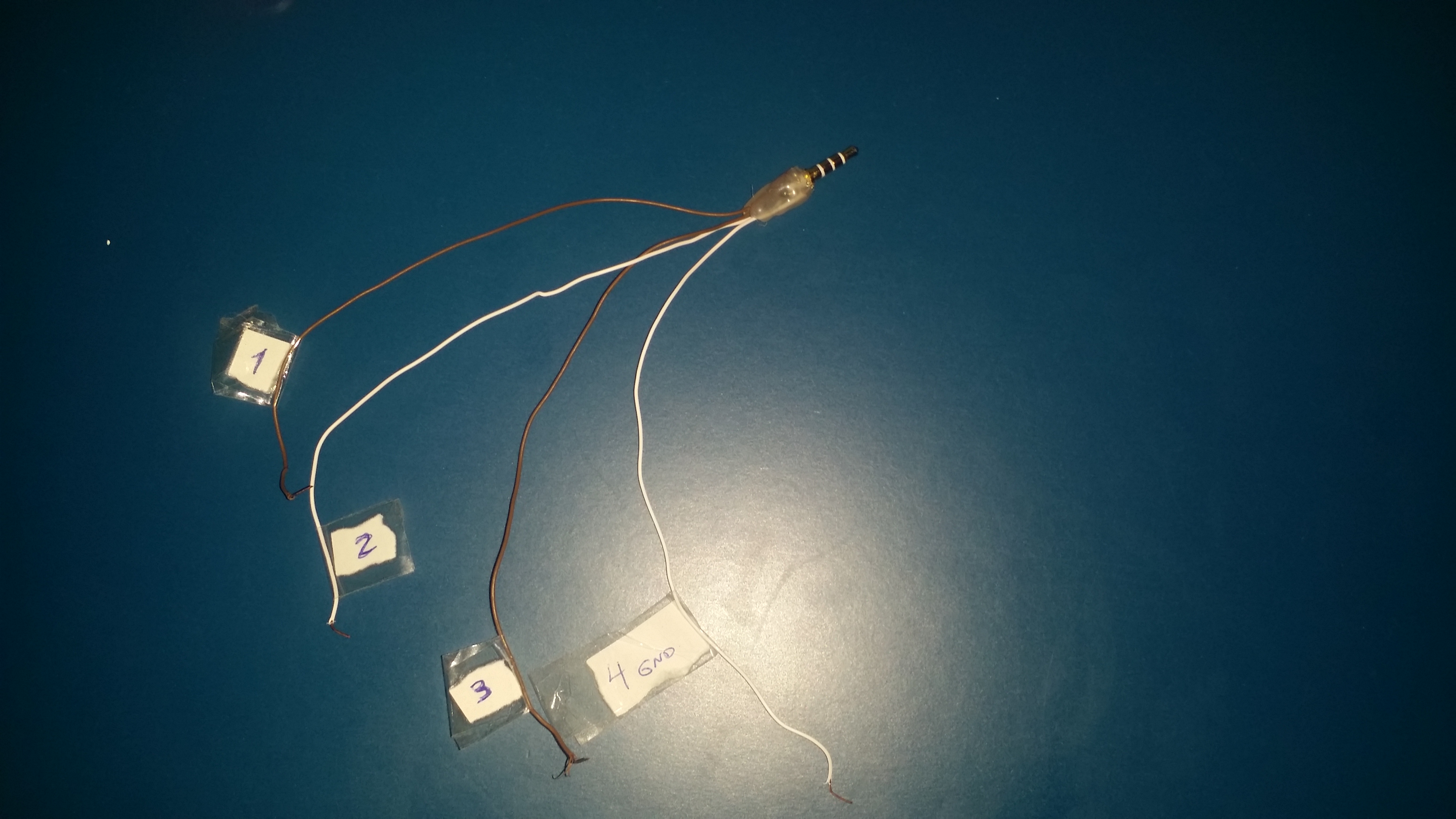

Grimor Posted April 25, 2018 Share Posted April 25, 2018 2 hours ago, BTM_Pix said: Simulating the Marantz RC600 remote would be in order then. Did you use a regular 3 pole 3.5mm plug or a 4 pole as from what I can gather the RC600 uses a 4 pole ? 4 pole 3.5mm, as original one. I keep a photo of my prototipe where pin 1 was inner pin and pin 4 (GND) was the outsider pin of the 3.5mm connector. BTM_Pix 1 Link to comment Share on other sites More sharing options...

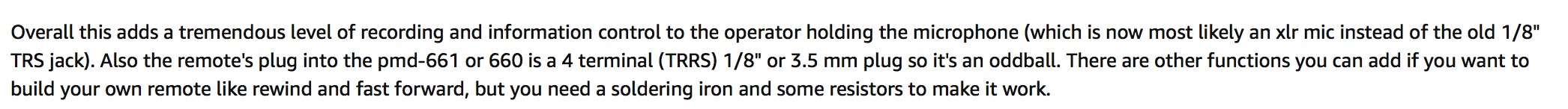

Super Members BTM_Pix Posted April 25, 2018 Author Super Members Share Posted April 25, 2018 6 minutes ago, Grimor said: 4 pole 3.5mm, as original one. I keep a photo of my prototipe where pin 1 was inner pin and pin 4 (GND) was the outsider pin of the 3.5mm connector. Thanks for this. Something caught my eye from an Amazon review of the remote regarding additional functionality which I suspect might give you a clue as to why you can get it to record and pause a recording but not do a full stop. If you add a potentiometer to your circuit you will probably be able to find that missing function Link to comment Share on other sites More sharing options...

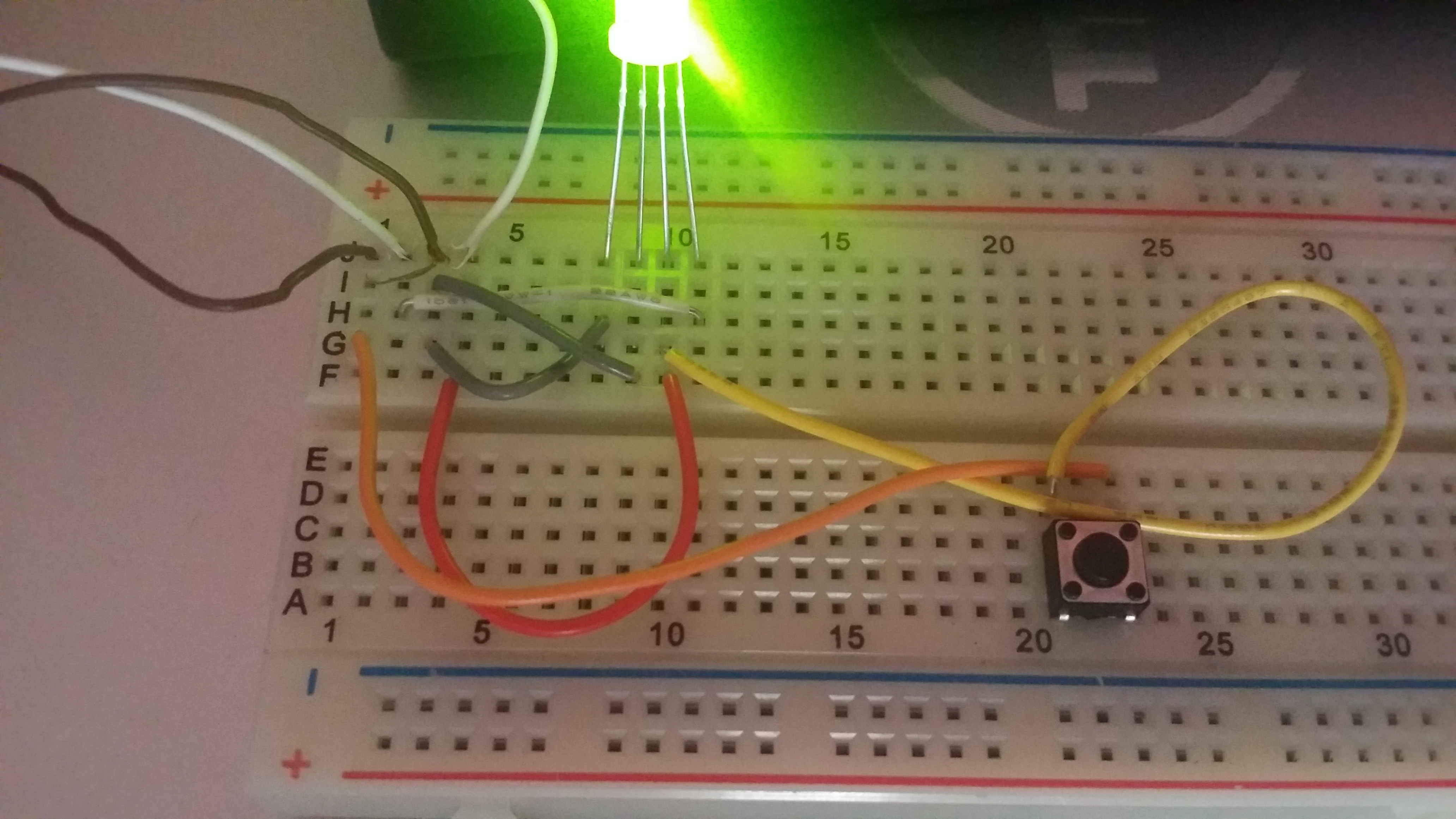

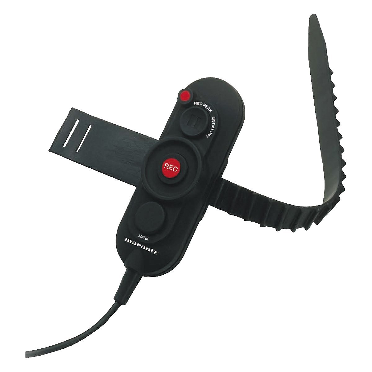

Grimor Posted April 25, 2018 Share Posted April 25, 2018 31 minutes ago, BTM_Pix said: Thanks for this. Something caught my eye from an Amazon review of the remote regarding additional functionality which I suspect might give you a clue as to why you can get it to record and pause a recording but not do a full stop. If you add a potentiometer to your circuit you will probably be able to find that missing function I tried all kind of combination but only with one button. It seen that RC600 has 3 buttons. My led color sign was OK (green for standby, red for recording even peaks blink in orange) But i miss resistor and other 2 buttons. My electronic skill level is: Beginner BTM_Pix 1 Link to comment Share on other sites More sharing options...

Grimor Posted April 25, 2018 Share Posted April 25, 2018 @BTM_Pix Now the same button make different actions with same wiring just with diferent resistor values!! You rock! Many tries/error left tonight. Hope someone own the original remote and can take a picture fron inside, things will be a lot of easier. BTM_Pix 1 Link to comment Share on other sites More sharing options...
