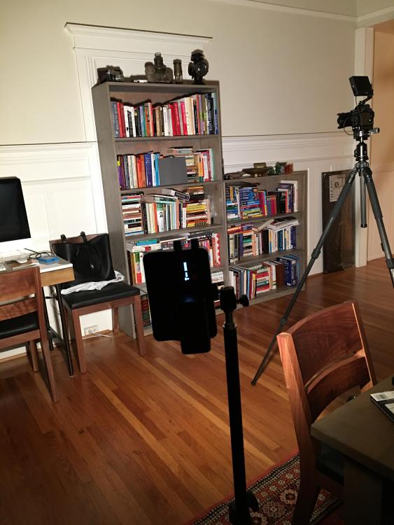

I've been looking to get a set of LED lights that I can travel with (fly around the world) that are versatile, high quality, powerful, not heavy and not too expensive. In this test I was comparing lights that I want to mostly use as a kicker/practical or maybe key (if I need to).
The lights tested are:
Boltzen bi-color 30W (3200k - 5600k), Aputure LS-mini20d (7500 k), Aputure F7 (3200k - 9500k), Luxli Viola (3000k-10000k/RGB)

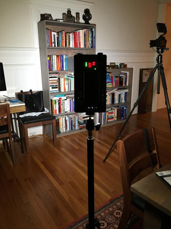

Test methodology: I placed all lights 3 meters from a gray card. I set my camera to center/spot meter at auto ISO. 1/50 and F/4 (this is for my needs) and then I read the iso meter. I repeated the reading a few times to ensure there are no strange anomalies. The Aputure LS-mini20d (7500 k) is lighter than the Boltzen. It has much better spot focus ability. But it has two big issues. Just during this simple testing the fan came out. Not loud but audible. However, more importantly I place the 3200k soft gel inside the slot (I guess the slot was for the 5600k hard gel) and it burned. I heard Kaleb talk about the 5600k gel bleaching. Still makes the LS-mini20d a useable kick/accent light. Since I'm planning to shoot tungsten WB and it will give me a nice shade of blue. But it makes it not as versatile as I had hoped. Otherwise it's a perfect light. The Botlzen on the other hand gives you pretty much the same output in 5600K as well as 3200K. It's more powerful on paper, but not having as good as a spot as the Aputure makes the same power but for more weight. On plus side it has not fan, but it uses a heavy heat sink which is why it's heavier.

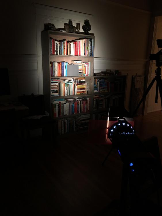

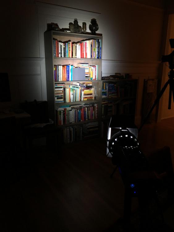

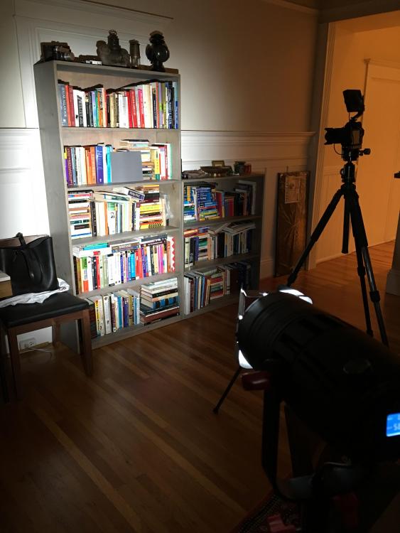

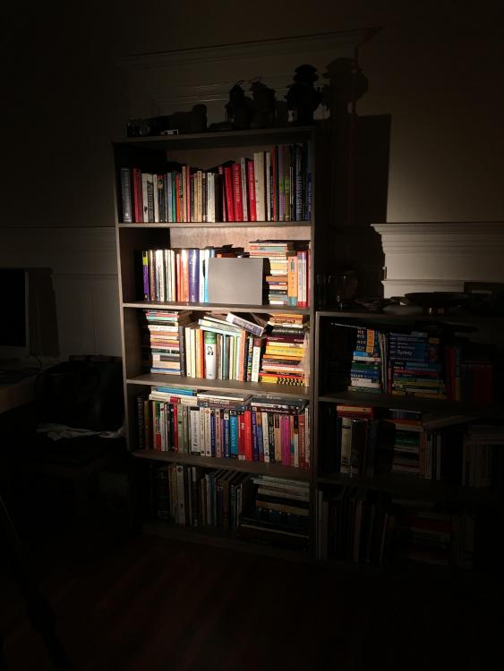

Here are some images of the shape of the light on the bookshelf where I have my gray card
Boltzen full spot
Boltzen flood using the barn doors to shape the light to around the book case
Apurture full spot
Apurture full spot with a 3200k gel on
Apurture F7
Luxli Viola

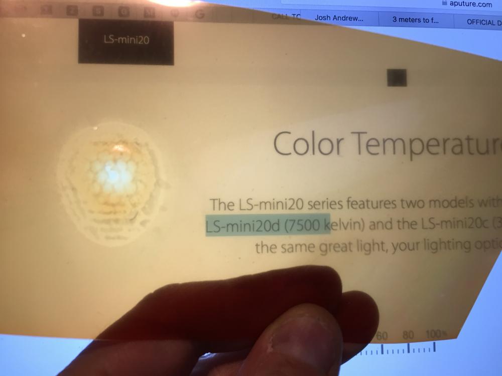

So this was my bad, I put the flexible 3200k conversion gel (this is for the Apurture to convert the 7500K light to 3200k) in the slot where the hard gel goes (the hard gel is to convert the light to 5600k).  I only had get there long enough to do a flood and spot mode a couple of times. Maybe 5 minutes and it practically burnt right away. I'm not sure if the hard gel for the 5600K would do any better or as Kaleb Pike said in his youtube channel they got bleached. I can see that happening. Which really makes this like a 7500k light that you can use as accent/hair light etc.
Perhaps there's a way to rig up a gel that spaces it a bit from the light?  It looked like it only burned in one place and if you can get a few inches between the gel and the light then you'll get a bit of cooling airflow over the gel.
It might be a bit of a PITA but if the light has other advantages maybe it salvages it as an option for some situations?
@kye - It makes a great accent, hair light, kicker, etc. Especially if you're shooting Tungsten as  key and you want a cooler color for separation. It's very light and the spot is cleaner than the Boltzen. Thanks for the thought.
