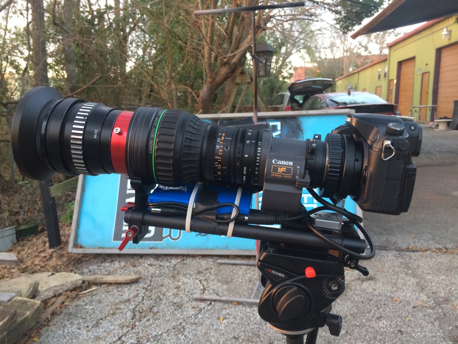

Ian Edward Weir Posted May 22, 2018 Share Posted May 22, 2018 If you like zooms with anamorphic's you might like this Sorry, posted in wrong place. DirectorCH and Teemu 2 Link to comment Share on other sites More sharing options...
Teemu Posted May 22, 2018 Share Posted May 22, 2018 5 minutes ago, Ian Edward Weir said: If you like zooms with anamorphic's you might like this Really cool! Can you also make really fast zoom changes with that setup? This is something I would like to try out. Link to comment Share on other sites More sharing options...
Ian Edward Weir Posted May 22, 2018 Share Posted May 22, 2018 2 minutes ago, Teemu said: Really cool! Can you also make really fast zoom changes with that setup? This is something I would like to try out. Yes Link to comment Share on other sites More sharing options...
