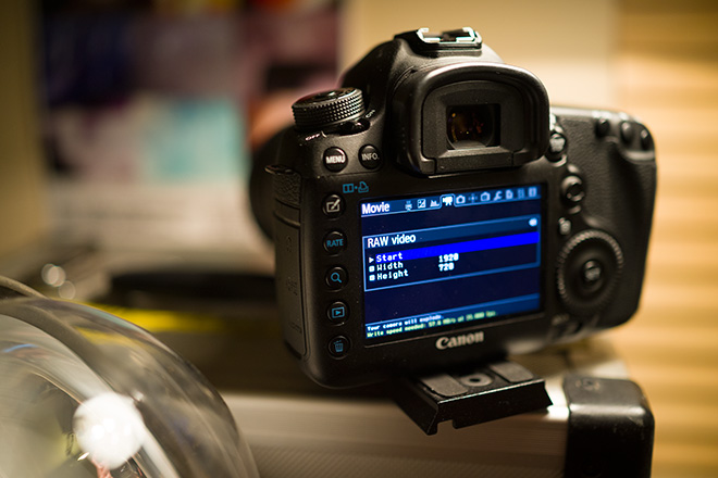

Administrators Andrew Reid Posted May 16, 2013 Administrators Share Posted May 16, 2013 UPDATE: Full book now available - The EOSHD 5D Mark III Raw Shooter's Guide Here's a quick and easy way to get raw recording setup on your 5D Mark III thanks to the recent Magic Lantern developments. [url=http://www.eoshd.com/content/10352/easier-5d-mark-iii-raw-guide-in-4-steps]Read the full article here[/url] tomekk, OffewMapype and Julian 3 Link to comment Share on other sites More sharing options...
