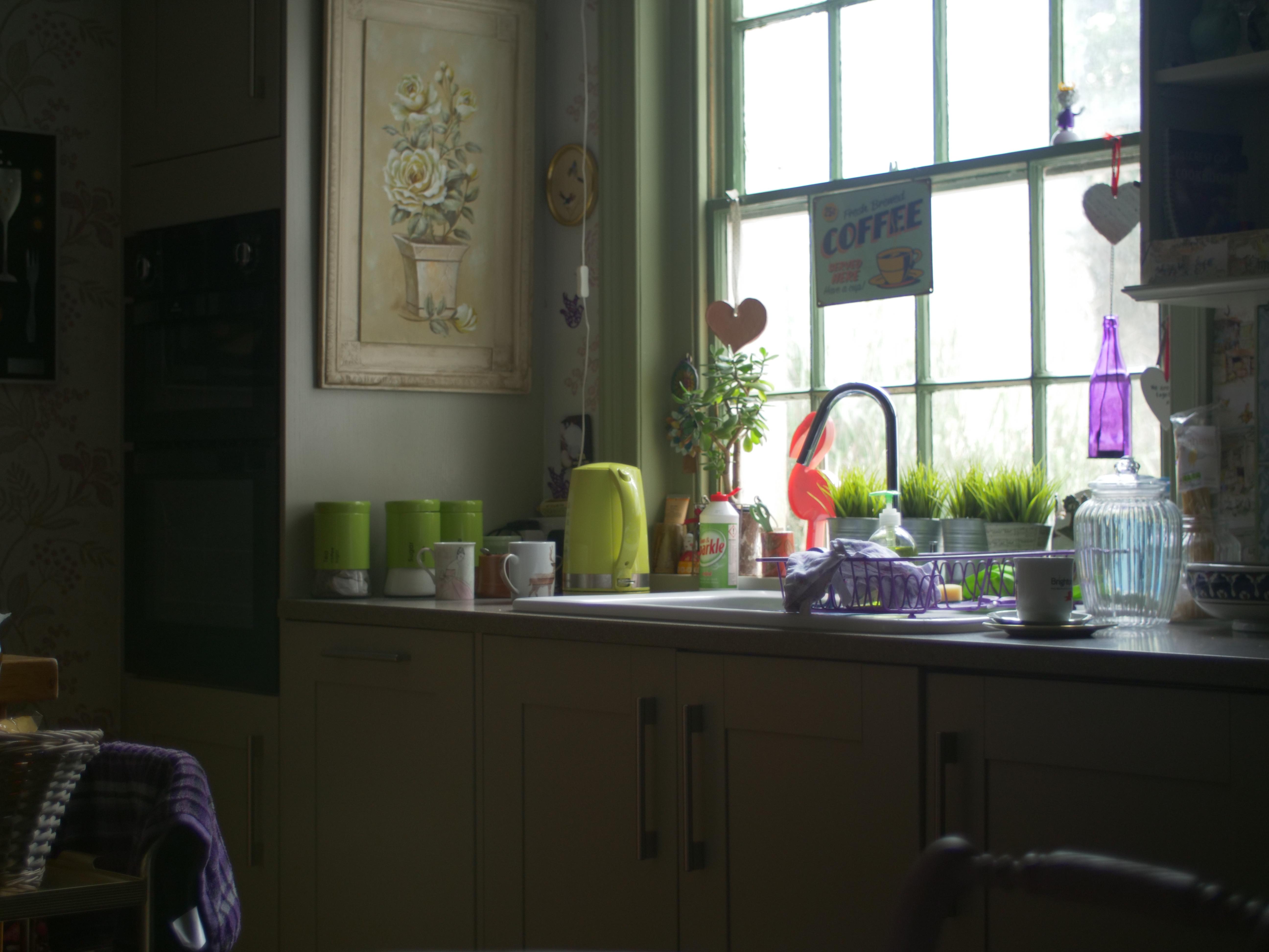

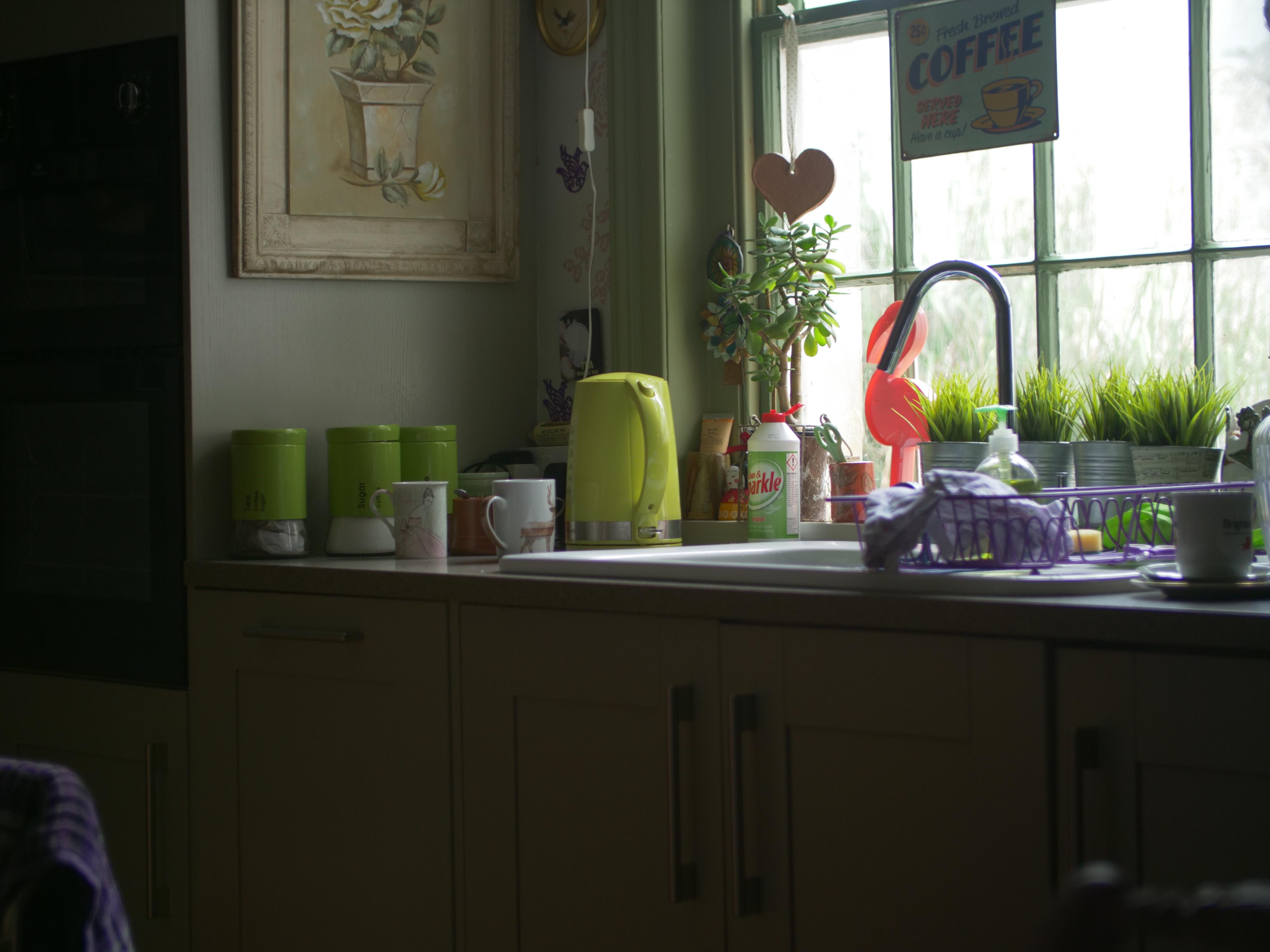

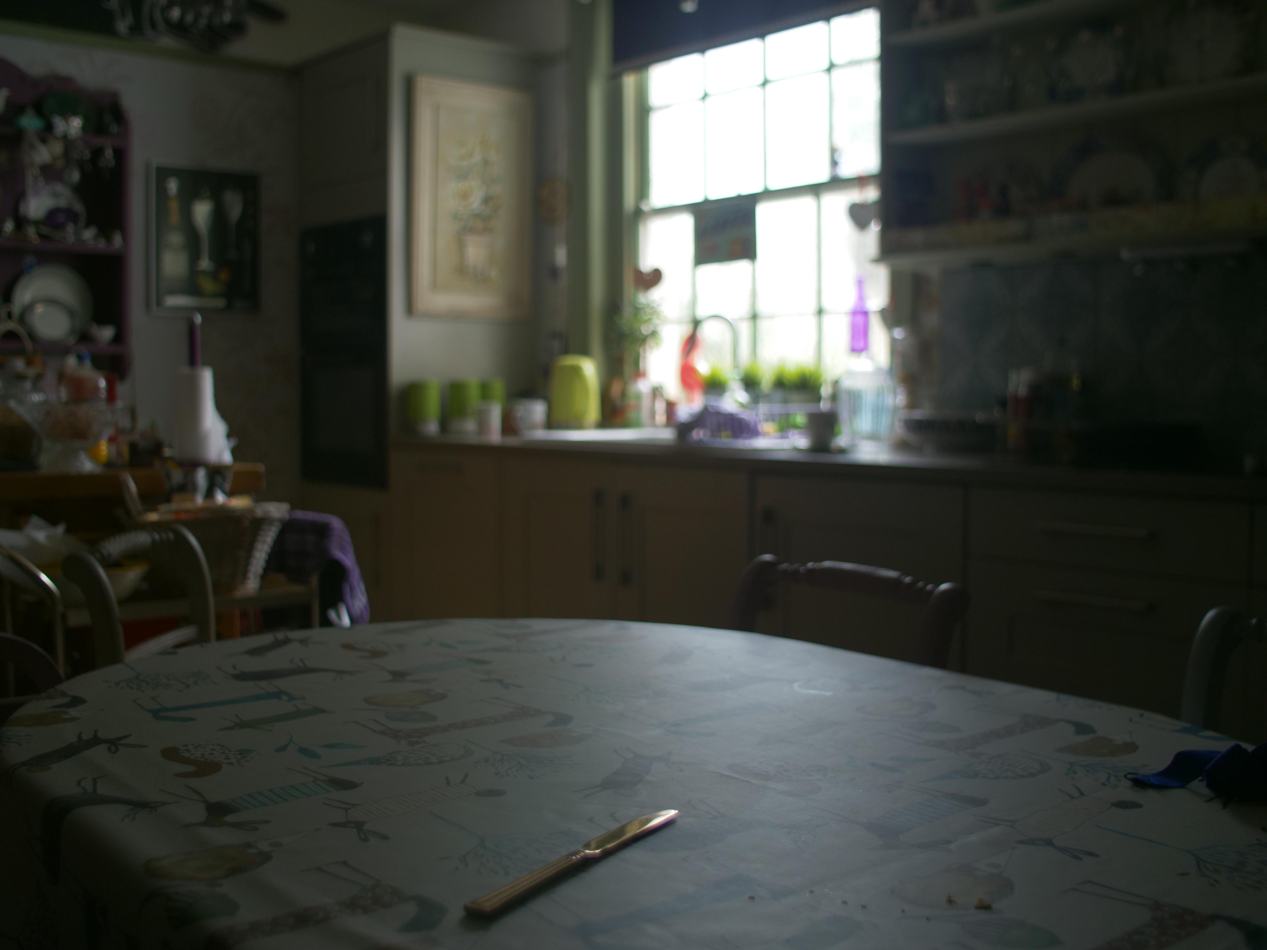

JordanWright Posted June 7, 2018 Share Posted June 7, 2018 So I ordered a Tokina 28-70mm 2.6-2.8 EF from eBay but after testing it, it seems that it doesn't reach anywhere close to infinity focus on the wide end. does anyone know of a fix to this or will I have to return? Im using a GH5 with a Speedbooster XL. Here is a comparison between 28mm, 50mm and 70mm focusing on the kettle/ infinity. Link to comment Share on other sites More sharing options...

anonim Posted June 7, 2018 Share Posted June 7, 2018 Maybe to try first with some dumb adapter? Try also behavior in regarding to f value... I'd rather say that problem is with lens. JordanWright 1 Link to comment Share on other sites More sharing options...
JordanWright Posted June 8, 2018 Author Share Posted June 8, 2018 Update: I removed the optical block from the speedbooster and the issue remains which leads me to believe that it is in fact an issue with the lens itself. Link to comment Share on other sites More sharing options...

Shirozina Posted June 8, 2018 Share Posted June 8, 2018 On 6/8/2018 at 9:14 AM, JordanWright said: Update: I removed the optical block from the speedbooster and the issue remains which leads me to believe that it is in fact an issue with the lens itself. Expand That won't work as the adaptor body is not the same thickness as the non speedbooster adapter. With speedboosters the adjustment if you are short of infinity is to wind the optical group towards the sensor. PannySVHS, Geoff CB and JordanWright 2 1 Link to comment Share on other sites More sharing options...
