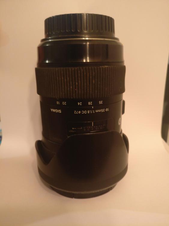

SR Posted June 11, 2018 Share Posted June 11, 2018 Have officially booked the camera. Hope you guys have too. I'm trying to start a dedicated thread just for lenses you'd be pairing the Blackmagic Pocket 4k with (please include video samples of the lens in action) I'm strongly considering the Tokina AT-X Pro 28-70mm f/2.6-2.8 AF (making it 40-100mm with the Viltrox EF-M2 0.71X). The breathing seems minimal and the image filmic, a good candidate for short films. Next is probably the Sigma 18-35mm 1.8. (25.5-50mm with the 0.71x adapter). This should have me covered for a lot of future commercial work, where sharpness might be paramount. JordanWright and Samin 2 Link to comment Share on other sites More sharing options...
