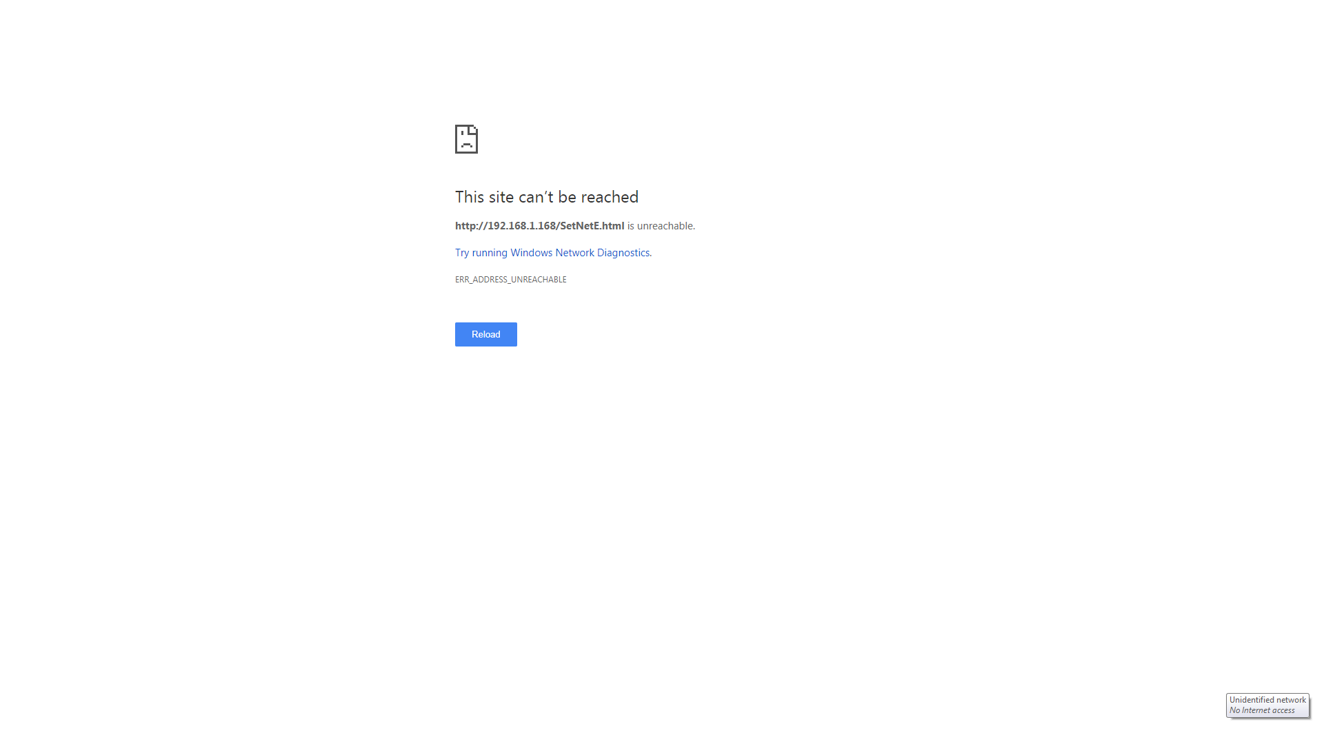

IronFilm Posted July 28, 2018 Share Posted July 28, 2018 Quote http://192.168.1.168/ is unreachable. Well this is annoying, and a reset doesn't fix this either. Link to comment Share on other sites More sharing options...
IronFilm Posted July 28, 2018 Share Posted July 28, 2018 Ok, now it is getting to be connected. But was very very very slow, unlike the first time I connected. Annnnnnndddd.... now I'm back to being unable to connect. Seeing as I can't see the user panel, I can't recall what the default WiFi password was either, was it 12345678 I think? Link to comment Share on other sites More sharing options...

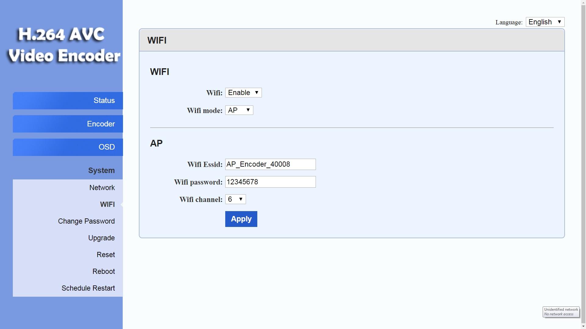

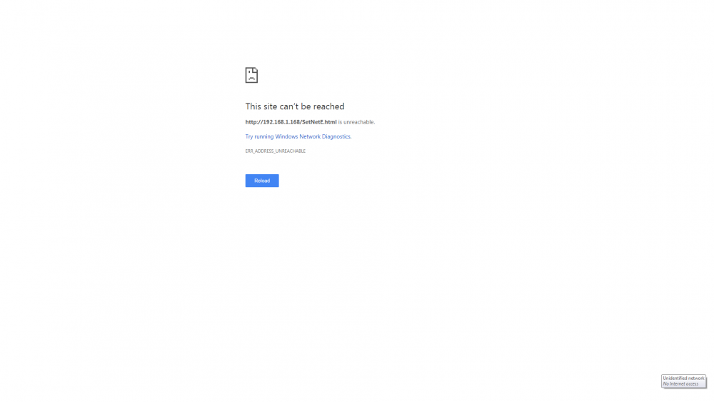

IronFilm Posted August 18, 2018 Share Posted August 18, 2018 Well, I managed to figure out the WiFi password, by not going first to the main screen but instead by going straight to the http://192.168.1.168/WifiSetE.html page directly (after starting again from scratch by removing the battery then plugging it back in again beforehand): I'm so pissed, the password is indeed "12345678" like I remembered! So why haven't I been able to connect to the WiFi network before? I just keep on getting told "Wrong Password". And of course, just like before, as soon as I try to then navigate on to the next page from here, then everything seems to crash and stop working: Link to comment Share on other sites More sharing options...
Super Members BTM_Pix Posted August 18, 2018 Author Super Members Share Posted August 18, 2018 1 hour ago, IronFilm said: Well, I managed to figure out the WiFi password, by not going first to the main screen but instead by going straight to the http://192.168.1.168/WifiSetE.html page directly (after starting again from scratch by removing the battery then plugging it back in again beforehand): I'm so pissed, the password is indeed "12345678" like I remembered! So why haven't I been able to connect to the WiFi network before? I just keep on getting told "Wrong Password". And of course, just like before, as soon as I try to then navigate on to the next page from here, then everything seems to crash and stop working: Try this ip address from my original post as it might be up to the same game _________ Its a bit clunky getting it going as the documentation wasn’t exactly readily available so I wasted a lot of time being unable to connect to it as an access point because the router address it uses when wireless is entirely different (and undocumented) to what it is when you are using the LAN port or it is in bridge mode.( Its 192.168.8.8 by the way ) ______________ Link to comment Share on other sites More sharing options...
