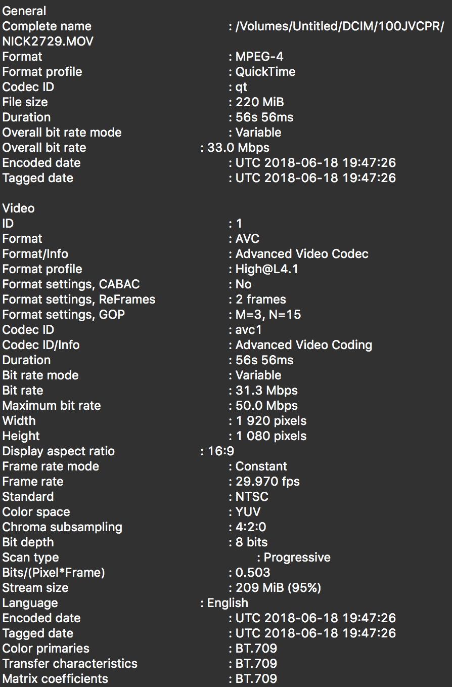

Anaconda_ Posted June 18, 2018 Share Posted June 18, 2018 Ah so its 50mb over 120 frames, but those 120 frames take 4 seconds to play? That's interesting. Similar to you, I recorded about 3 clips in 120 when I first got the camera and said 'meh' out loud and never did it again. EDIT: I just did a quick test, and here's all the various info for a 120fps recording. Seems low indeed. . Link to comment Share on other sites More sharing options...
David Andrade Posted June 18, 2018 Author Share Posted June 18, 2018 On 6/18/2018 at 6:41 PM, Anaconda_ said: Ah so its 50mb over 120 frames, but those 120 frames take 4 seconds to play? That's interesting. I'm going to do a super quick test of that now... Similarly, I recorded about 3 clips in 120 when I first got the camera and said 'meh' out loud and never did it again. I'll report back with my findings. Expand Please do! Thank you for doing so! Yeah, like I said, unless you can determine something else that makes sense, I think 120 to 60fps makes the most sense. Which doesnt get us super slow motion, but the hope is that slowing it down in the computer won't ruin it much worse than what was done in camera. I'll keep an eye out EDIT: Thanks for the update!! Hmmmm..... Link to comment Share on other sites More sharing options...
David Andrade Posted June 18, 2018 Author Share Posted June 18, 2018 On 6/18/2018 at 6:41 PM, Anaconda_ said: Ah so its 50mb over 120 frames, but those 120 frames take 4 seconds to play? That's interesting. Similar to you, I recorded about 3 clips in 120 when I first got the camera and said 'meh' out loud and never did it again. EDIT: I just did a quick test, and here's all the various info for a 120fps recording. Seems low indeed. . Expand Just for clarity, which option did you end up choosing? I just want to make sure we're all on the same page haha Link to comment Share on other sites More sharing options...
newfoundmass Posted June 18, 2018 Share Posted June 18, 2018 It's 50 mbps over 29.97 fps. The camera has a buffer, so before it compresses it and writes it to the card it is processed so that 120 fps is played in a 29.97 fps file at four times the length. That all happens before any compression occurs, so it's not really 120 fps @ 50 mbps. True 120 fps at 50 mbps would be way too little. On 6/18/2018 at 6:41 PM, Anaconda_ said: I just did a quick test, and here's all the various info for a 120fps recording. Seems low indeed. . Expand This is actually reasonable; variable bit rate only uses the max bit rate when it needs to. Because your clip likely has very little motion and movement, it didn't need to use all 50 mbps for it all to achieve the best quality and could do so instead at an average of 33 mbps, saving you space on your card. Link to comment Share on other sites More sharing options...

Anaconda_ Posted June 20, 2018 Share Posted June 20, 2018 On 6/18/2018 at 6:56 PM, David Andrade said: Just for clarity, which option did you end up choosing? I just want to make sure we're all on the same page haha Expand Sorry, I missed this. My sample above was 120/60p 50M. On 6/19/2018 at 12:17 PM, David Andrade said: But an entirely different form factor, smaller sensor and no VSM. Add the XLR interface on the GH5 and the prices are basically the same. Expand Form factor and XLRs are basically why I chose the LS300, I upgraded from a Canon XF100, so to me it was the same size and shape, but with a much better sensor and many more lens options. Link to comment Share on other sites More sharing options...
David Andrade Posted June 20, 2018 Author Share Posted June 20, 2018 On 6/20/2018 at 11:11 AM, Anaconda_ said: Sorry, I missed this. My sample above was 120/60p 50M. Form factor and XLRs are basically why I chose the LS300, I upgraded from a Canon XF100, so to me it was the same size and shape, but with a much better sensor and many more lens options. Expand Thank you! And yeah, that makes sense. I would have done the same. 31.3mbps isn't that bad. And I am sure if whatever you filmed had more action, the bit rate would go up from there. I think I've justified this camera enough to myself to go out and purchase one now haha webrunner5 1 Link to comment Share on other sites More sharing options...

newfoundmass Posted June 20, 2018 Share Posted June 20, 2018 On 6/19/2018 at 12:46 PM, David Andrade said: newfoundmass, my head is still sort of spinning from this. I understand after referencing that screenshot what you're saying, at first. It's the last sentence that loses me. So, as we said before, it's compressing the 120fps into 30fps in camera - which is what you're referring to? And this is actually great news, right? As you said, if we had straight 120fps, the bitrate would (potentially) be much lower. Expand Conformed might be a better word than compress, but yes. IronFilm 1 Link to comment Share on other sites More sharing options...
