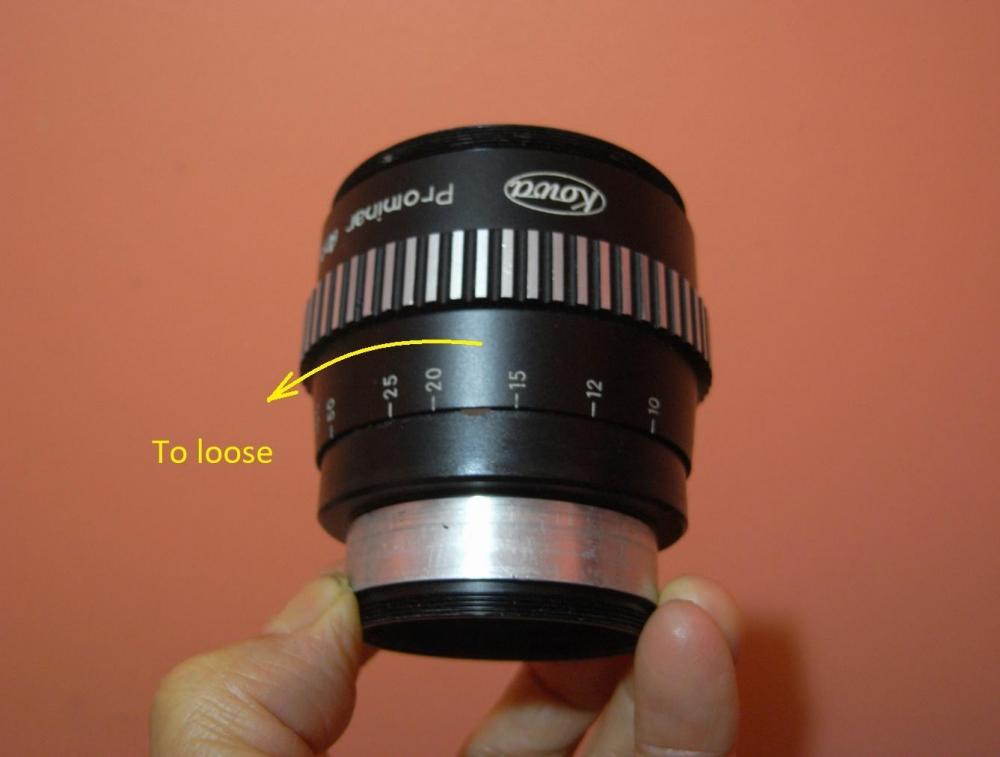

ken Posted June 24, 2018 Share Posted June 24, 2018 8 hours ago, Bozzie said: Hi All, Anyone have any experience with stripping down a Kowa 8z Anamorphic adapter? I've stripped down a couple of other scopes before but this one's giving me a bit of bother. The pics below are as far as I've got. Repair Issue: I want to access the screws (highlighted in red) but the focus barrel (helicoid?) is jammed - Won't rotate in either direction. Anyone experienced this before? If so, how did you release/fix it? I'm sure I'm missing something. @Tito Ferradans Maybe you might have some advice? Thanks in advance! -- B Hey, your lens has been modified. I believe it has reached to one end. Please refer my picture. BTW, if you need, I can sell mine to you, mechanic parts only, no glasses. ? Link to comment Share on other sites More sharing options...

ken Posted June 25, 2018 Share Posted June 25, 2018 8 hours ago, Bozzie said: Thank you. Seen that vid before. The issue I have is that I'm unable to access the screws due to the focus barrel being stuck. Need to figure out a way of loosing it without breaking the damn thing! ? Hey @ken. Thanks for the pic! Modified? Please explain. How much are you wanting for that bad boy? ? Your lens barrel has been cut out the distance marking part, obviously. Mine's price? I think it worth around $200 nowadays. Its front lens was too bad when I bought, not usable. So I took out rear lens for use with other front lens. Bozzie 1 Link to comment Share on other sites More sharing options...

Bozzie Posted June 26, 2018 Author Share Posted June 26, 2018 17 hours ago, ken said: Your lens barrel has been cut out the distance marking part, obviously It's not been cut. I removed the distance marker ring to access the screws ? 17 hours ago, ken said: I think it worth around $200 nowadays I'll keep that in mind! 5 hours ago, Grimor said: Did you remove the front look ring first? 3 little screws beside is writted "kowa prominar made in japan" It'll allow you to rotate the focus barrel in the desired direction. All removed. The focus barrel was ceased. I say "was" as it's now been resolved! Just about to post an update ? Grimor 1 Link to comment Share on other sites More sharing options...
