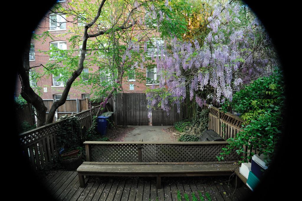

Super Members BTM_Pix Posted July 10, 2018 Super Members Share Posted July 10, 2018 This is it on a full frame camera (D700) You could probably simulate it with a crop in photoshop with the right dimensions of the XL to check. Link to comment Share on other sites More sharing options...
Super Members BTM_Pix Posted July 10, 2018 Super Members Share Posted July 10, 2018 I think my sums are right so this is what it would look like on an XL, so, yes, it would run out of road in the corners. Verus a 0.7 Speedbooster which would be OK. Which, admittedly, isn't much of a help if you've got the XL Stab 1 Link to comment Share on other sites More sharing options...

Super Members BTM_Pix Posted July 10, 2018 Super Members Share Posted July 10, 2018 For completeness, the same sums cropping an image of the Sigma 18-35mm on an XL There is still a small amount of vignette but reduced from the Nikon Link to comment Share on other sites More sharing options...

Stab Posted July 10, 2018 Author Share Posted July 10, 2018 2 hours ago, BTM_Pix said: I think my sums are right so this is what it would look like on an XL, so, yes, it would run out of road in the corners. Verus a 0.7 Speedbooster which would be OK. Which, admittedly, isn't much of a help if you've got the XL Thanks mister! Very helpful. Which crop factor of the GH5-S did u use to begin with? I think the GH5-S has a slightly bigger sensor than the GH5 in 16:9 mode. Link to comment Share on other sites More sharing options...
Super Members BTM_Pix Posted July 10, 2018 Super Members Share Posted July 10, 2018 I used 2x because I never read the initial post carefully enough and thought it was the regular GH5 ? I think it's 1.85 on the GH5S ? Those are all 3:2 aspect ratio as they're from stills cameras so take that crop into account as well. I'm not near a computer to do it but if you use those original source files from each post you can do it from scratch to confirm. I suppose the story is that it will give you less margin than the 18-35 and if that is already vignetting any on your XL then you'll have a problem. Link to comment Share on other sites More sharing options...

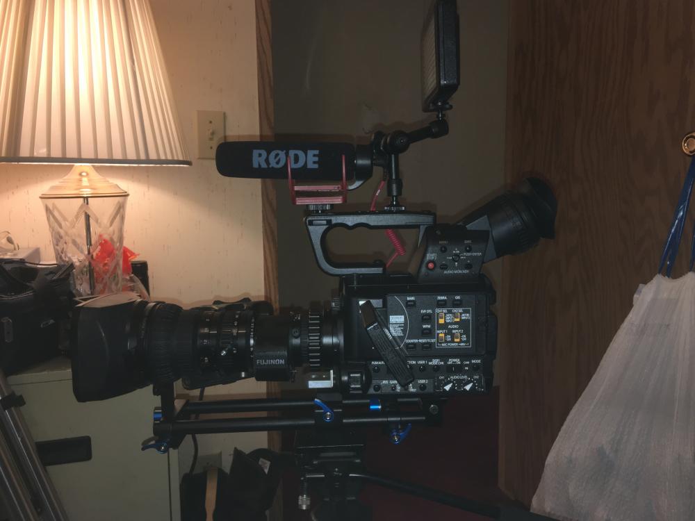

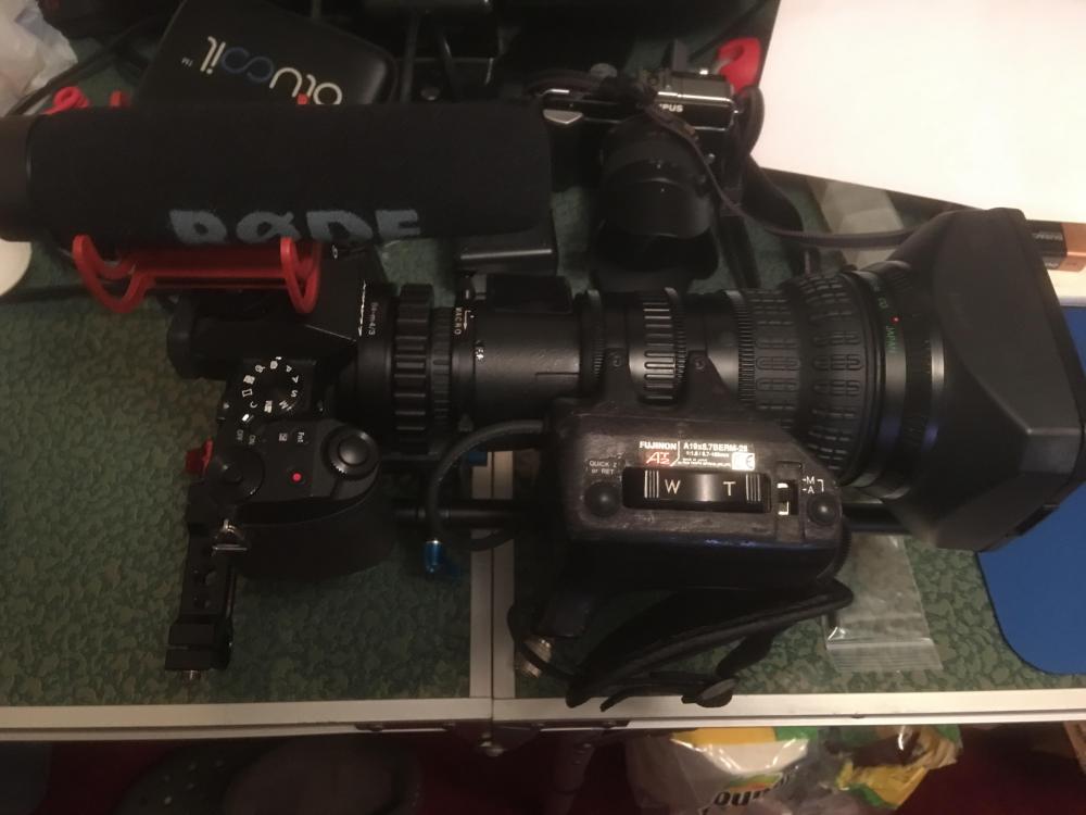

webrunner5 Posted July 10, 2018 Share Posted July 10, 2018 Here is the first time I ever tried one, a Fujinon 19X f 1.7 with the 2x extender on my Panasonic AF100A. Picture of rig above. Had a 50 dollar B4 to m4/3 adapter on it. They can be incredible sharpness wise. I paid 150 bucks for it because the zoom motor was burned out from Adorama. Pretty common on them. There is a switch where you can disable the power zoom so works by hand easy. If you can find one like the picture below that says AT2 that is a newer version of the lens. It is HD. I had no problem even in 4K on my G7 with that lens. This is Fuji description of AT2 lens. So as you can see they are pretty damn good even for HD and better. "AT2 Aspheric Technology Many of Fujinon's HDTV and broadcast lenses feature Fujinon's AT2, which combines the company's exclusive Aspheric Technology with a new inner focusing system to greatly improve lens performance over conventional designs." I can also say the Panasonic AF100 is a hell of a great camera for as low as 600 dollars. Amazing output using a native m4/3 mount, decent AFS AF also. Tons of knobs, buttons. A true Cine Camera for peanuts. Great learning tool. newfoundmass 1 Link to comment Share on other sites More sharing options...
