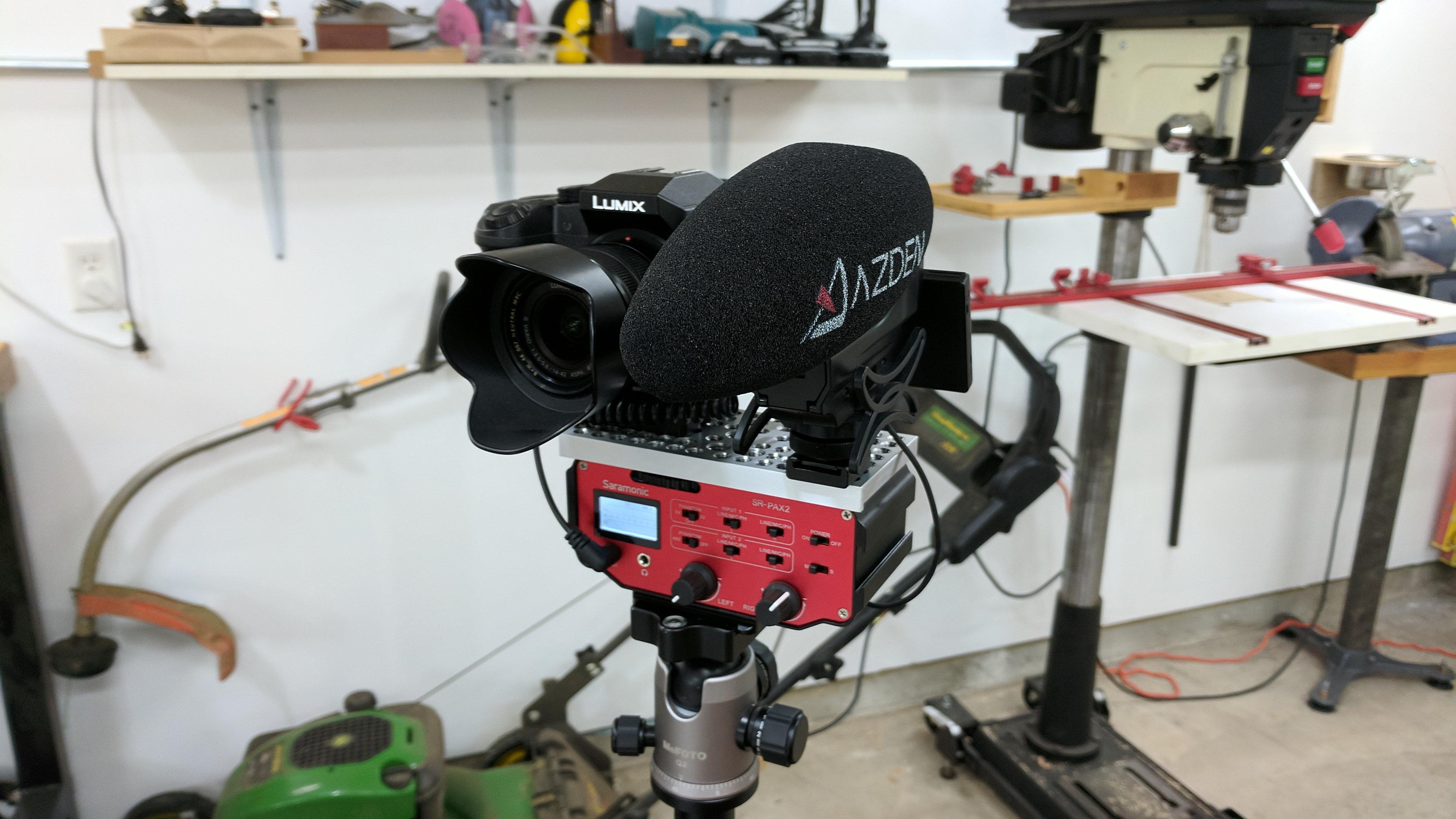

Dan Sherman Posted July 31, 2018 Author Share Posted July 31, 2018 3 hours ago, IronFilm said: How are you using your F4? Are you using it as a sound recordist in a bag? I'll be using it in a custom camera rig like this one I made for my old pre-amp. I was thinking a v-lock sysyem would give me the abillity to not only power the f4 but also the camera and a monitor. Link to comment Share on other sites More sharing options...
IronFilm Posted July 31, 2018 Share Posted July 31, 2018 1 hour ago, Dan Sherman said: I was thinking a v-lock sysyem would give me the abillity to not only power the f4 but also the camera and a monitor. Fair enough. Although by this in point it is going to be getting VERY bulky for the whole set up! You'll be making my Sony PMW-F3 look like a slim and compact set up. Link to comment Share on other sites More sharing options...
Dan Sherman Posted July 31, 2018 Author Share Posted July 31, 2018 9 hours ago, IronFilm said: Fair enough. Although by this in point it is going to be getting VERY bulky for the whole set up! You'll be making my Sony PMW-F3 look like a slim and compact set up. This would only be used like a studio rig mounted on a tripod so not much of an issue. In other circumstances various comments would be stripped off. Link to comment Share on other sites More sharing options...
