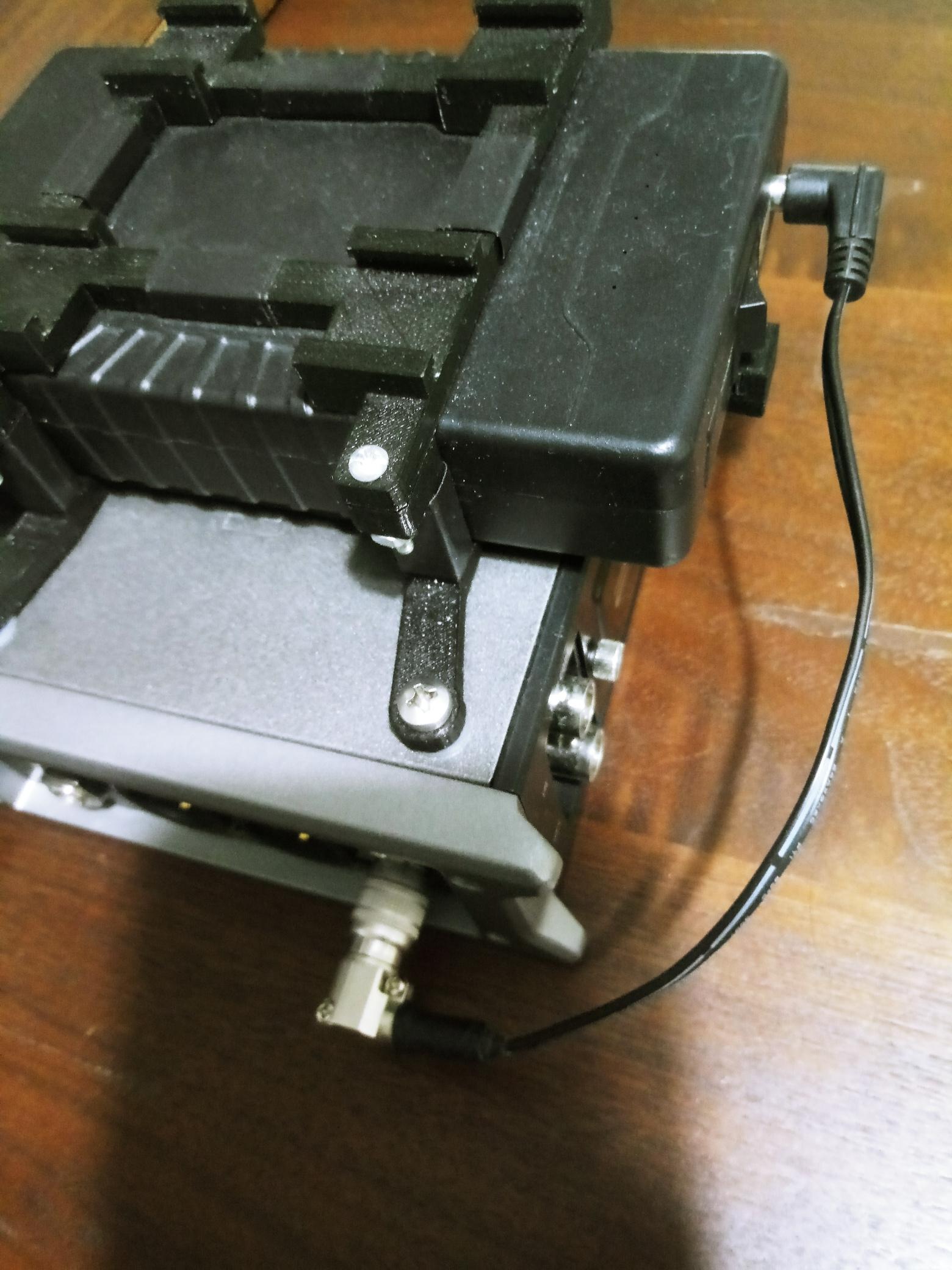

KnightsFan Posted July 3, 2019 Share Posted July 3, 2019 @Dave Tholen I was the original person to suggest Talentcell, and I use a couple for both audio and camera. Over the past year or so since I got them, I have found them to be very reliable and last for several days of shooting. The one I use on my F4 has a 2.1mm x 5.5mm plug, though there is also a larger battery that has a 2.5mm x 5.5mm plug on its 9v output. Talentcell batteries are 12.6 volts, not 12, though it drops over time since it's unregulated. For my F4, I got a right angle 4-pin hirose connector (https://www.bhphotovideo.com/c/product/1355760-REG/cable_techniques_ct_hrs4_r_4_pin_male_right_angle.html?ap=y&gclid=EAIaIQobChMI4s32tYOZ4wIVnIqzCh3pEgj7EAkYASABEgJuQfD_BwE&lsft=BI%3A514&smp=y) and made a short DC to hirose cable. The DHC-1 adapter was bulky, and the straight connector makes it hard to store in a bag, compared to the right angle connector. The battery itself is attached via a 3D printed bracket with some cold shoe mounts for lav receivers. HOWEVER... recently I have got strange electrical noises in some recordings. It's very rare. I use my F4 at least every other day on average, and the only times I have heard it were a couple days on a shoot last May. I can't reproduce it--yet. I suspect that it has something to do with the power supply. It could be that the battery isn't reliable. If so, that could be from someone dropping the battery on concrete a year ago. It could be a problem with my cable soldering. It could even be something wrong with the F4 itself. Despite that, I think the talentcell is a reliable battery. But now that I've written this I'll put some effort into actually figuring out what is making that noise, and report back if I find anything. Link to comment Share on other sites More sharing options...
