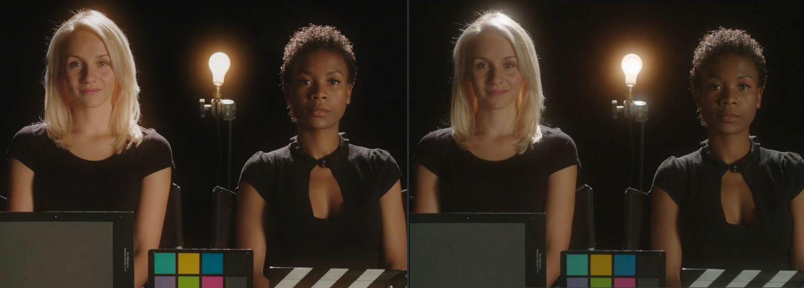

kye Posted July 22, 2018 Share Posted July 22, 2018 I quite like the look of the Tiffen Black Pro Mist filter, and thought that I could simulate the effect in Resolve. (This conversation started in another thread but I think it deserves its own) My theory was that if you can simulate it in post then it's more flexible, so you can mix it in to taste, and its also cheaper, applies to all your lenses, can be applied to historic footage, etc.. Here's the video showing what these filters do thanks to @heart0less I've had an attempt and I'm now convinced that a completely accurate simulation is not possible. To explain why, here's an unmodified screen grab: and here's the waveform of that shot: Here are the reasons you can't do a completely accurate emulation: The Tiffen doesn't "clip". The flare from the light globe is much brighter than the flare from the hair light on the blond lady, but in the "no filter" waveform you will note that these have very similar values because the globe is clipped. Also, the flare from the globe is coloured, which presumably is from the tint of the globe, however because the waveform is clipped that colour information is lost. The Tiffen has a very wide flare pattern and will include lights outside the field of view. There don't appear to be any flares from off-camera lights in the above shot, however we can tell that the Tiffen has a very wide pattern because the level of the dark background is raised for almost the entire width of the frame but the exposure seems to be the same (by comparing the levels of the grey cards at the left of the shot). If you are using this filter and it is being hit with sunlight from any angle I think you'll get the influence of that everywhere in the shot, because although it might be very off-angle the sun is practically an infinitely bright light. However, I think we can probably make a passable attempt that might work in some situations. Here's the original of lady #1: and my simulation: Lady #2: Same simulation as above applied to lady #2: The logic of this preset is this: The Tiffen has a non-linear rolloff, so I have simulated it using blurs of two different sizes, one smaller size applied to the Highlights and a larger one applied to the Mids and Shadows. If I really wanted to get serious about it I might try converting to a Log colour space and doing the blur in there before converting back to REC709, but that's something for another day. I think that preset looks pretty good for both of these shots, but unfortunately, if we apply that preset to the main shot then we see that it definitely isn't suitable for all shots: If I play with the levels and add a third blur that is highlights only and is even smaller radius then we get a better result, but it highlights the issues I mentioned earlier: If you're going to try and use this effect in post then I would suggest a number of things: Shoot in Log and don't clip any highlights from any colour channel If you move the camera don't have any lighting going in and out of the frame (because the effect will start and stop when it does which will look very un-natural) Experiment with applying the effect before you convert from log to any other colour space (after all, a Tiffen filter gets applied before the conversion) Experiment with different blur types - I used Gaussian Blur in the above, but maybe other types will look nicer? The Mids and Shadows processing chain is the kind of "beauty" element, and the Highlights processing chain is the "flares" element, so you can mix these to your taste I hope that is useful, and that Tiffen don't object to me using clips from their video!! jonpais, heart0less, salim and 4 others 3 4 Link to comment Share on other sites More sharing options...

heart0less Posted July 22, 2018 Share Posted July 22, 2018 @kye - I really dig all the work and explanation you put into it. I, too tried to mimic the Pro Mist's effect, but took a different approach and relied mostly on Resolve's Glow effect. Here are my results: Black Pro Mist 1/8 - https://imgur.com/a/Hz1lRPe Black Pro Mist 1/4 - https://imgur.com/a/z36OnC5 What really bugs me is the fact that really hot colors will glow, as well, since everything is based on thresholds.. https://imgur.com/a/x9gN59x Link to comment Share on other sites More sharing options...

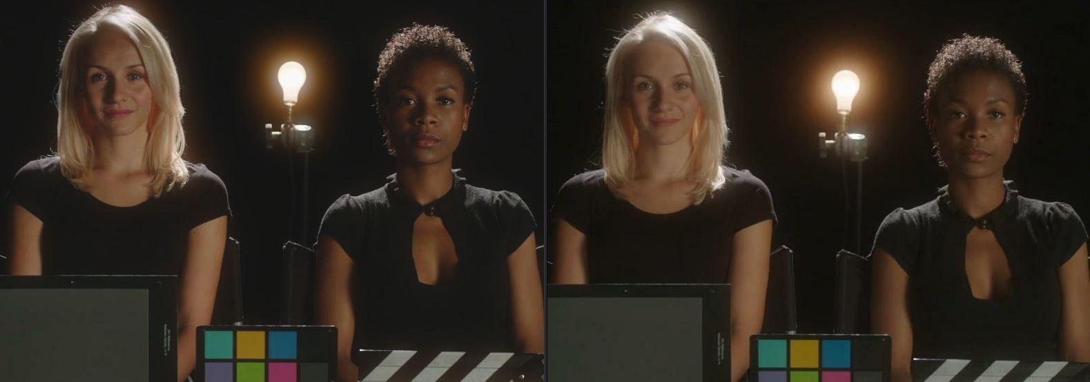

no_connection Posted July 22, 2018 Share Posted July 22, 2018 Kinda hard to get anywhere close. Think the bulb clipping throws it off a bit. Link to comment Share on other sites More sharing options...
no_connection Posted July 22, 2018 Share Posted July 22, 2018 Round two I guess. Link to comment Share on other sites More sharing options...
