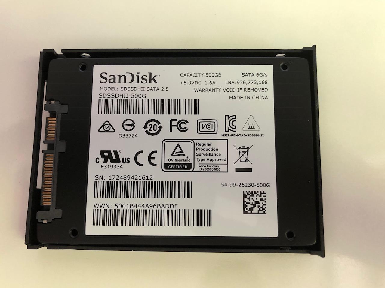

This is the SSD we used. The information in my first post wasn't correct about that.
