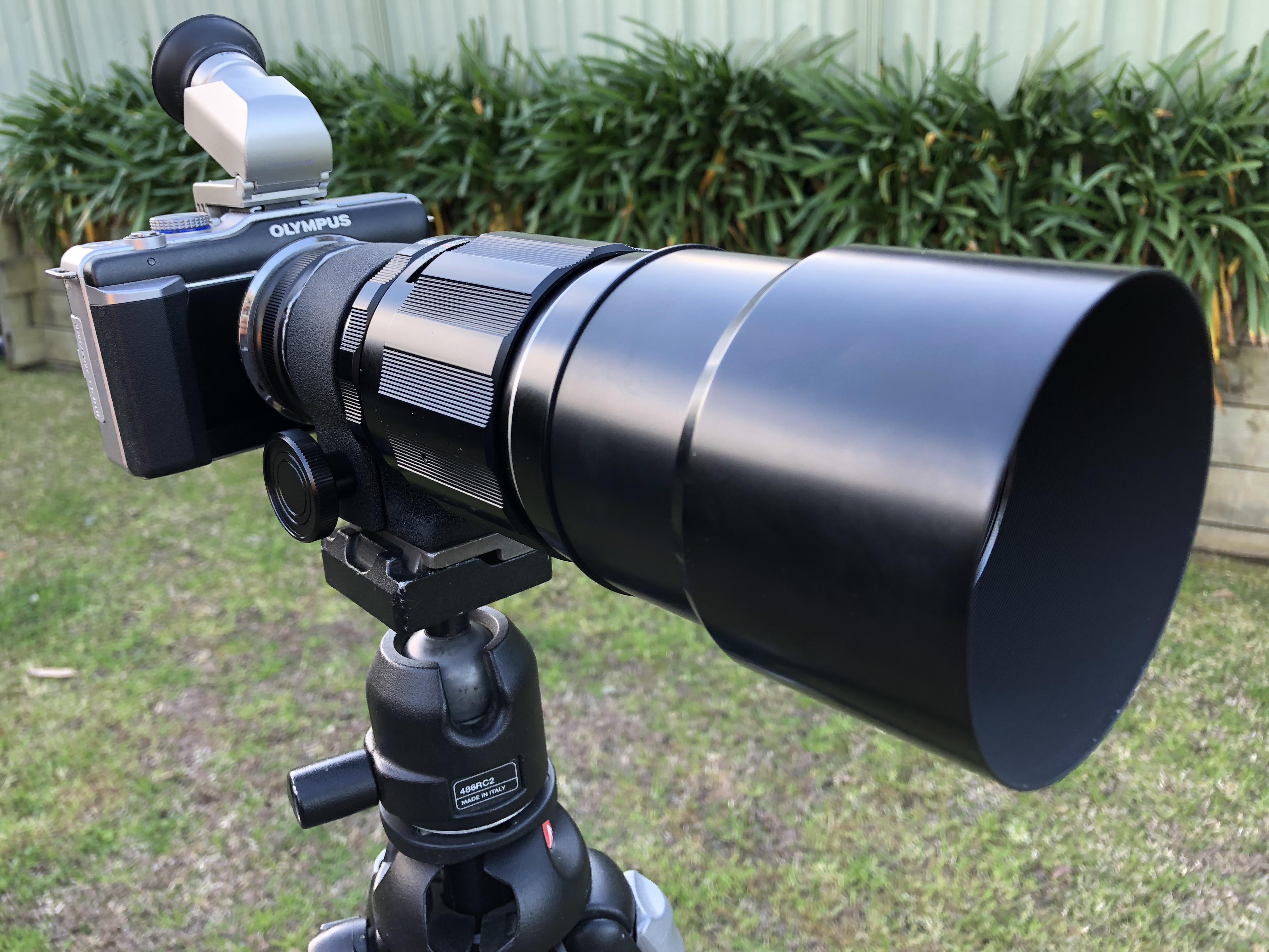

Just put together this in-expensive out fit for some surfing shots on the local surf beach's ,to test the water and see if it worked OK..
A very cheap EPL1 body, Pentax 42mm screw  300mm f4, elcheapo screw to M43 adapter, VF-2 View Module.
Gives me 600mm in equivalent view angle to 35mm.
No shortage of sun and good light  so easy to run low ISO'S with a decent shutter speed.
So the burning question !!!!! I'm happy to manual focus on a hefty tripod locked down,   B U T  -   I  want to change the body to an upgraded model with focus peaking  in a M43  mount for the generous magnification you get with 35mm based full frame  telephoto lens, yes the body will do both stills and capture video.
I've never done any work with the assist of focus peaking.
I'm open to any brand, so looking for recommendations for focus peaking abilities OR would you adapt a 5" monitor with focus peaking abilities.
Using the VF-2 was a challenge not the fastest refresh rate and stuttered a bit, so looking for a really clean view and accurate focus peaking..would be great...
Thanks for your in put....
