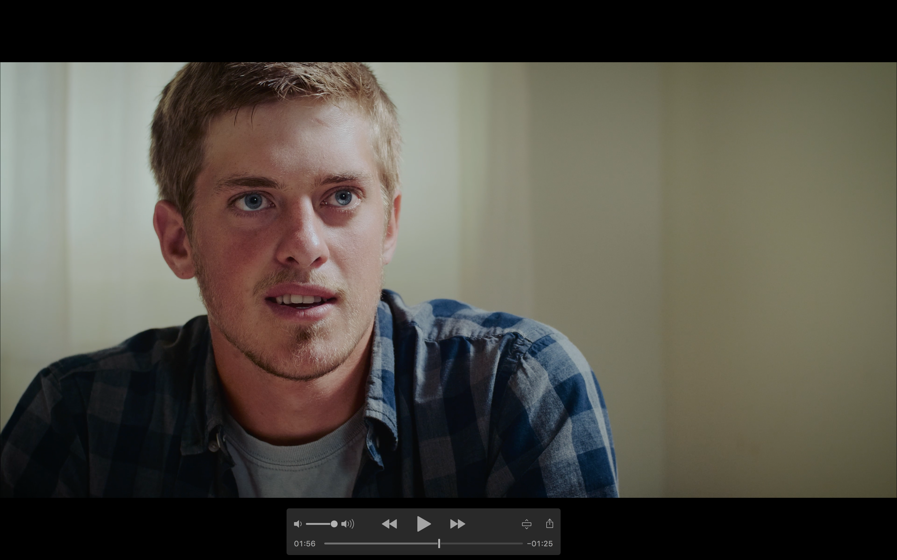

Mark Romero 2 Posted August 15, 2018 Share Posted August 15, 2018 1 minute ago, Deadcode said: This belongs to another thread. Yes, im using ACES and RCM side by side in post processing after shooting SLOG2. ACES gives me beautiful highlight roll-off as you can see on the attached image, RCM handles extreme color better without clipping. THANKS!!! Looks great. Link to comment Share on other sites More sharing options...
