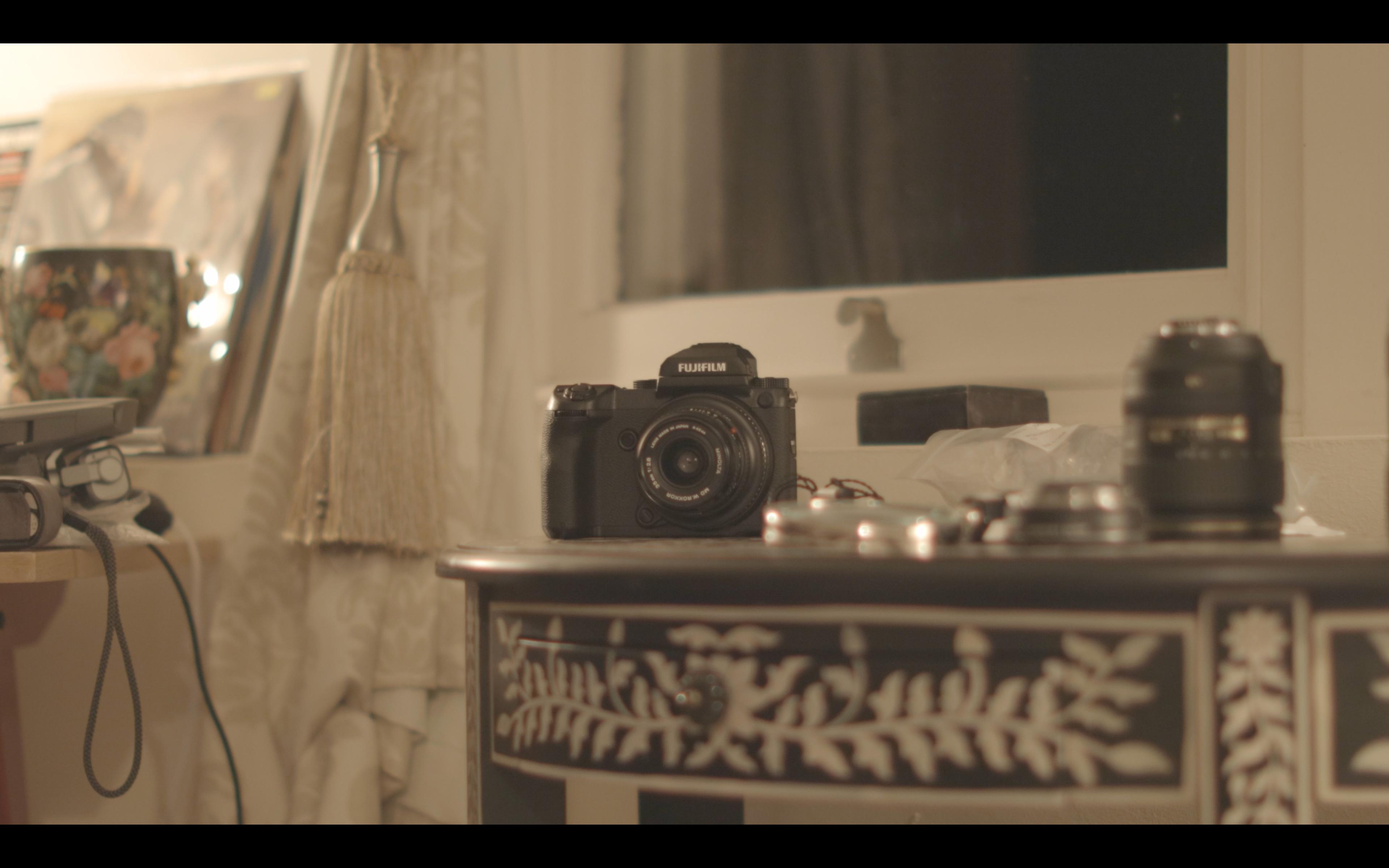

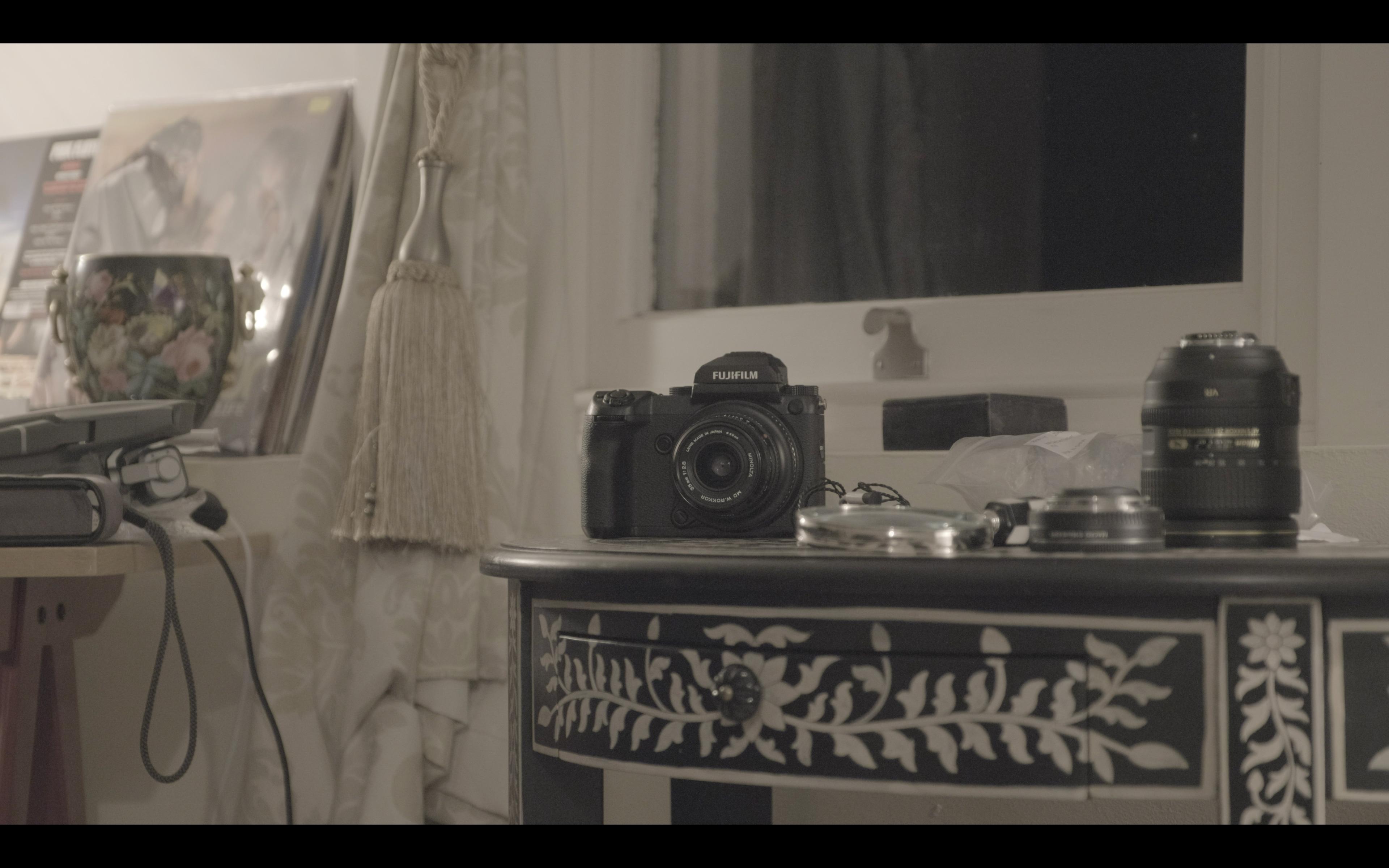

jonpais Posted October 15, 2018 Share Posted October 15, 2018 6 hours ago, Andrew Reid said: At ISO 1600, again surprising. Canon LOG on the EOS R is virtually noiseless, very smooth indeed, with abundant colour info. The X-H1 shot, same ISO, F-LOG, has more noise in the blacks and a harsher look overall. Why does Canon LOG keep so much colour info and the warmness of the light, whereas F-LOG washes it out? EOS R: Fuji X-H1: Not trolling, Andrew, but the Canon noise reduction appears to be smoothing out fine texture and detail and there's an unusual color fringing going on (green in the windowsill, red in the dresser) unless those are the actual colors - that is absent in the more detailed Fuji shot. May I ask what the WB was in this comparison? Are those graded samples? Because they both look rather underexposed for log. Noise can always be reduced in post, detail cannot be added. Link to comment Share on other sites More sharing options...
Super Members Mattias Burling Posted October 15, 2018 Super Members Share Posted October 15, 2018 My guess is the fringing is lens dependent. Some of my non L Canon glass fringe like crazy. It can definitely be a PITA sometimes. 6 hours ago, mercer said: Canon Log and Nikon Flat make no sense but always look great and are so easy to work with. True that. One thing that still gets me very exited about the R every time I think about it is, all this good stuff we are talking about + built in variable ND. That is going to be so freaking useful. I loved it on my Sony A7ii and NX1 with fotodiox but hated removing it every time I didn't wanted it or needed AF. Link to comment Share on other sites More sharing options...
jonpais Posted October 15, 2018 Share Posted October 15, 2018 3 minutes ago, Mattias Burling said: My guess is the fringing is lens dependent. Dome of my non L Canon glass fringe like crazy. It can definitely be a PITA sometimes. Thanks, Mattias, that was my guess as well. Link to comment Share on other sites More sharing options...
